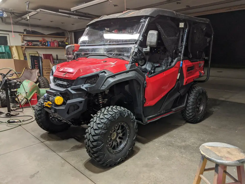

What dimensions did you use for the rear mesh panel. I like how you have it tucked into the tail gate.
Reactions: toddvdh
ToddACimer
ToddACimer
Pioneer 1005-2
Oct 7, 2016
3,812
16,232
Oshkosh, Wi
This is my order form from Covers and all. Keep on mind my roof is cut 3". Before I chopped the roof it did not tuck in the tailgate.

Thank you for the info! I'll double check the height and may have it made a little longer top to bottom.

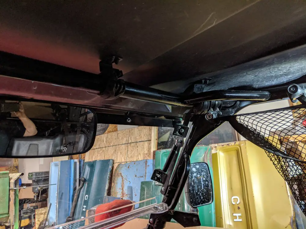

Hey Todd how did you end up cutting the windshield? Thinking of giving this a try b4 the TO 🤞
This may sound really dumb but... I used an acrylic knife and the edge of the SuperATV windshield mount as a guide. I marked and drilled my holes then ran the acrylic knife over the edge for what seemed like 1000 times. Basically the knife scores the material and you take the material off 1/64" at a time til you get through the whole thing. My knife looks like this. I cleaned up the edge with a 2" sanding disk and a heat gun. It was not thrilling or glamourous.
JenElio
JenElio
Oct 31, 2019
82,847
718,118
Loxahatchee, florida
Nice 👍
So you didn't have to mess with the notches on the sides of windshield?
ToddACimer
ToddACimer
Pioneer 1005-2
Oct 7, 2016
3,812
16,232
Oshkosh, Wi
Nice 👍
You will have to match the profile of the original upper shape to clear the inner windshield mounts. I put zip ties around my struts to only allow it to open to horizontal as well
