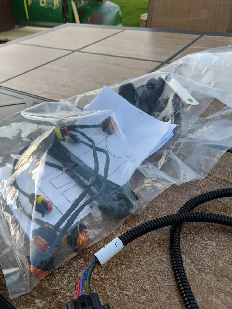

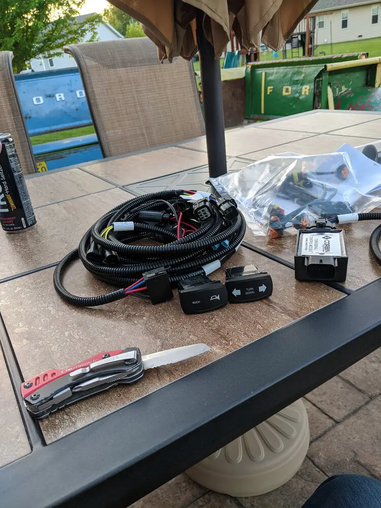

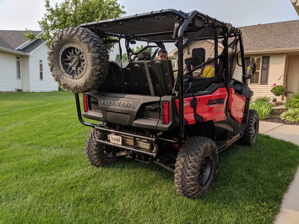

My next project has arrived. Corbin Custom works turn signal kit with horn. Build quality on this harness is damn near OEM. The signal module is potted really nice and the instructions look great. I'm not going to get to it til later this week but it should go on without an issue. Really impressed so far.

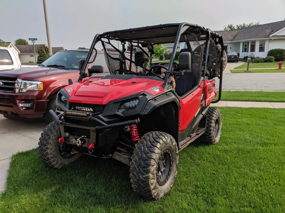

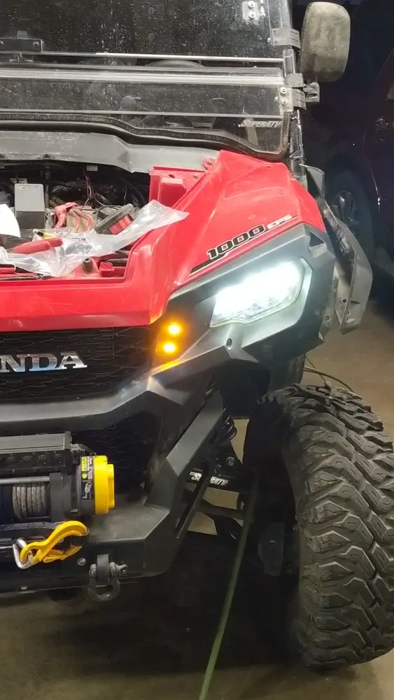

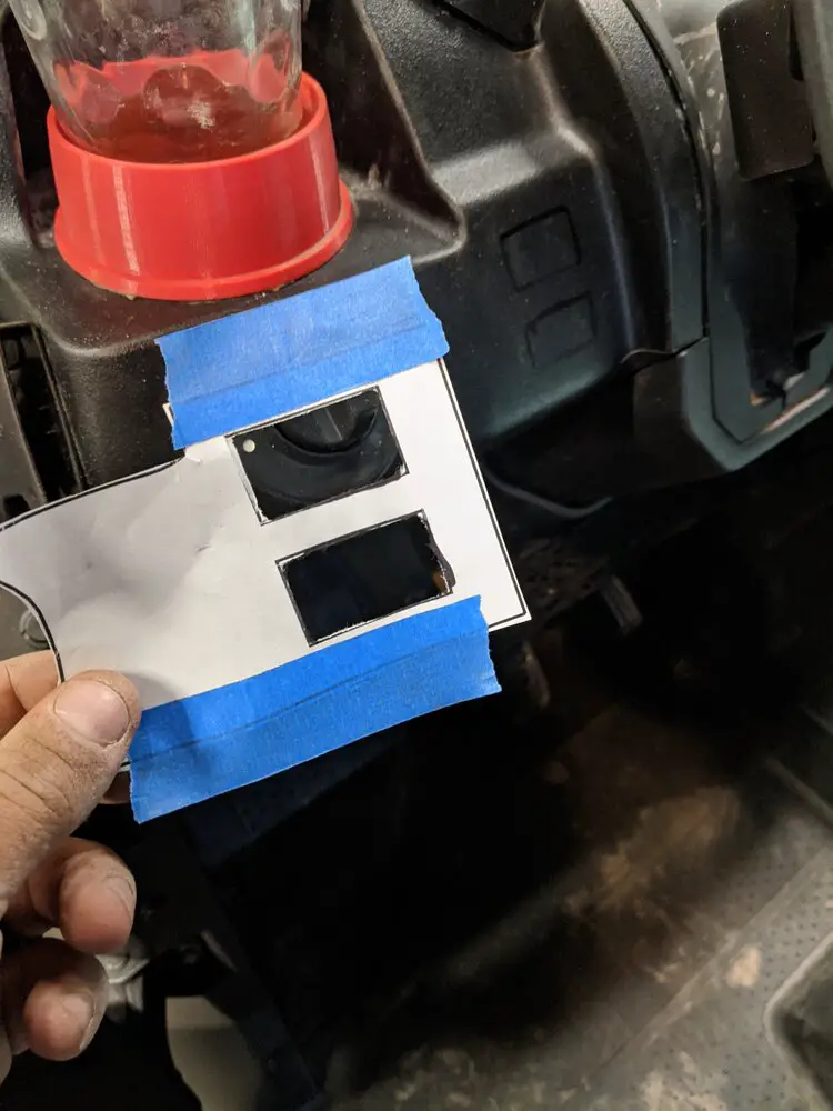

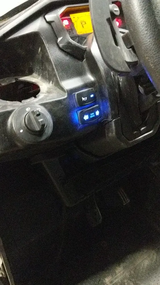

I'm really impressed with this kit. I relocated the front turn signals a bit from the directions but everything went together really well. Overall a great product. I really like the integrated rear signals in the OEM tail lights.

I'd like to get a signal kit... One less thing for the cops to complain about if I had working signals and used them. I'm a bit intimidated by the install. Did it require a lot of disassembly? Like plastic, etc

Left front fender flares had to come off to route the wires to the switches and that's it. Easy plug and play. Very good templates for light and switch holes. Easy to install in 2 hours or less.
