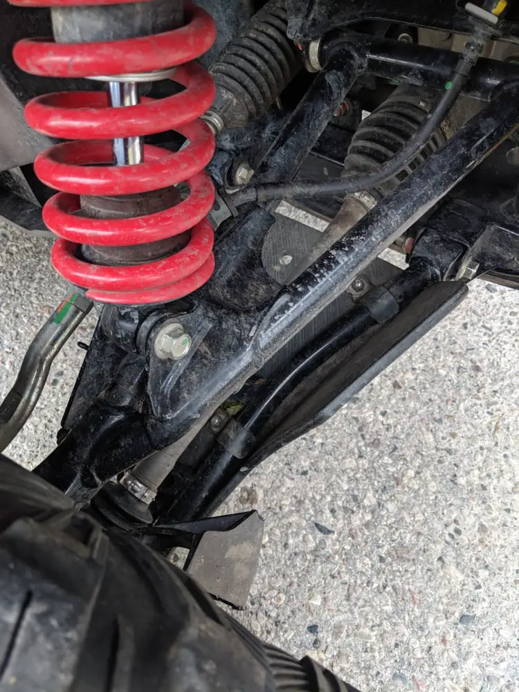

Starting on my 1200 mile service (1262)...
Whoops... Looks like we need some extra beef up in here. If somebody makes a crossmember that @Plumber32 and I cant smash in 500 miles, that would be 1 tough sum b****
So far my 1x3 box tubing is holding up well.

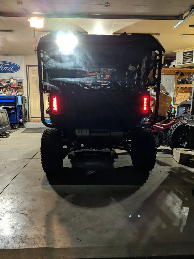

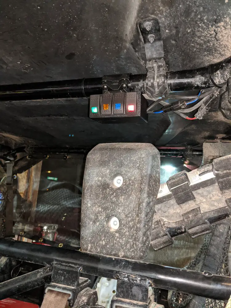

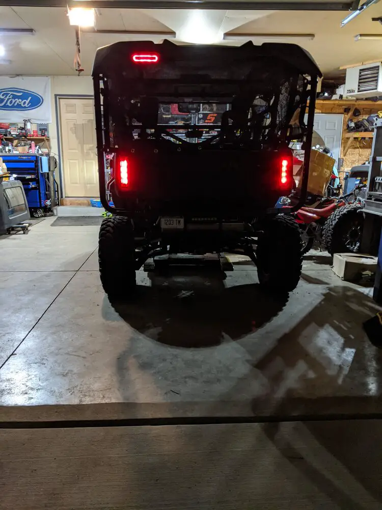

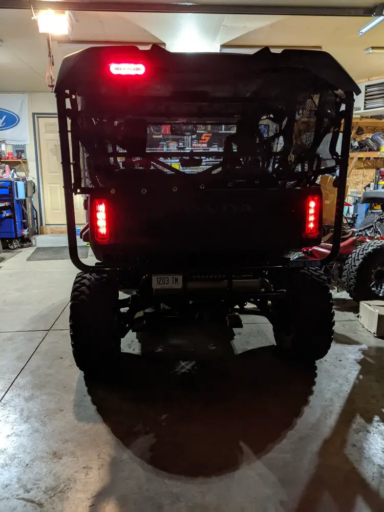

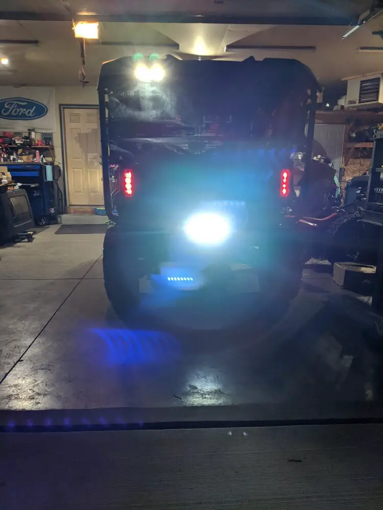

Chase light and overhead switches are installed.
The switch box is 3D printed from Crossroads 3d with 4 switches. The switches have high and low red, as well as reverse and strobe red.
IMG 20200630 004103
Reverse just the LED up top
IMG 20200630 003856
Top and bottom
IMG 20200630 003911
High red and low red
IMG 20200630 003817
IMG 20200630 003734
Strobe has a cool flash pattern. I'd guess high red will be the one we use most.
This is the light
This is the switch panel, enclosure and mount

I'd like to see chase video of the red strobe in a lot of dust for comparison. I had that same light in my cart before I found the small amber one I used; I like the way that one looks better than mine. I could only see @Hondasxs bright blue whips when we had 8 machines running fast through the dust and he was the lead vehicle while I was the caboose. I think anything mounted high will do the job just fine though.

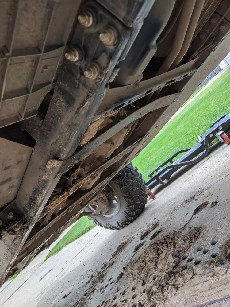

Looking to reject a bit more heat and making washing mud off this thing a bit easier. Bored all my skid plate holes from 1" to 1-3/8. Also added a few more ahead and behind the rear diff because mud and sand seems to pool in there.
IMG 20200705 143227
IMG 20200705 153731
With that task complete the 1200 mile service is done and she's ready to rip with all fresh fluids.

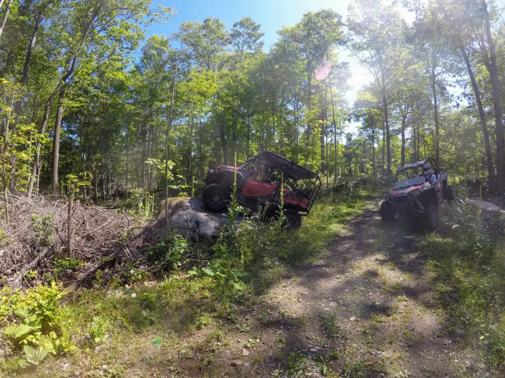

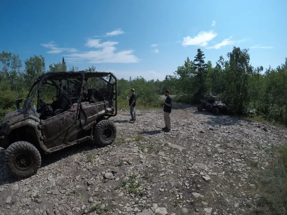

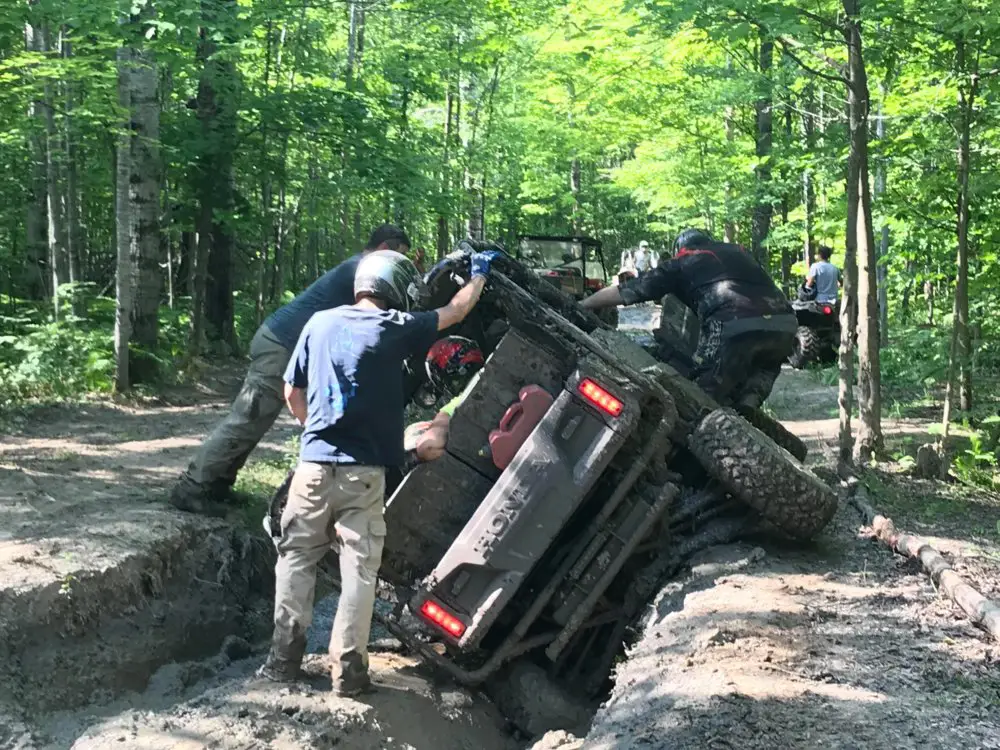

Well the last 200 miles were a blast. Spent the weekend on Drummond Island Mi. Lots of rocks, deep water, mud and quite a bit of off trail private property exploration. It comes at a price though.
I lost 3 wheel center caps, tore 2 CV boots, bent a tie rod, bent 2 a-arms, broke a net buckle. We wrecked a steering rack on an Arctic Cat wild cat and tore 2 a-arms off a RZR1000 too. Whoops
Couple photos from the weekend.
RZR carnage, we pulled the a-arm, hammered on it a bit and re-welded it but it still looked terrible
Pioneer carnageView attachment 144651
Quick tie rod repair
Little bit off camber here

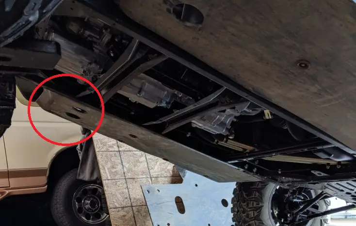

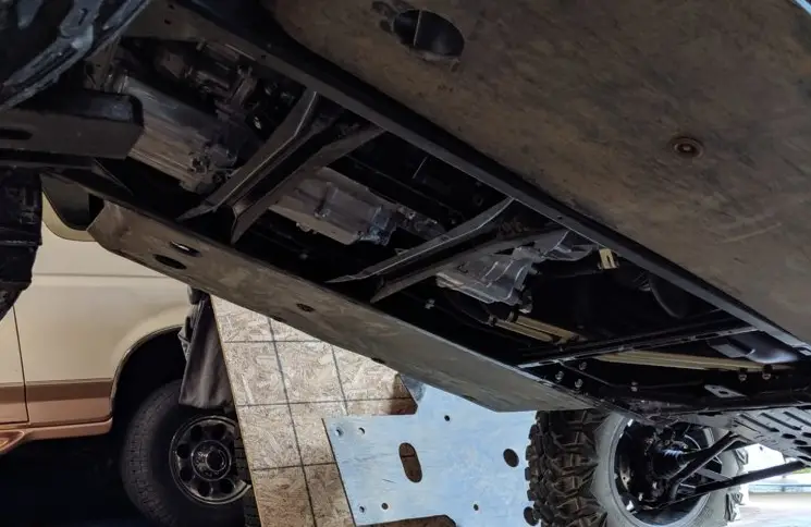

Do you have any supports for your outer rear skid plates? I am building a skid now, and was trying to decide how to mount the rear portion, or just cut it out? Thanks
1595942083636
1595941962322
3,793
16,081
I did not add a support back there other than the formed flange in the UHMW. I have not had a time where I felt like that part was unsupported. It does collect a lot of dirt and I've been tempted to cut it off.
32,051
If you end up bracing the outer tubes with 2" angle you can add a kicker up to the upper frame and toward the shock and one over to the lower frame for strength those tubes get bent up often.

I should mention that my outer rock slider tubes and inner tubes are gusseted with formed 3/16" tube gussets. Without the gussets the stock rock sliders are pretty easy to damage
The zip ties on the inner gusset were for clamp load while bonding the sliders in place. The outers are VHB bonded and bolted through with my skid plate.
Thanks. I thought they might be mud collectors. I will probably just cut them off. I also have the gussets for my outer sliders, although they are already pretty beat up.

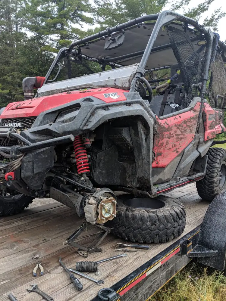

Had a rough night last night. Got stuck in deep gravel and mud. In an effort to rock it back and forth both front wheels shattered. Bent both front rotors and caliper mounts and broke the left front rotor off the hub. The rocks got bound in between the calipers and wheel. Both wheels blew out at the same time and the tires went flat.
Looks like both front tires are still good. Pile of parts on order to get this thing running for next weekend.
IMG 20200801 132300
IMG 20200801 004510
IMG 20200801 135204
I thought 1 spare wheel and tire would be ok...
