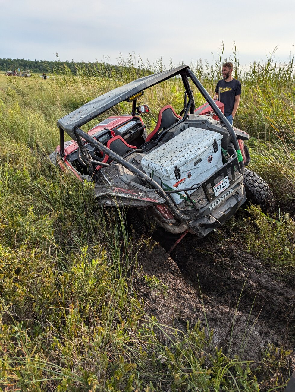

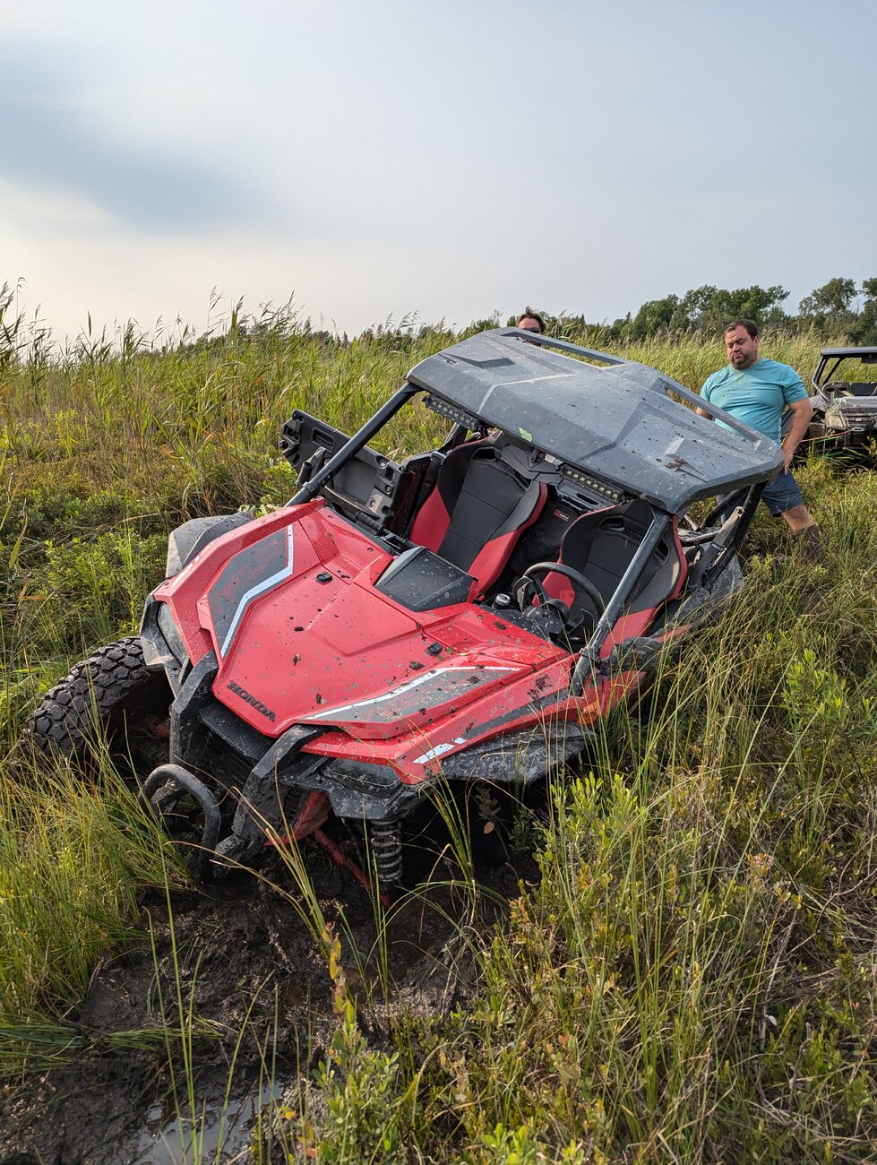

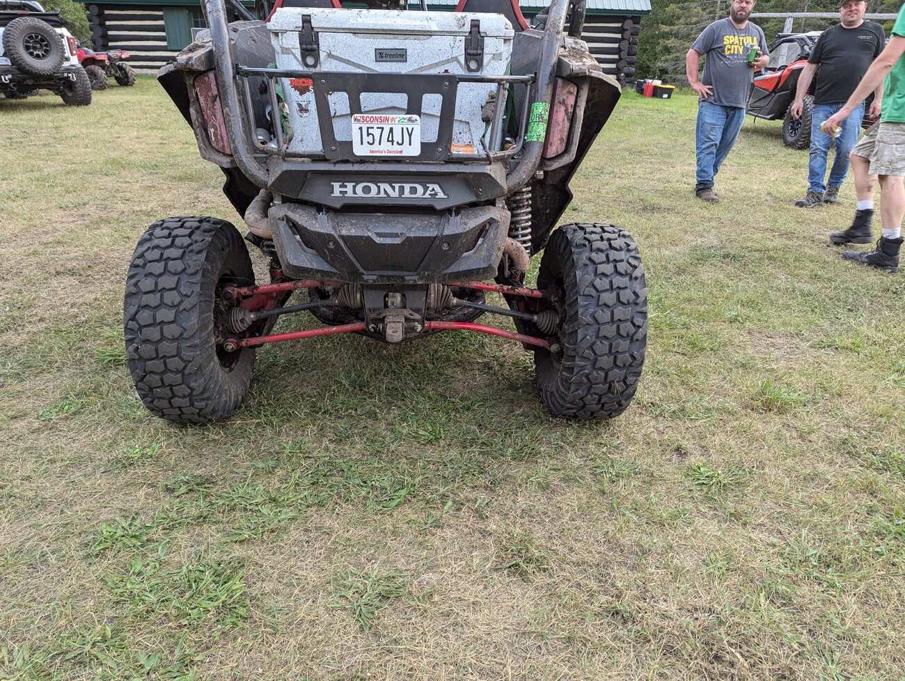

Well Drummond Island trip 1 is in the books.
I4wd is cool on high speed gravel. It's on in deep mud with some wheel speed. It is not thrilling on steep rocks. The 30s were a good compromise and the price was right but I was the smallest machine and 32s would be nice in the big rocks. The ride is harsh on the rough stuff but it really accels on gravel and rough roads with the exception of whoop like bumps.
And for the rougher news. Definitely looking for front lower a-arms but not super serious. Need lower radius rods. The 2 Honda's bummed around all weekend with no equipment failure and no repairs, so I can't complain too much in a group that broke an a-arm, lost a wheel and tire, wrecked a brake caliper mount, crushed and cut a brake line, put a machine on its lid, bent 3 radius rods and 2 a-arms

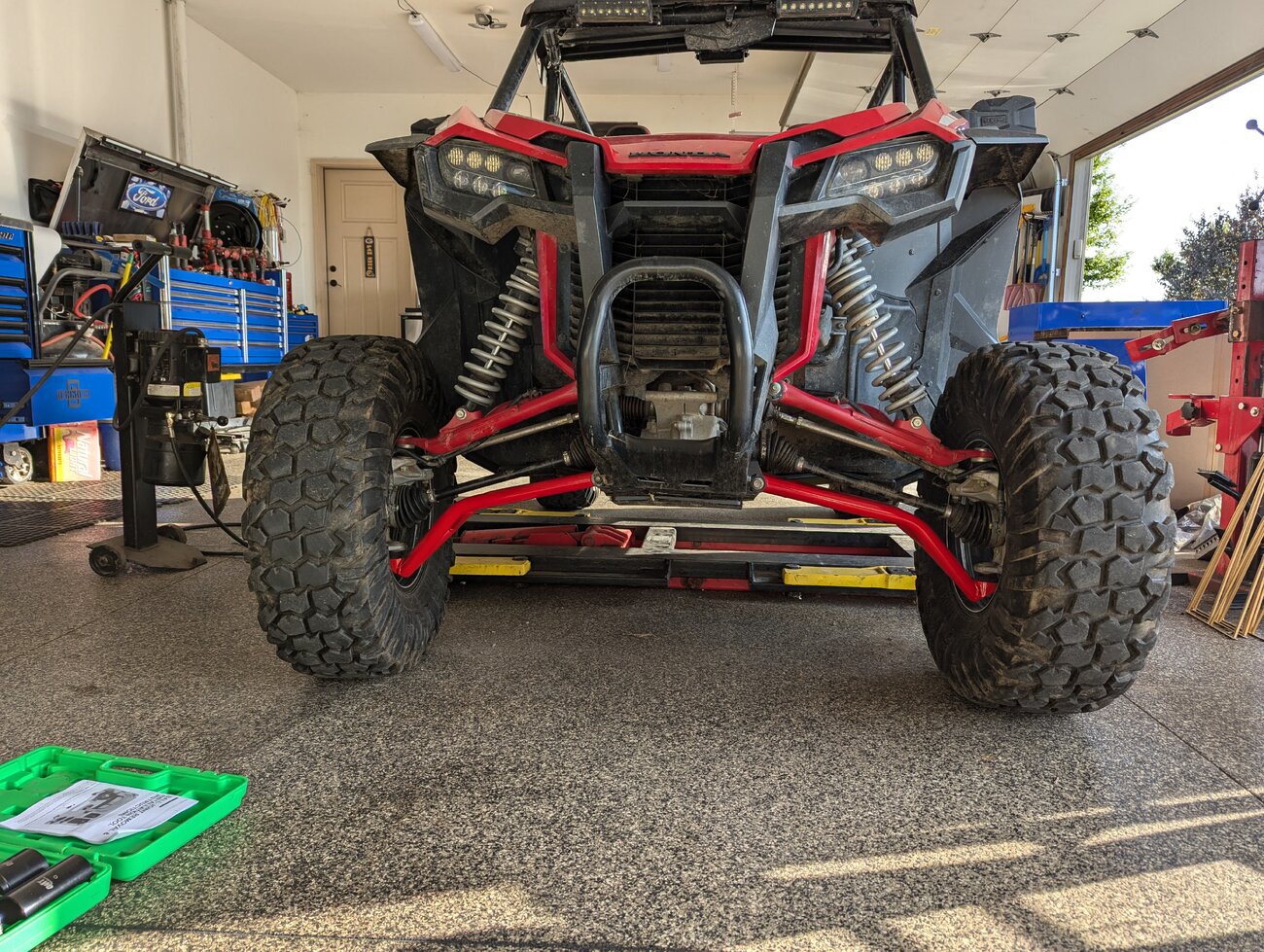

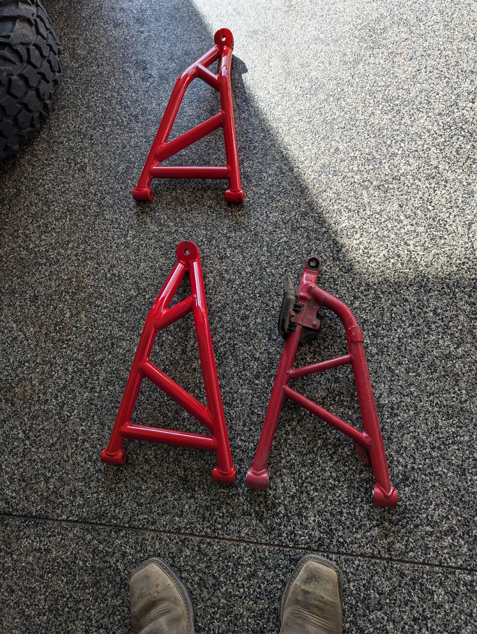

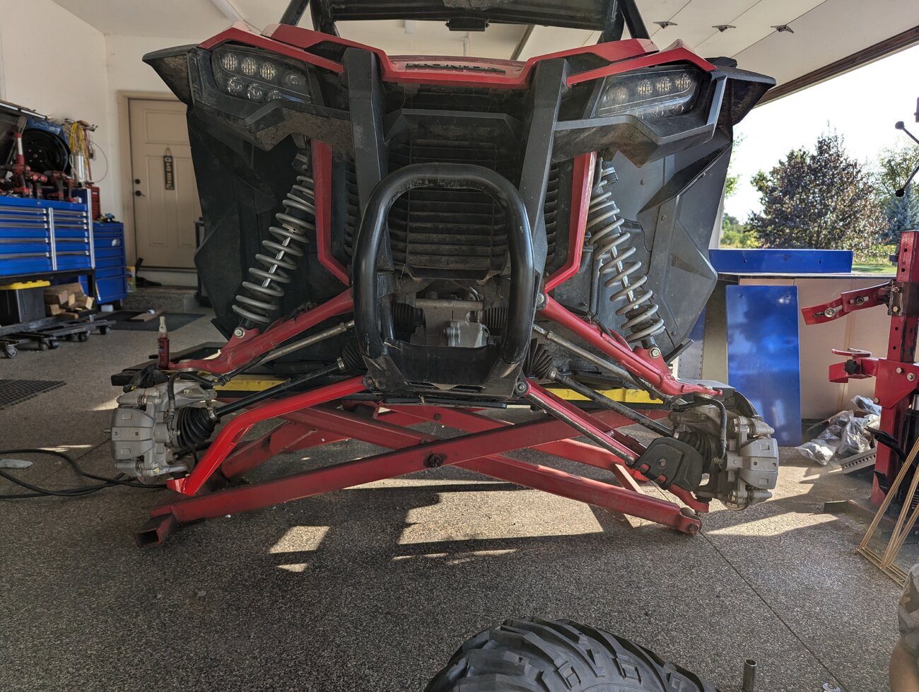

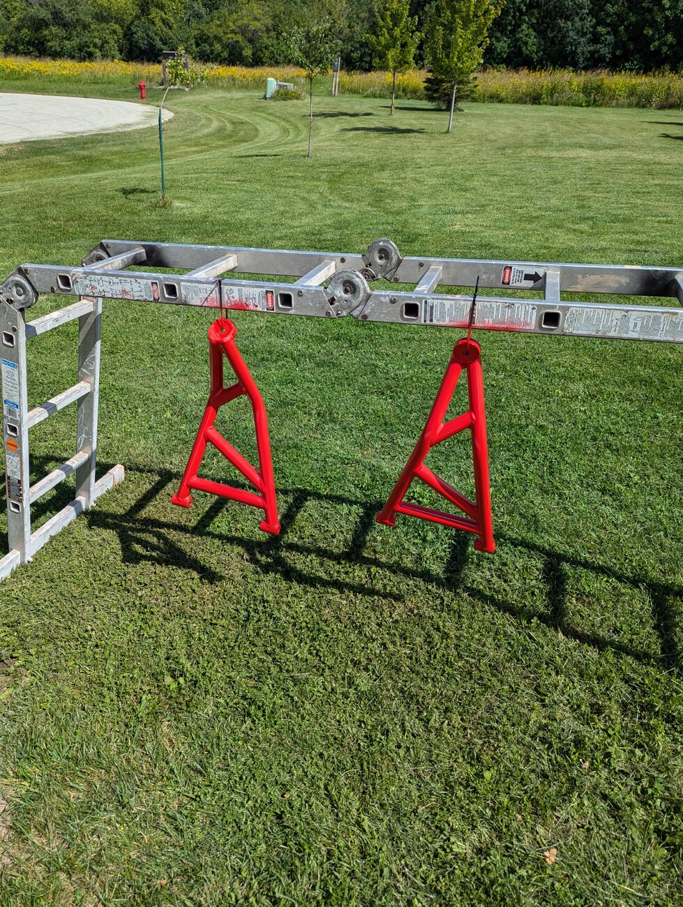

Got the Talon out of the garage today. A-arms were a quick swap. Greased the bushings and sleeves and slapped them in.
With the installation of front arms about half the damage from Drummond Island is fixed. Still trying to figure out a rear radius rod solution
L&W Arms. Painted red because the wife didn't think blue was a good color
1000008246
No complaints about the heft vs stock.
1000008423
1000008424
Ready to rip
1000008426

I just picked up a pair of those. What did you use to paint them? Did they not have the red powder coated versions?
Mine were picked up used. I used Rust-Oleum 2x paint and primer in Red, Scarlet red if I recall correctly. It was in the cabinet, it was red. I have low expectations for paint life.
