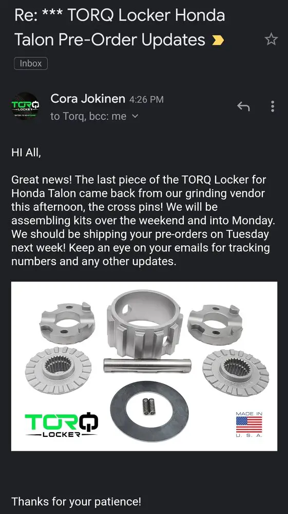

The last email update from Cora said they were waiting on a vendor who does their centerless grinding on the diff pin. She hoped they would be caught up so the kits could ship by the end of July.
Update sent out just now, see below......
Screenshot 20210730 111733 Gmail
