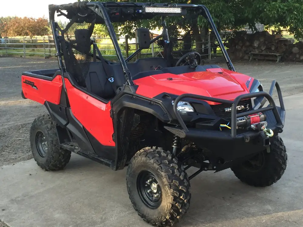

P1000 Tough country front bumper in production!!

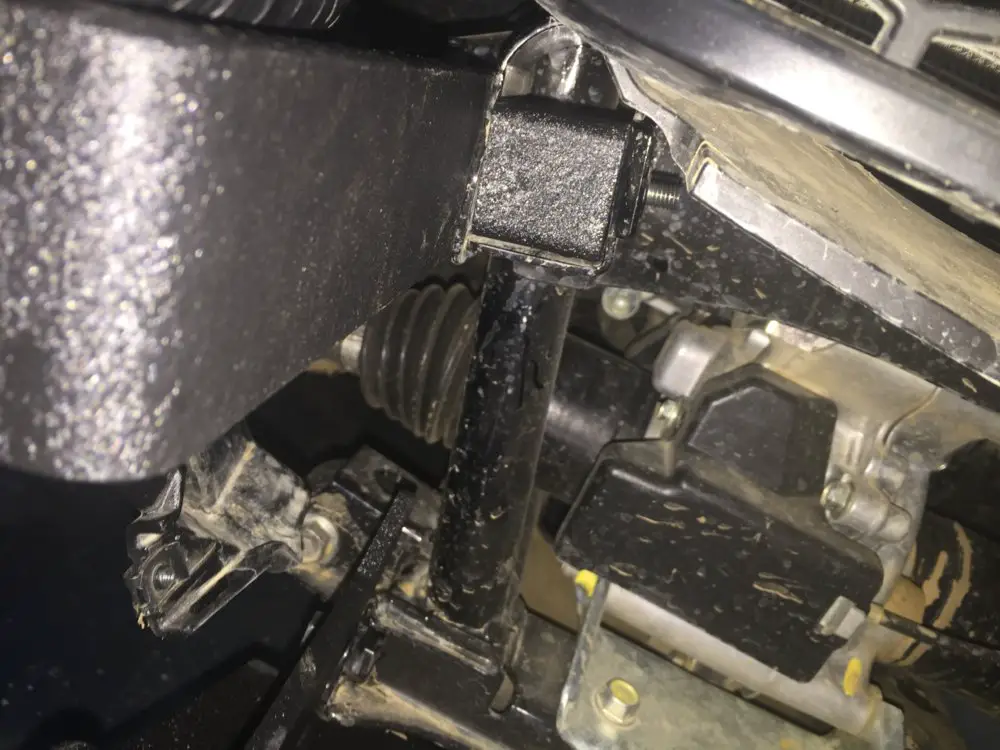

Okay I cut a hole around the front hole of the fair lead plate where the winch would set on it so now the winch sets in it a little. The winch fits under the bar, but the bolts that came with the winch aren't long enough. After I get some new bolts I should get it mounted tomorrow if I have time

Can you get picture of this modification. thanks
Tot
Tot
Dec 14, 2015
661
462
Des Arc, Arkansas
This is the best I can do without taking the whole bumper off then the winch back off

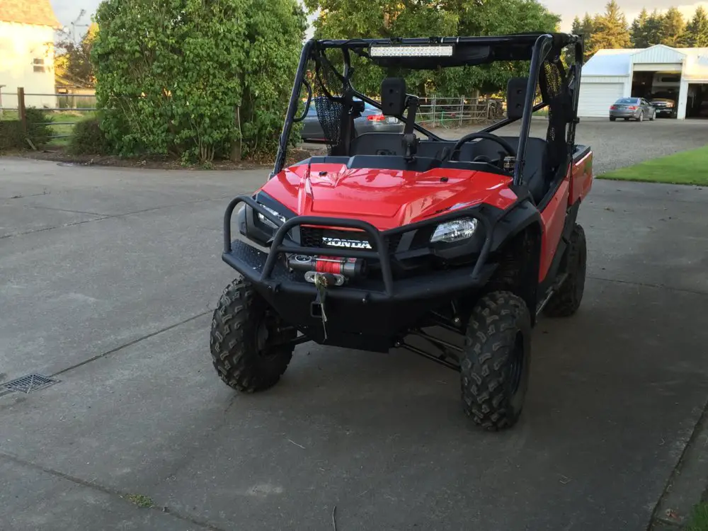

Did you buy the light bar from Tough Country? Is it a 12? I can't remember what size they offered. I'm thinking about getting a 14 and trying it
Sent from my SM-G900V using Tapatalk
Yes it is a 12" Tough Country light bar. I don't know if a 14" would fit, but it might if you turn the brackets the other way. The 12" seems to fill up the opening pretty good.

I ordered a 12" and it came in yesterday, but the brackets for it are adjustable on the bar itself, not on the ends. It wasn't going to fit, so I ordered a 17" bar. The tabs are 17 1/2" So I think it will work.
I'm going to use the 12" as a backup light on the roof.

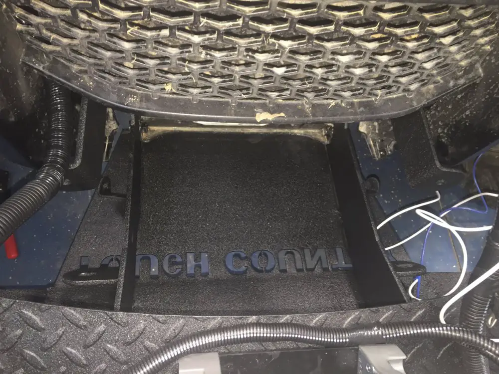

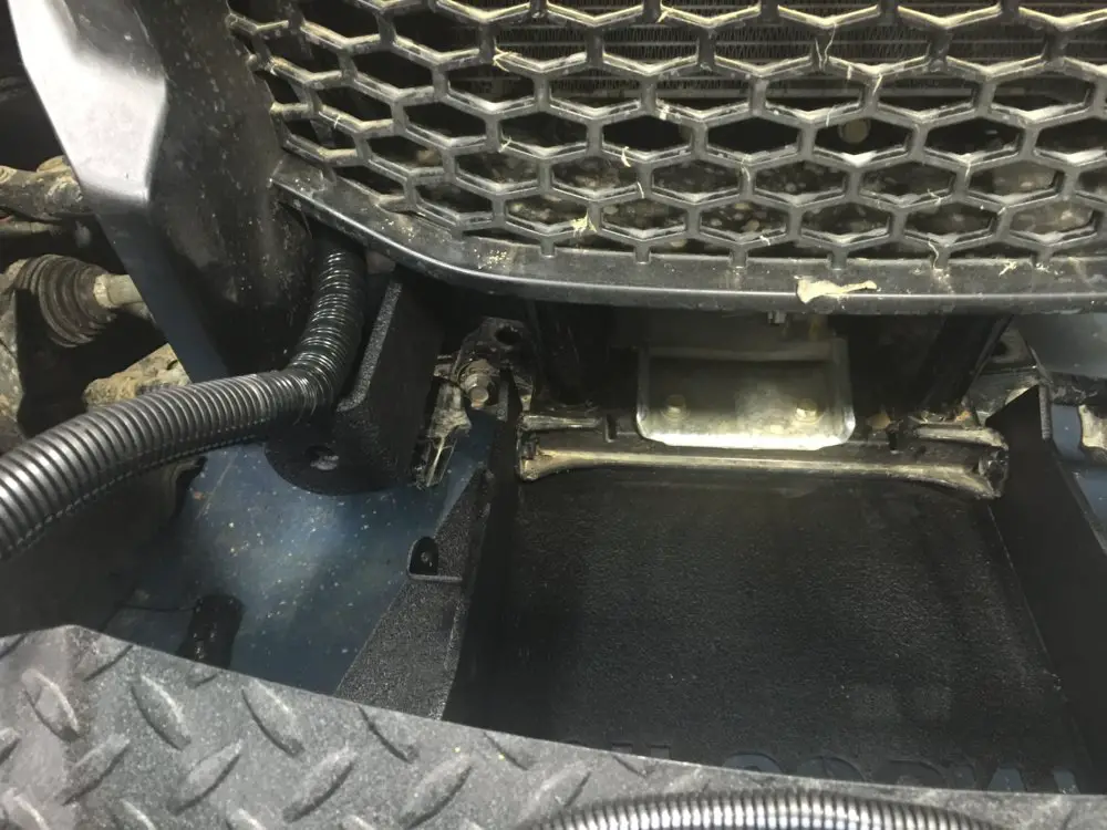

Update on my bumper. I got the 17" bar to fit with minor trimming on the tabs for the light bar.
Also some people without an aftermarket bumper have had over heating problems. I've had my machine in the mud the last 4 days with 0 heating problems.
