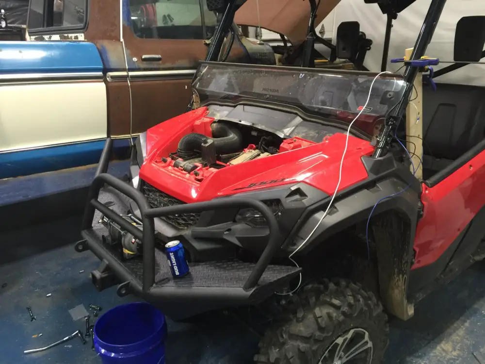

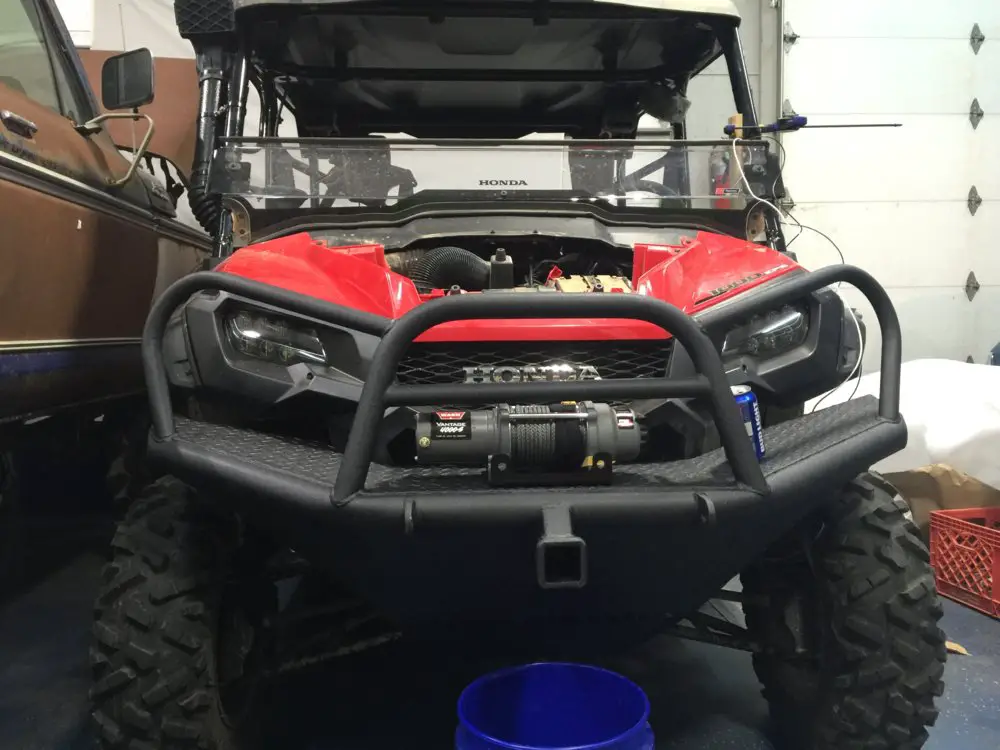

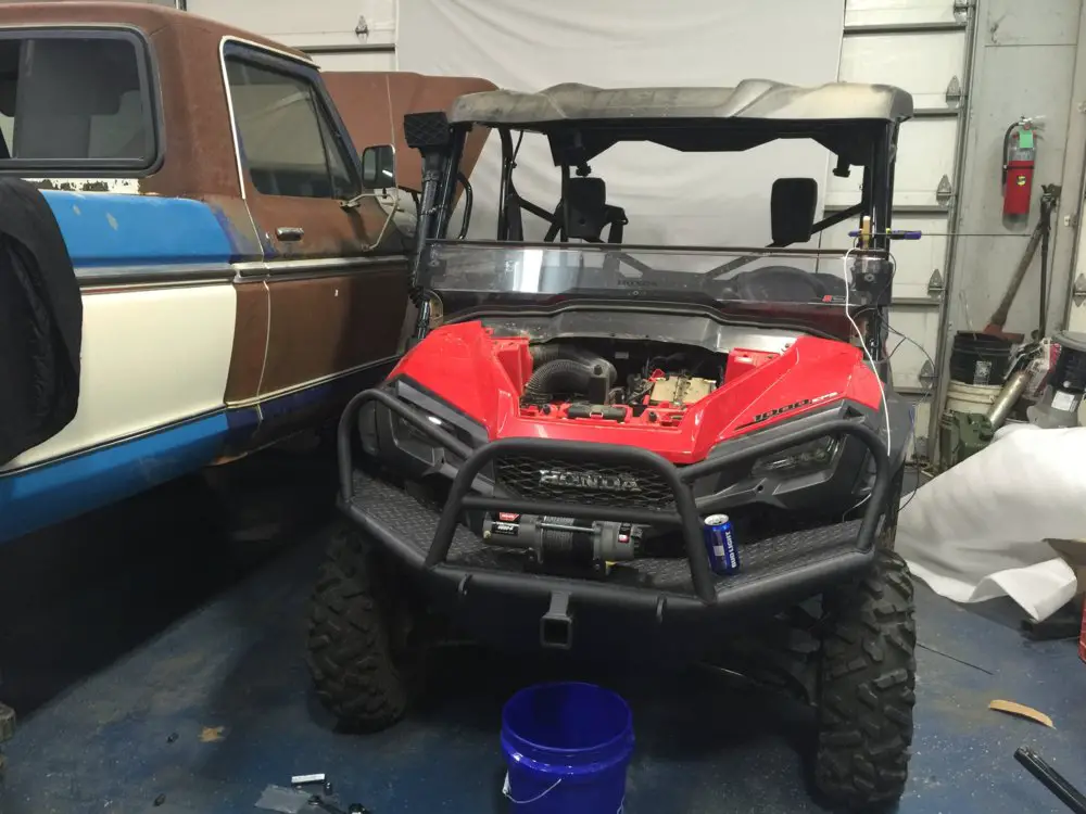

Pretty simple install, don't have spacers on front yet but I do like it!
Image Image Image
Kilo427
Kilo427
Dec 10, 2015
1,543
6,440
Aaa and yah know what.... We'll see that little spacer (black rectangle piece sitting in the hood) well I'm gonna need that... To go behind the bumper, so gonna take it back off.... And I'm just gonna sit down these tools for the night and slowly back away...

Looks good. I've looked at your 3 pics half a dozen times but I can't see which spacer you are talking about. Which spacer is it?
Waylan
Kilo427
Kilo427
Dec 10, 2015
1,543
6,440
Oh it was the spacer that sits in where the top two forks of the bumper slid into, I didn't end up having to remove the whole thing though it was late i was not thinking clearly. The beer had nothing to do with it I assure you.
