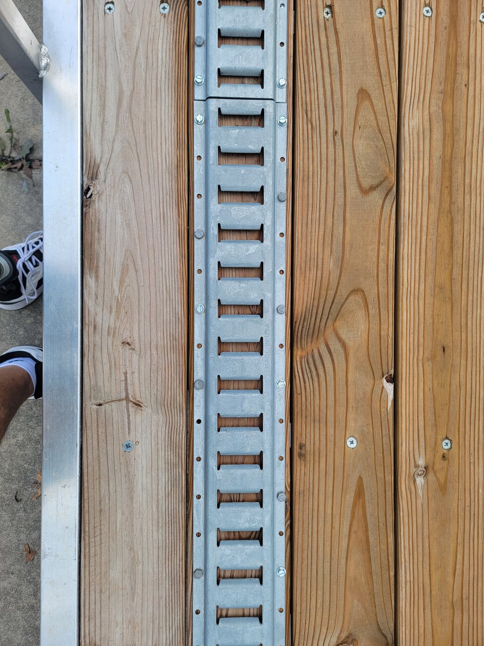

My deck boards are all thru-bolted to the trailer crossmembers. My eTrack has a boatload of screws and bolts. The silver ones are lag bolts while the darker ones are galvanized bolts, nuts, and washers.
when I still had my enclosed trailer I used etrack installed in a similar fashion. I took it a step further and installed 1” coated deck screws in the remaining holes…mostly because I had them already and that I had coated the floor with gray deck paint with grit mixed in.
You could really crank on that etrack and it wouldn’t budge. Several times I had to use it as a winch point to bring in my dead SXS as I had nothing else inside the trailer to use.
On my 10’ open trailer I might have to go back to etrack for the P1k5 and over the tire straps.

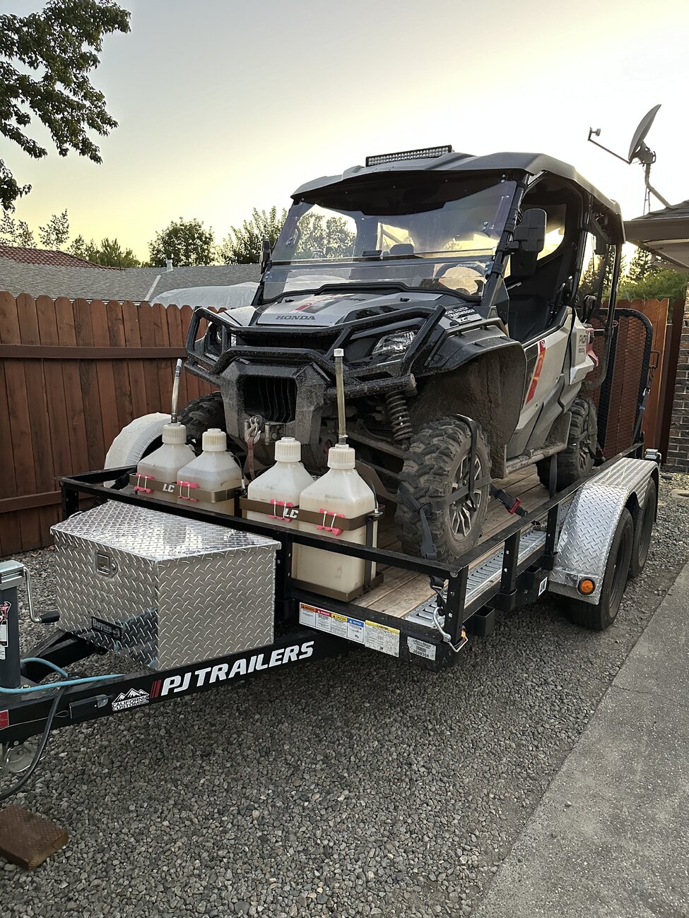

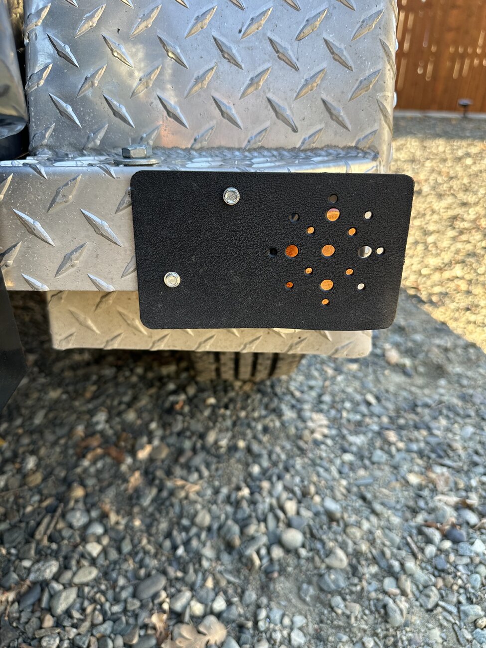

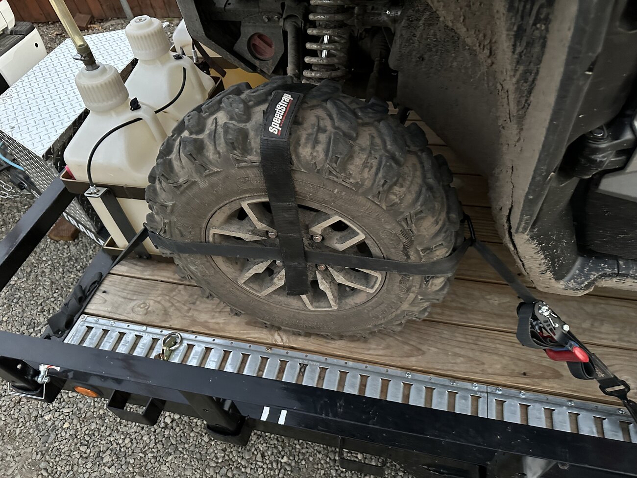

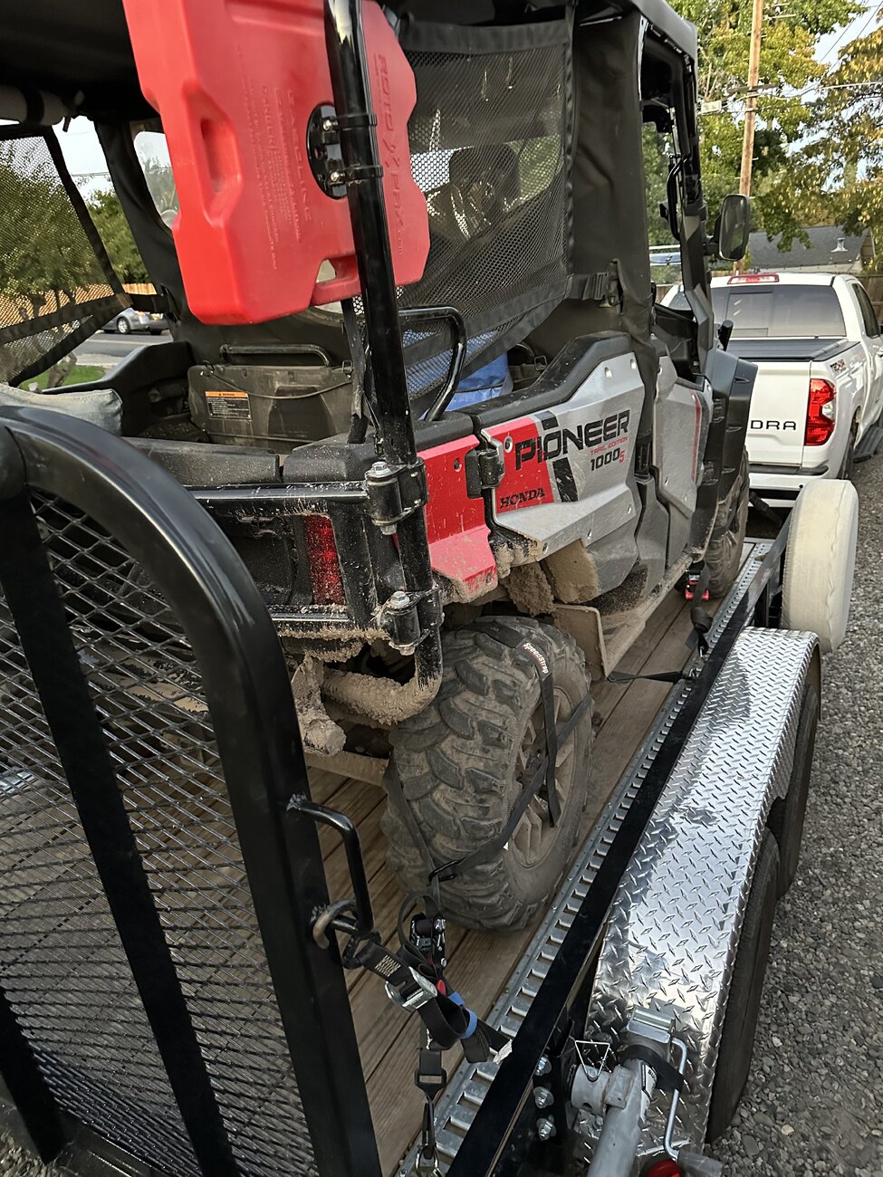

Thanks to all the folks providing such good information on this thread I started. I now have several thousand of miles towing with this set up and I am super pleased. I end up using etrack Bolted to the cross members and using the plates in other areas in between Cross members. I also used the Speed strap tire bonnets, they hold tight and stay tight, the setup took a little practice but is works very well And no suspension loading! I opted to mount two, pairs of 5 gallon fuel jug holders. This last trip I blew through all the fuel over 11 days and then some. Lastly on the trailer I added some protection to the marker lights. Having towed hundreds of miles on gravel roads I got tired of replacing marker lights.

I use Speed Straps as well. They do involve a little fidlin the first few times of use. I use D Rings and they need to be located accordingly
