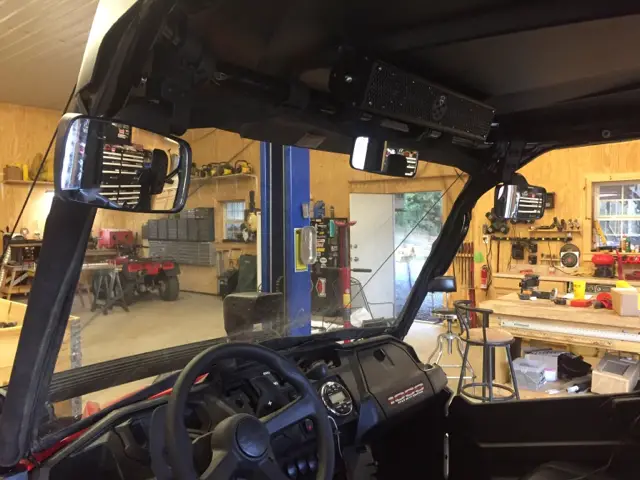

I want to say thanks to @CumminsPusher for selling me that windscreen by BugBuster.
At first I was disappointed that I couldn't use it with my mirrors but I installed it anyway and then searched for a better way to install the mirrors. Now they are mounted inside the vehicle which will be great for me because they are always getting knocked off. This was all a round a good day.
