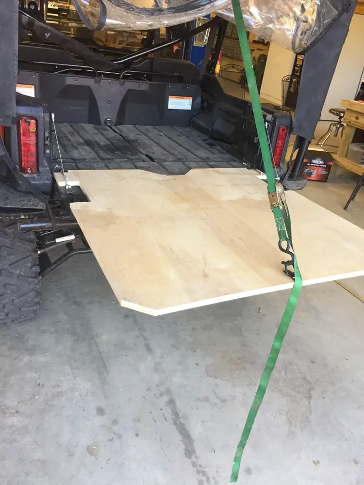

Check out my new invention, it's a bed extender for camping. I can sleep on it or use it as a table.
There's a guy out call @PioneerPete that thinks it's his idea but don't listen to him.
J/k buddy, thanks for the great idea!

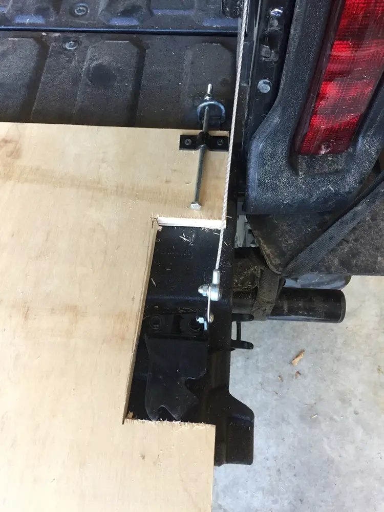

Did you use the extend tailgate cables, or did you make a small bracket extension and use the factory cables. I'm too lazy to go back through your build. Lol

He added at extention. You can see it in the second pic.
I found some pieces of metal in the shop that needed no other modification. They fit perfect including the bolt hole size and length. And they are stainless!

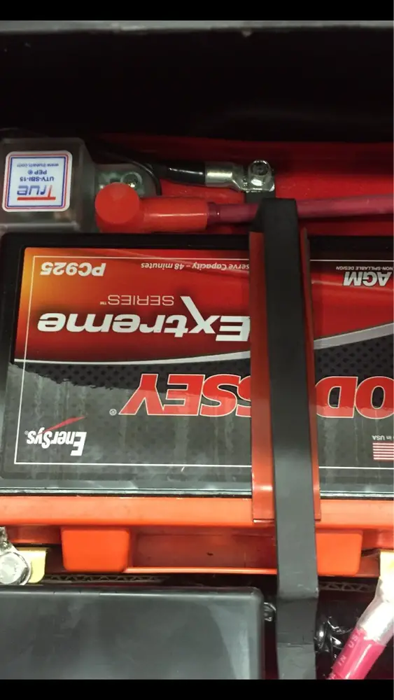

Quick question: referring to accessories you connected to the bussmann, where and what did u use for those grounds? I didn't see it in any of the pics. Tying to get ideas. Thanks
Reactions: CumminsPusher
39,129
They are grounded on my battery strap. I'll look for a pic.

I used the bolt on the battery strap. In this pic there is just one ground but I have more there now.
It would have been cleaner to use a ground block with 6-10 lugs but I was to anxious to get it done.

Thanks. I was thinking that was what you did. But I was thinking a grounding block possibly. But at least that gives me an option if I get too anxious

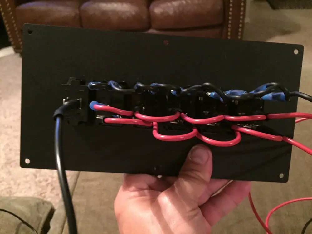

That is exactly what I did. I jumpered all of my grounds and routed them back to a grounding bar that I mounted under the hood. I tapped the brown headlight wire and ran that to my switch panel. Then I jumpered all of the led backlights off of that. That way my switches are backlit when I have the headlights on even if the switch is off. I am a novice at best when it comes to wiring so you may get some better feedback from the other guys on the right way to do it.
I have a question, for some reason I'm having trouble with the brown wire from headlight hook up. Where is that location at that you picked that up from exactly? I'm having trouble following those ( could be that I'm tired ) but all I'm seeing when I'm tracing under the hood area is different brown wires with stripes. Is it a solid brown? Also my bussman should be wired to the auxiliary battery side correct? Or is that just a preference?
