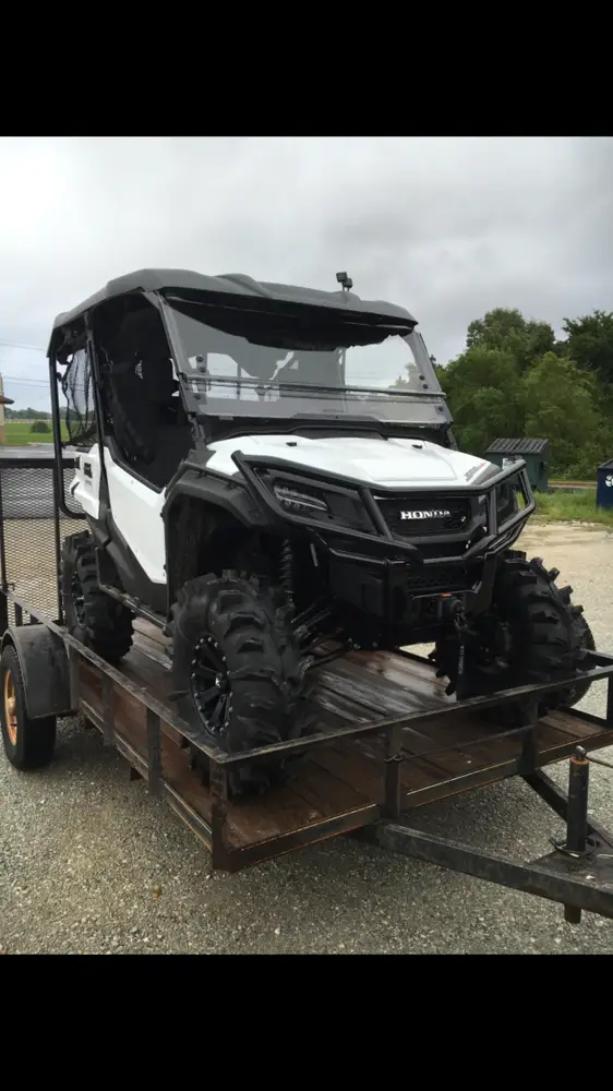

There are other great designs but I do like this because it's so easy to convert back. In some areas we ride a snorkel is illegal and not only can they fine you but can impound the vehicle so I felt it was my only choice. I had planned on running stock hood when it wasn't wet however I've gotten really use to it and in fact doesn't bother view at all. Even my wife that usually sits shotgun just loves it. Thinks it's cool and reminds us a problem is fixed. Even light from the light-bar that sits behind it isn't effected. We love it but it's probably not for everyone.
32,051
It looks like a fancy expensive filter to me. The instructions say to mount high enough to be out of the water.
I would recommend extending the tubing and putting a chainsaw or line trimmer fuel filter on the end of the line. That's what I did and got rid of my bellows after they failed.

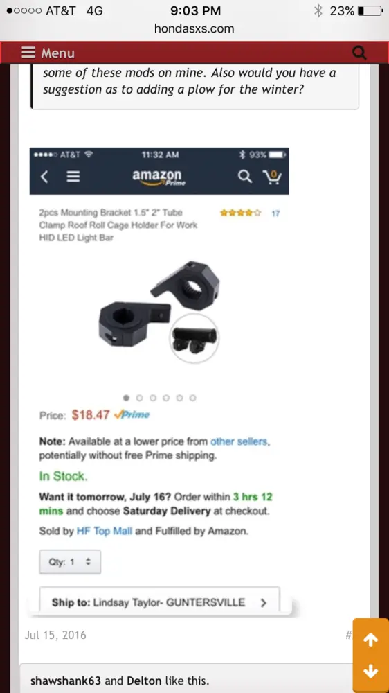

Image Hey bud I gotta Q for u. I bought the same mounting brackets u did for my light bar off Amazon. The 1.5x2" tube.. They ain't even close to fitting. Did u have to use a longer bolt or something.. Or am I doing something wrong?? Lol
39,130
View attachment 21830 Hey bud I gotta Q for u. I bought the same mounting brackets u did for my light bar off Amazon. The 1.5x2" tube.. They ain't even close to fitting. Did u have to use a longer bolt or something.. Or am I doing something wrong?? Lol
I think I used one of the two pieces of rubber and I did use a longer bolt now that I think about it. It wasn't much longer though.

Ok well I was gona take rubber out n use a thinner piece.. It's way off with both in there.
39,130
Here's a couple pics. One is close up to show the clamp does pull tight but I had to remove the rubber piece from one side

Image Ok thanks for the pic bud.. I tho about that just was worried about it not holding without both pieces in there.. I hope to get everything together this weekend..

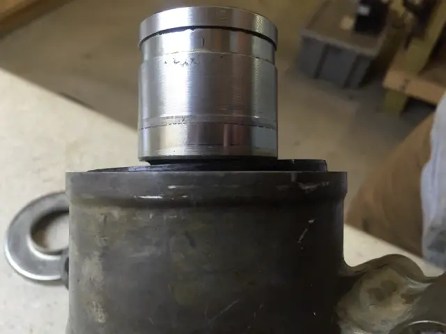

Not two sure the bellows caused the seal to fail. Was working on my today and found gear lube on my new TA skid plates. Looks like the rear pinion seal is leaking. I'm going to drain and measure the lube in the morning. Anyone had this happen at 250 miles. I bought a 4 year parts and Labor warranty and will a HL lift void the warranty?
39,130
That stinks about your seal leaking. I will tell you that it's not too hard to replace. I'd do it myself before letting someone else touch it. The hardest part is manipulating that diff housing out. It's tight.
A friend at Honda told me that the pinion seal needs to be glued in place and it's also A good idea to scuff the housing prior to installing the seal. He mentioned that it's a problem they'd seen before.
So, yours could have failed with out any pressure issue. It may have been an incorrect installation or a part failure.
Another thing about the rear diff, it's so close to the muffler and that makes it get much hotter than the front diff. I had 700 miles or so when it failed and the seal was visibly pushed out.
Here's a pic before i replaced it:

What you think guys leaking? 286 miles.
39,130
If oil can get out, then water can get in. I would get that fixed right away.
