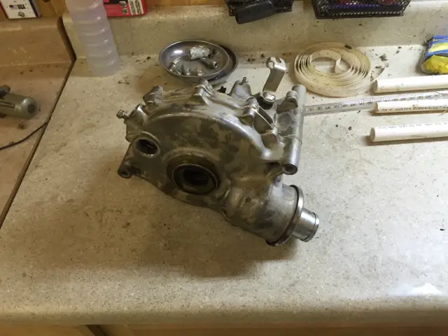

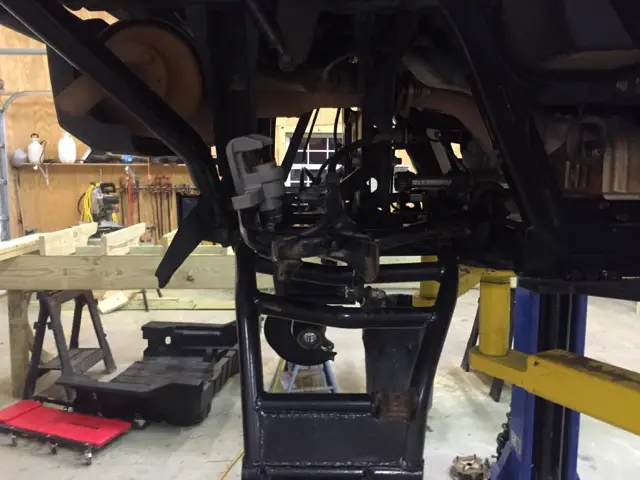

Yes, the bellows were not a good idea. I can't believe they worked for 700+ miles.
I pushed the seal back in and it was rather difficult so I'm. It sure of it needs glue or not. I think the manual said to grease it, does that sound right? I'll have to check that again. Anyway, the seal wasn't pushed out very far and I didn't want to completely remove it and risk damaging it. So, it just got tapped back into place and I will try it out today.
Wish me luck
39,129
Here's a picture of the seal and how little it was pushed out.
A8a8f465ce697914ed368b74089169da
39,129
Well that totally blows. How hard was it?
It wasn't too bad. Sure does look funny with all the parts missing....
853ded95076ddd0b0a1db2f511d6b372
This thing weighs about 40 pounds!

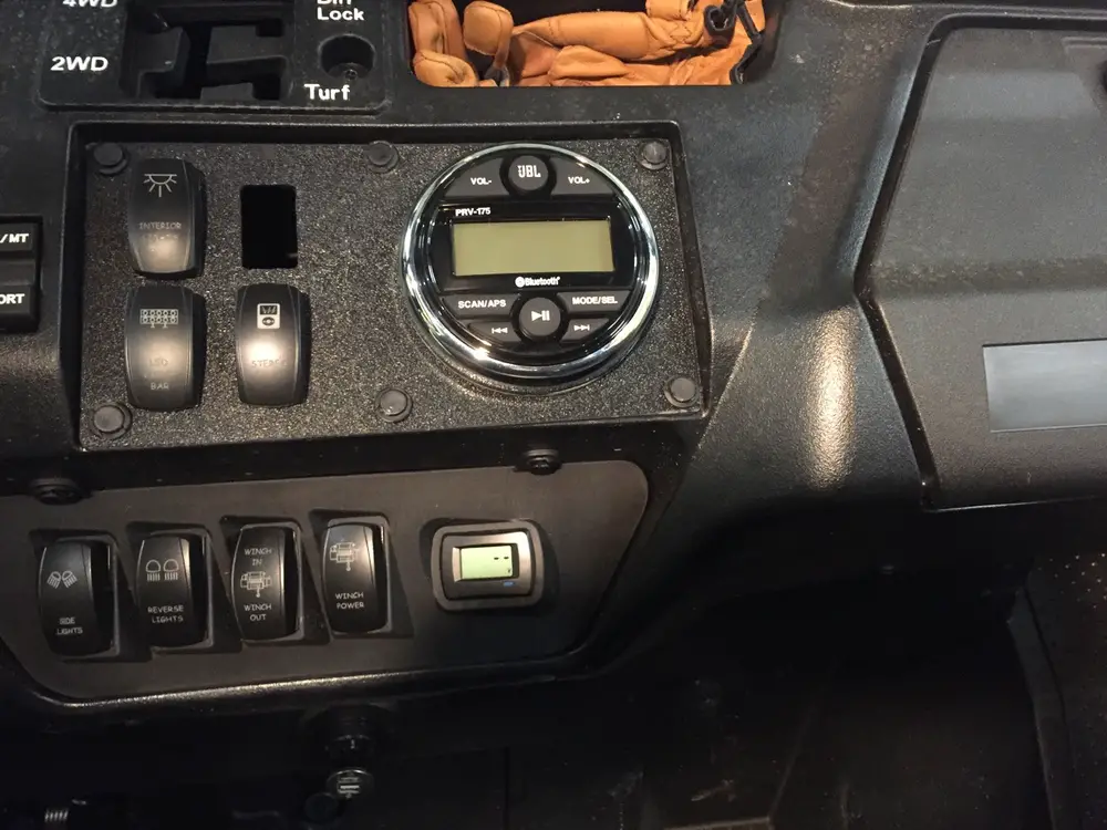

Got the radio and three more switches installed today. I had to stop there because I'm waiting on the PDM and USB port for the last switch hole. Also, I'm waiting on the WetSounds Ultra 6 to finish out the stereo.

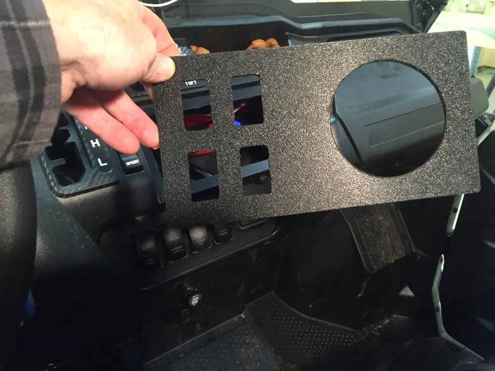

I cut a hole in the dash and left enough plastic to attach the panel too.
Here's the panel cut and ready

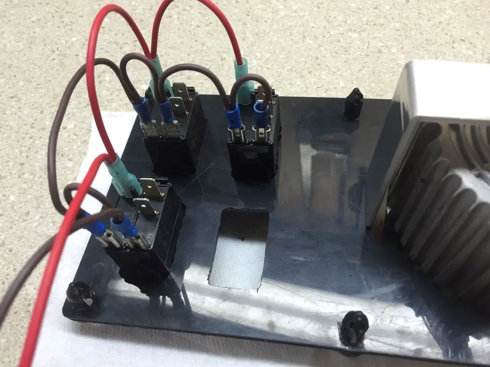

I went ahead and started wiring what I could like the hots and grounds for the back lighting

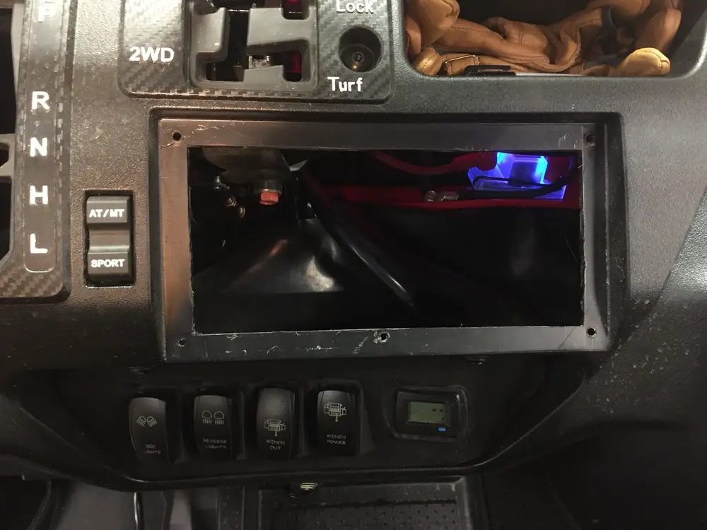

Here it is installed for now.
Sorry if this has already been answered but trying to figure out the proper way to wire switches. I only have one switch installed so far, but the back lights do not stay on when the switch is off. I need to wire it to the headlight wire or the accessory wire in order for the backlights to stay on right? Is that where your red and brown wires that go out of the picture are connected? Then, did you connect anything to the other two prongs on the switches? So in order to run multiple switches from the same power source and have all of the backlights stay on when the switches are off, I would follow this picture?
Post [HASHTAG]#332[/HASHTAG] on Jackal's build thread walks you through wiring your switches. Hope this answers your question.
//hondasxs.com/threads/jackals-p1000-5.3807/page-17
Jeffro
Jun 20, 2016
106
47
P1000 - Jackal's P1000-5
That does help, I think. I have the switch with 5 spades, and nothing connected to 6 and 7. So all I need to do is connect 6 to the brown wire and jump 7 from 8 for the ground in order to have the backlight on even when the switch is off? What about jumping additional switches from this one? I just get everything hooked up right on the first switch and jump each spade to the corresponding spade on the next switch (8 to 8, 2 to 2, 3 to 3, etc)?
