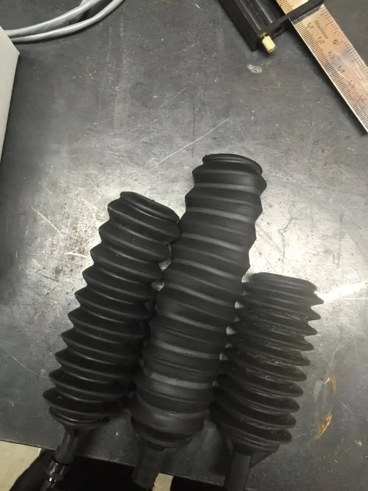

Well crap! I just took a ride today up to the in laws house. It was 100°F and I rode 60mph or faster for a few miles. When I returned, I smelled gear oil. I saw that the rear diff pinion seal had leaked oil. I think the seal is ok but I'm throwing all bellows in the trash. They have worked perfect for 700+ miles but 95° and higher must be their limit.

Here is the picture of the oil that has been slinging onto the skid plate under the rear diff

Dude I just posted about this. I have the high lifter snorkel kit with the bellows an that same thing happend to mine few weeks ago. Called high lifter an they sent out a recall on the kits. An sending out new hose to fix the problem. But my seal was junk. An high lifter is saying there gunna do right by me.
Mine only made it 1 week lol

Wow, guess im lucky I made it 700 miles. I typically ride slow and in water so I'm sure that helped.

This is what my three looked like. The rear diff was expanded the most. I've replaced them now with hose.
While extending the hoses, I also changed the rear gear oil. One interesting thing is that after changing gear oil, I noticed the rear differential made less noise. I use the exact same gear oil. I thought this was kind of funny because some people say that when they change to a synthetic oil, they noticed less gear noise. Maybe my gear oil had gotten too hot and broke down to where it was too thin and I was hearing increased noise levels. I'm not sure what to think about this now but it was a lot quieter. Maybe the rear differential get so hot that it will require the use of synthetic. I just use a conventional gear oil because I tend to change it quite often whether it be getting water in it or like this, week getting a leak. If I noticed the noise starting to slowly come back, I may have to use one of those $20 bottles of oil. Come to think of it, my differential has been pretty quiet until this summer.
