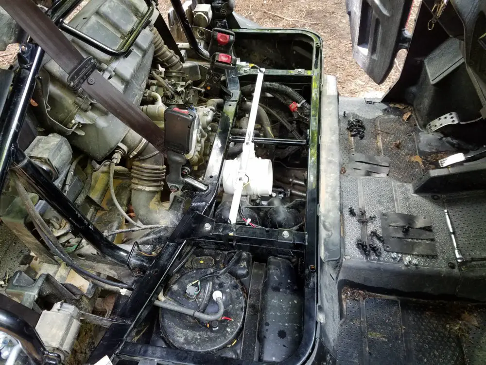

Haven't posted any updates in a while currently addressing in cab heat. Insulation installed the right way under the plastic and double layer between seat belts next to head and header pipes along with 4" bilge fan. Removal of seat back and plastic cover between seat bottom and back. Insulation BEFORE it heats up the plastic next to the occupants.
20160729 110216
20160729 110211
Will post as insulation is installed. Why is it so hot normally because only 2" gap and 1/8" of plastic separate engine from occupants. 20160729 104702

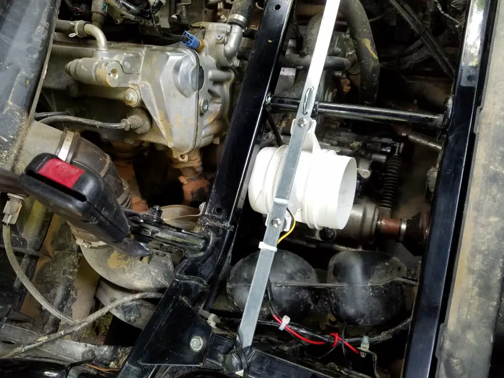

Jackal on the bulge fan placement Joey and myself angled fan to blow toward header /passenger side it seem to work better . You can feel air moving at rear tire area try engine off and running when it get warm great idea here.
Mine does the same you can feel it easily just inside the right rear shock blowing back even when cold.

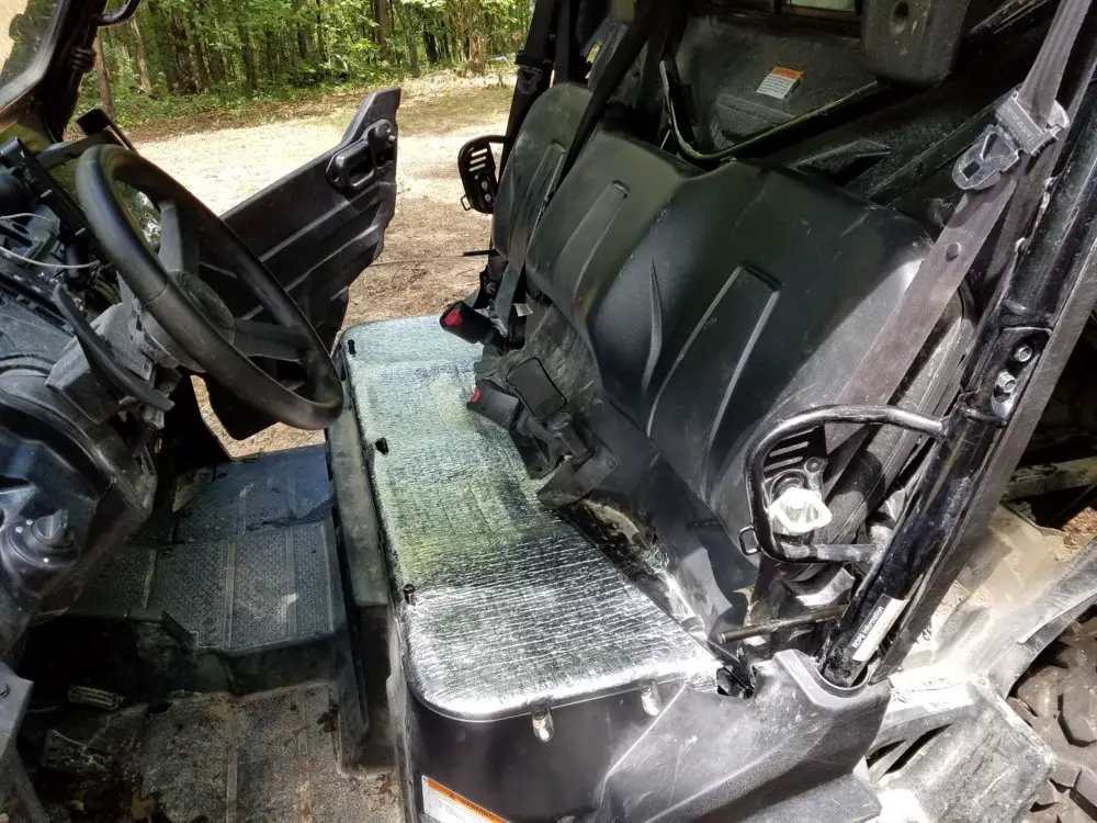

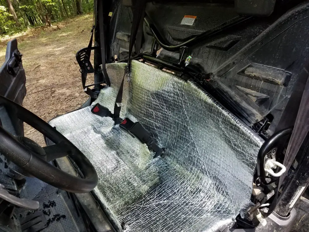

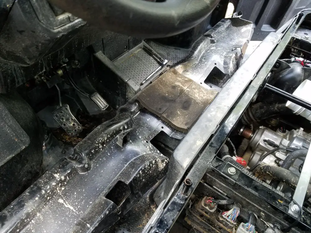

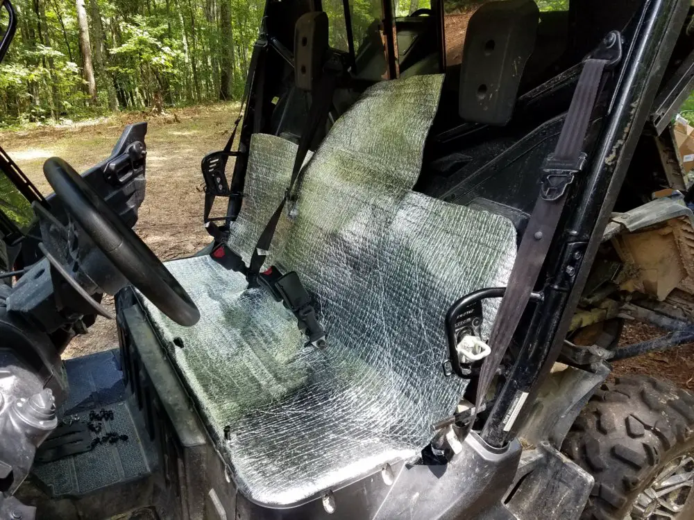

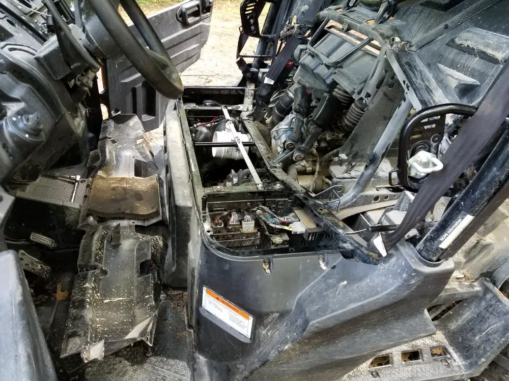

Ok so for the heatshield install I removed the seat bottom, seat back, and the plastic that spans the gap between the two.
All stripped down looks like this.
20160729 104650

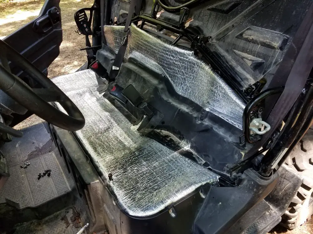

Fitted front and side edges leaving 2" material tucked down front and sides held by OEM push rivets. Trimmed back and passenger sides, left center full length to fold down in back to double thickness between engine and center seat.
20160729 124512
All tucked in place.
20160729 124657
Center plastic piece back in place.
20160729 130652
Seat back in place.
20160729 133334
Bottom back in all done.
20160729 133519

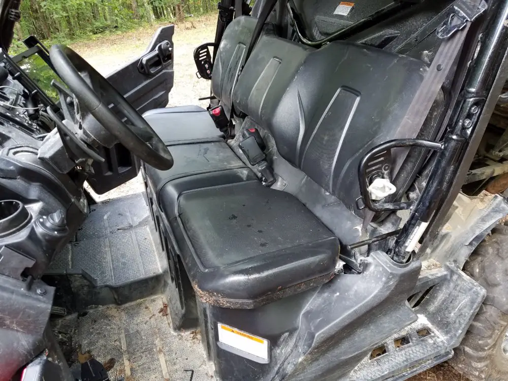

To check sub transmission I cut out a 8"x8" flap then took a scrap piece 3" longer and wider glued to top of flap. Simply lift up to check oil level then let it rest on top seat holds firmly in place.
Material used was this:
ESP Low-E® EZ-Cool Car Insulation Kit(Includes 40 Sq. Ft Insulation, 10' Foil Tape): Heat and Sound Automotive Insulation For Your Car Restoration Projects - - Amazon.com
Enough for two machines for $33.
Seat back in place.
Took this out for a test ride this evening ran about 30 minutes very satisfied with the results. The in cab noise was noticeably quieter and the heat in the seating area seems completely eliminated. In fact the only heat I did notice was coming from the drive select lever which I had never even noticed before. Will put it to the true test on a 6hr mountain trail ride Monday but I am very happy thus far.

Where did you get the bilge blower? Make and model number?
