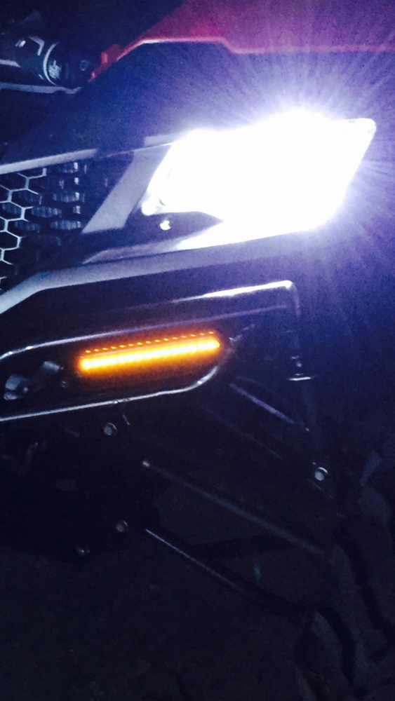

I wasn't aware of that It's funny as hell! guess turn pro now builds a set with integrated taillights. I'd use it but I'd still do my own front turn signals as well. I used these and they were very cool
New here, obviously. And new to Pioneer ownership. Are those mounted onto your brush guard? Mind if i ask where you got the lights? I'm considering ordering the kit and integrating a better turn light into it. i'm not sure i'm smart enough to figure out piecing a kit together like you fellers have been talking about. Plus, i'm lazy?! And the thought of diving head first into the electric of my new rig scares me to death.

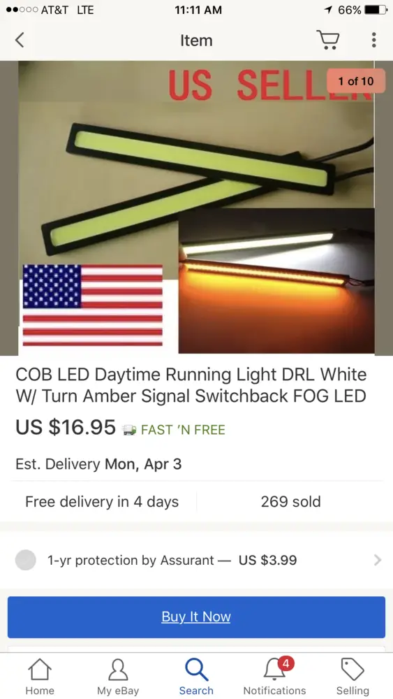

Welcome to the forum! Actually it's fairly easy to build your own kit and like you said you can pick your own equipment and be in it less.
With the trailer adapter you can use your taillights which are much brighter and no extra lighting in the rear. Now on those lights on the bumper of the 700 I went with these
IMG 9425
They are a dual setup so 3 wire is all and the white is hooked up to headlights or separate switch however you want that but when they receive power for turn signal the white automatically goes out and switches to amber it's pretty cool
For install of those I just got a piece of angle aluminum from home depot and used good double back. Very simple and cheap.
If daytime white wasn't wanted just the amber lights can be bought for around 3$ I think.
