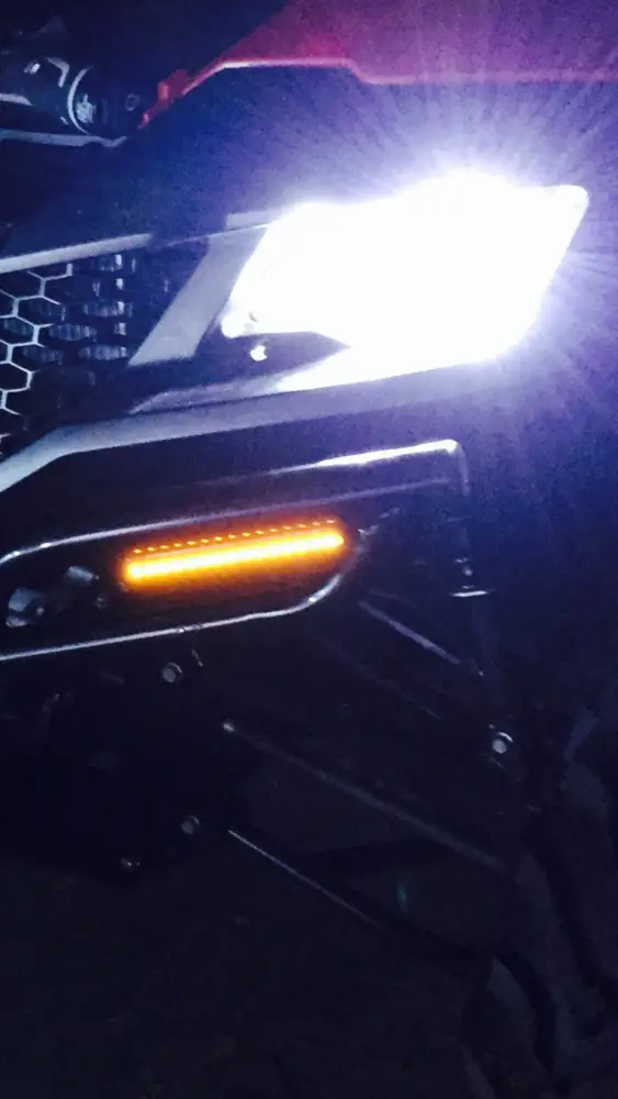

I wasn't aware of that It's funny as hell! guess turn pro now builds a set with integrated taillights. I'd use it but I'd still do my own front turn signals as well. I used these and they were very cool
Sweet blinkers! Where u get, I have turn signal kit I took off my 700-4 but they have the 3/4 lights, I like these way better
Reactions: CumminsPusher
42,062
322,675
eBay I posted up above here the one I used in it. Type in cob led and it gives many cool choices
Here's the setup in the 1000

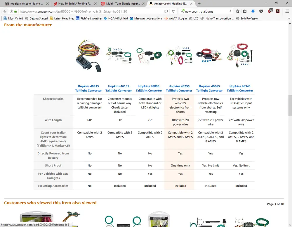

I was just looking back on the thread and checked on the item in amazon, because this is still something I haven't got around to doing yet. One thing I noticed in the Amazon description is this is shortproof one time only. I was just passing this along to make sure you don't have a short somewhere and hurt the new one. Let us know.
Upload 2018 1 25 9 54 27
LandPioneer
LandPioneer
Aug 22, 2016
929
2,417
Lebanon TN
Pretty sure the one time short just means that it will blow a fuse. Which is what I want to happen... I checked mine and the fuse is fine. All other wiring is fine only the yellow wire to vehicle input is affected.
32,050
It’s internal once it pops it stops.
