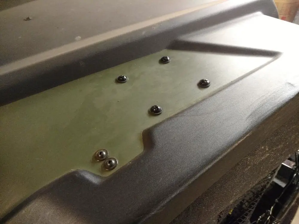

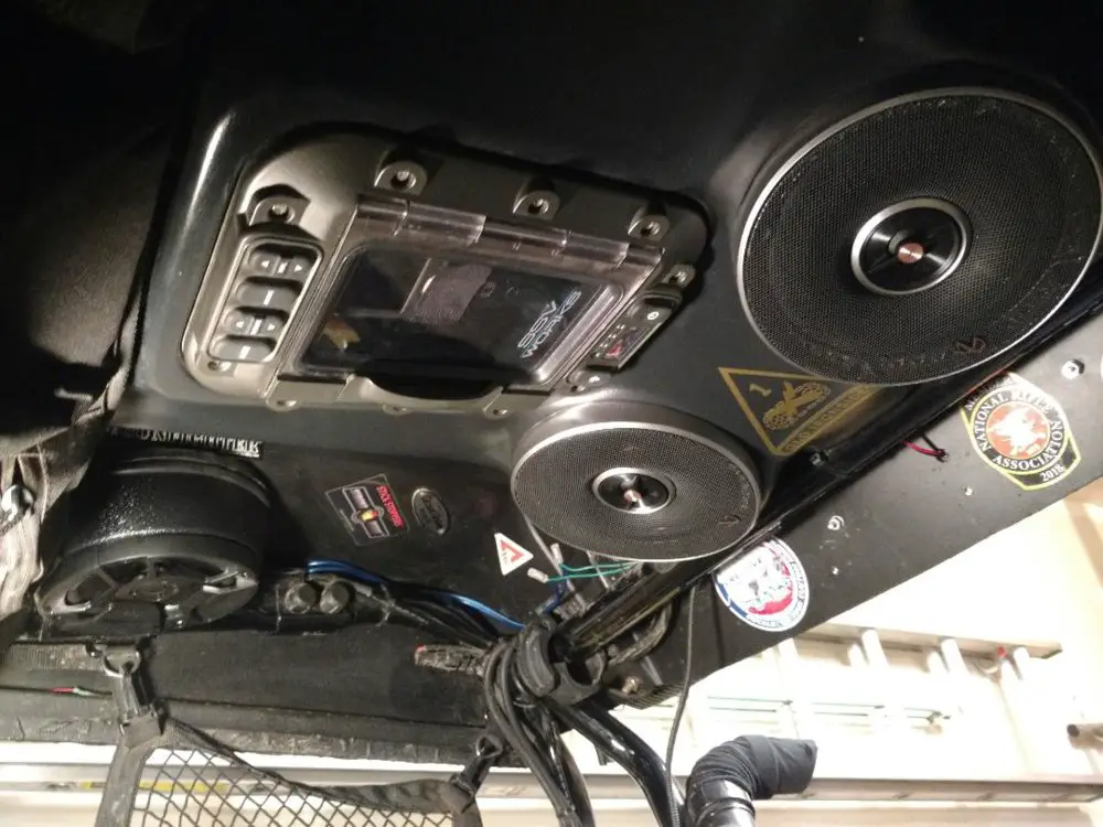

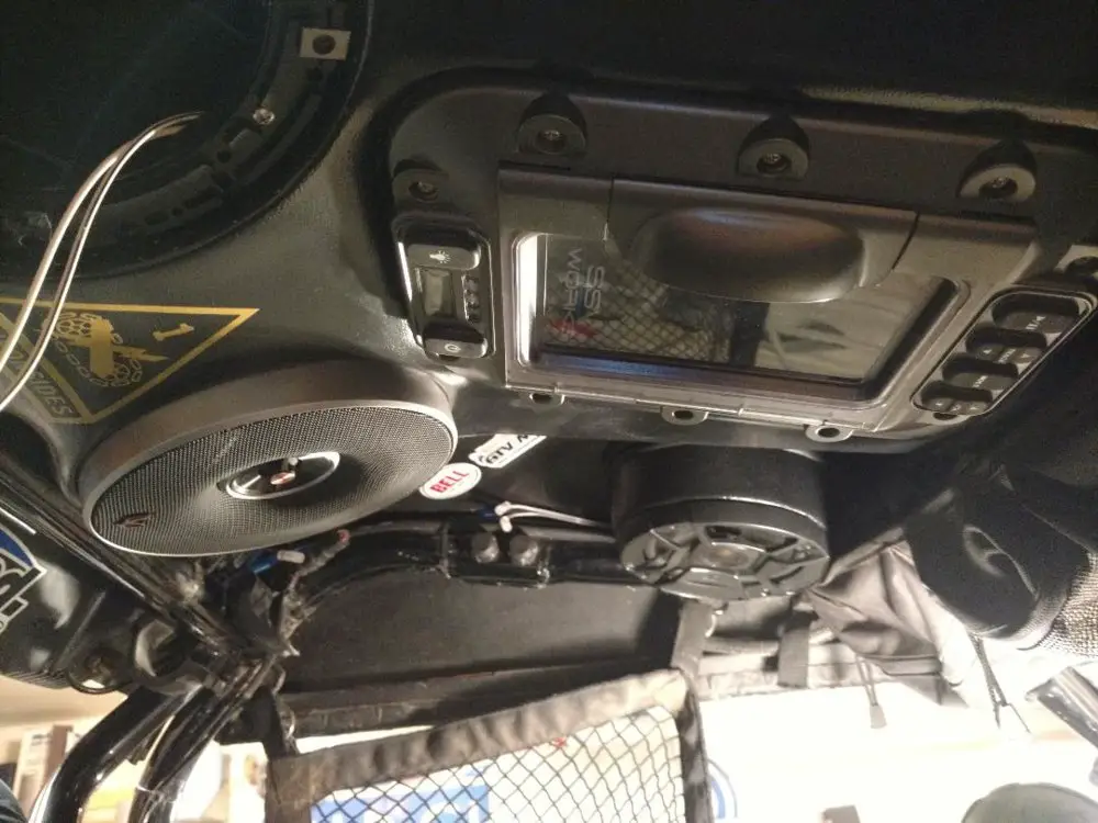

Been working on the stereo again. Changed out the SSV speakers in the overhead system with Infinity's. That was a pita to do as they were slightly bigger in size and bolt layout was different, had to use spacers to make it work but now there is 8 screws in each one, they're not going anywhere. Also changed out the 4" Noams with 5 1/4" Polk's in pods. That was a pita as well, through the roof with bolts, washers and rubber washers, custom spacers, had to cut down hardware, found out that baffles are bass killers. Made them sound really tight and clean but zero bass and less volume, it sounds better without them. Put it all together and rough wired it in to test the sound, sounds pretty clean. Was planning to put 5 1/4" pods under the dash next to the SSV's but did a test fit of the Noams and think I might utilize them up front instead, cross them over with the RF tweeters.
Anyway, all this adds up to better than it was before. As always, it's a work in progress.
