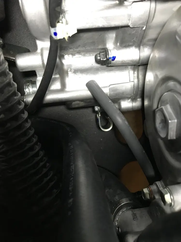

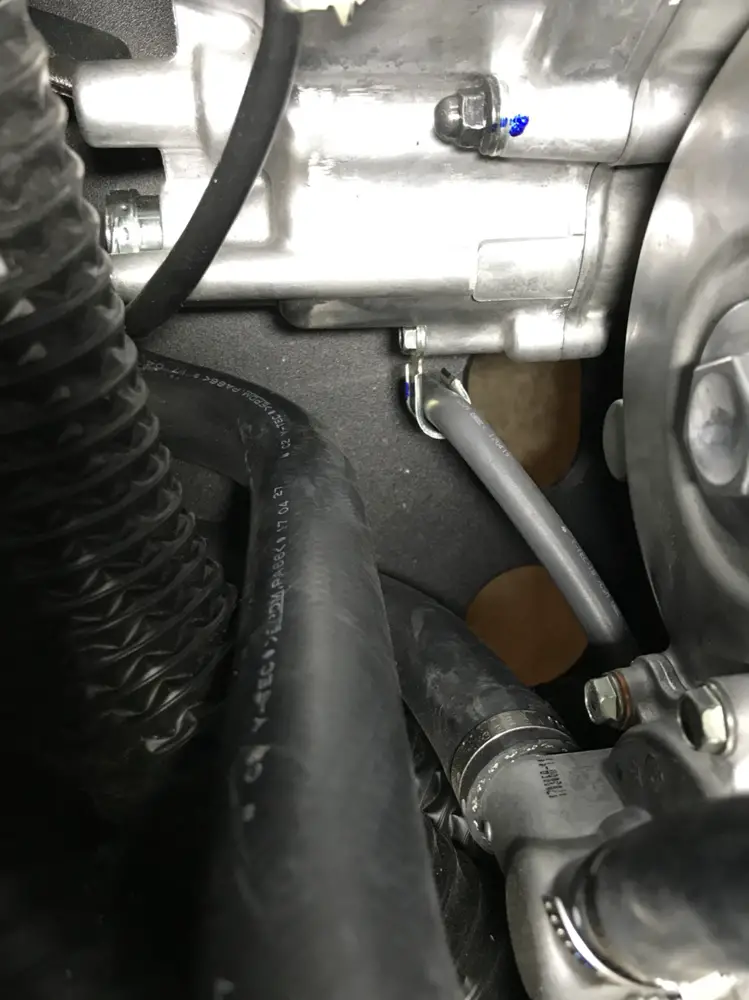

Is this the sub-trans vent hose? Located under the driver’s seat. The kit calls for a 3/8” fitting but this hose is 1/4”. Gotta think I’ve not located the correct hose.

Its the water pump weep line. Sub trans and gas vent both are stuck in the square tubing of the seat frame
