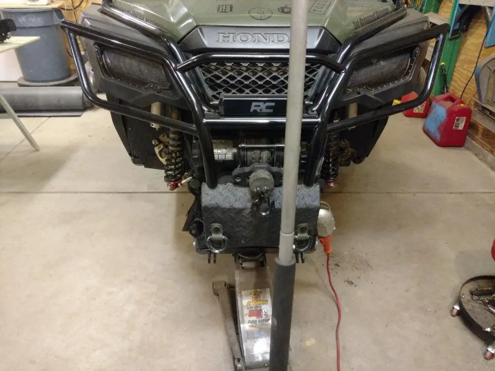

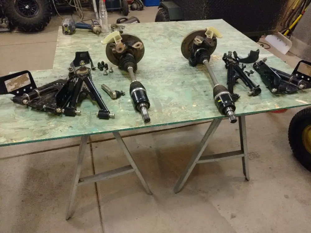

Tore down the front end over the weekend. Been sitting on some stuff for a couple of months now but it's time...one more round! 👊

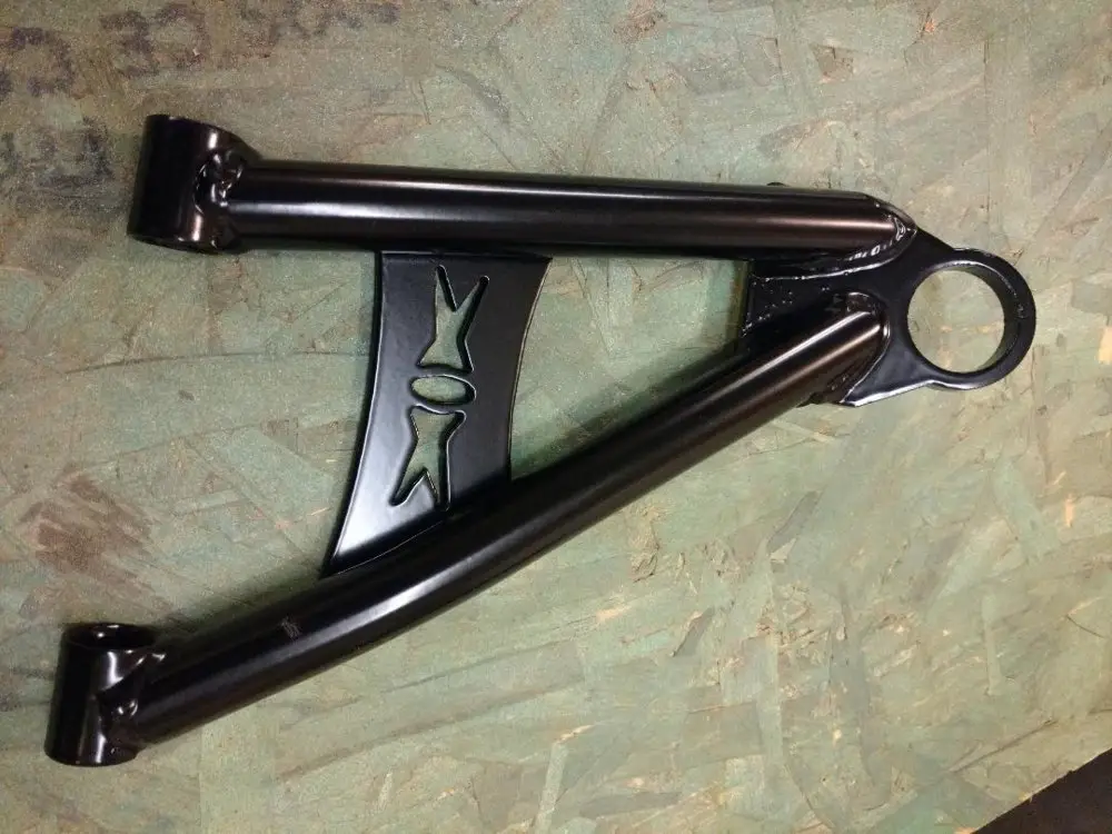

Outkast forward arched A arms

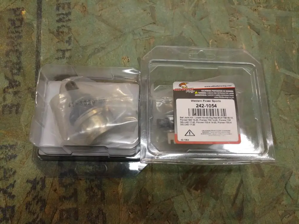

All Balls Racing ball joints

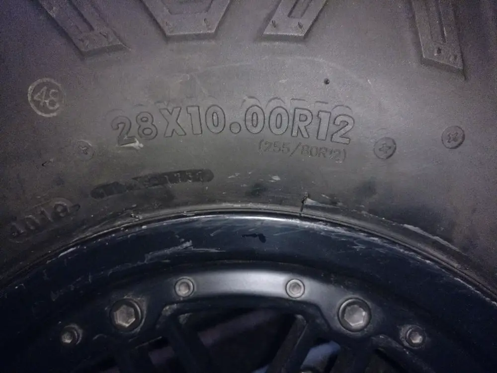

This is the spare, ordered 4 more today, went with BH 2.0's again. Have no desire to go up to 32's or anything, these run 28 1/8" actual and are slightly narrower than the 11's I was running. They only weigh 28 lbs a piece so I'm not worried about turning them.

On paper, I should end up about 1 3/4" taller than before and be at 55 1/2" width. These also push the length of the wheelbase 1.87" which should give slightly more stability. Won't know if that's going to be stable enough until I ride it though so we'll see.
The whole point is for true 28's with plenty of clearance all around and no rub. Longer wheelbase and taller rubber for more ground clearance and a better ride while still staying as narrow as possible. Figure it's going to look pretty BA too! 😎

trigger, arms come with bushings? Read the chatter in the past about the factory, for lack of a better term, 'torsion' bushings....
Yes, they came with bushings. Extended tie rods were extra and ball joints of course. A arm bolts need to be changed out to 12mm instead of the stock 10's too.
