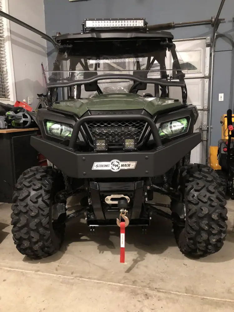

Consider a Strongmade bumper in your future, its good quality.

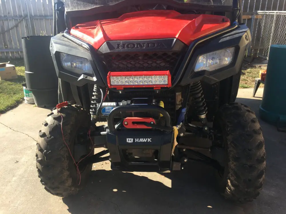

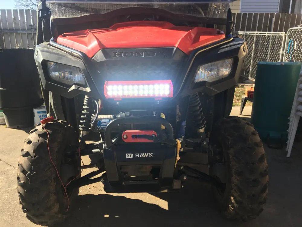

I just installed my light bar.
IMG 3559
IMG 3561

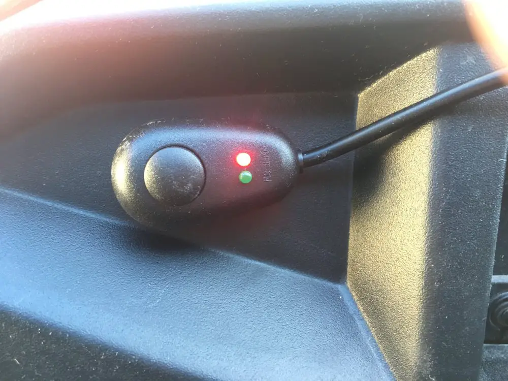

This unit from Amazon was great, it came with the switch, fuse, and relay. I just had to hook up a couple of wires and I was done. I hope?? There is a small red led that stays on, I hope it will not drain the battery.

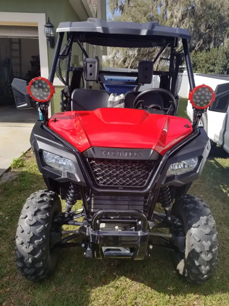

Added some led lights, not sure if I like them or not. They are a little big. What do you think?View attachment 185108
Cool how they colour match and am thinking should be functional where mounted. In terms of aesthetics for my eye, if you mounted them such that they fit inside the roll cage would look more balanced I think, I feel it’s a function of relative scale..... those are big lights and when on must be daylight! Perhaps because they are larger diameter to my eye, from where they are located now if you turned them 90 degrees. Not really fair comment as we don’t see the side profile. I don’t know if there is enough clearance but inside the roll bar frame just below the roof might look cool too.
j
Going to leave them on for now, we have not gone on a trail ride with them on yet. That will be next weekend. I will post some pictures. Thanks for your opinions.
View attachment 185728View attachment 185729 This unit from Amazon was great, it came with the switch, fuse, and relay. I just had to hook up a couple of wires and I was done. I hope?? There is a small red led that stays on, I hope it will not drain the battery. View attachment 185731
You should purchase the harness that plugs in under the hood and remove your power from the battery and hook it to the harness. It will then only turn on when the key is on.
One of the lights I installed came with a switch like that, I chucked it and wired it to a toggle switch as it would drain the battery over time. I'm sure it functions well enough but I'd also hate to see what 5 of those mounted on the dash would look like. ;)

The light bar button wire is only about 2 ft. long before there is a connection, so I just undid the wire until I ever need it. I did not want it up by the roof, and where it is now is pretty safe from damage. I like the matching red paint, I'll bet I get 2 or 3 mph more out of it.
