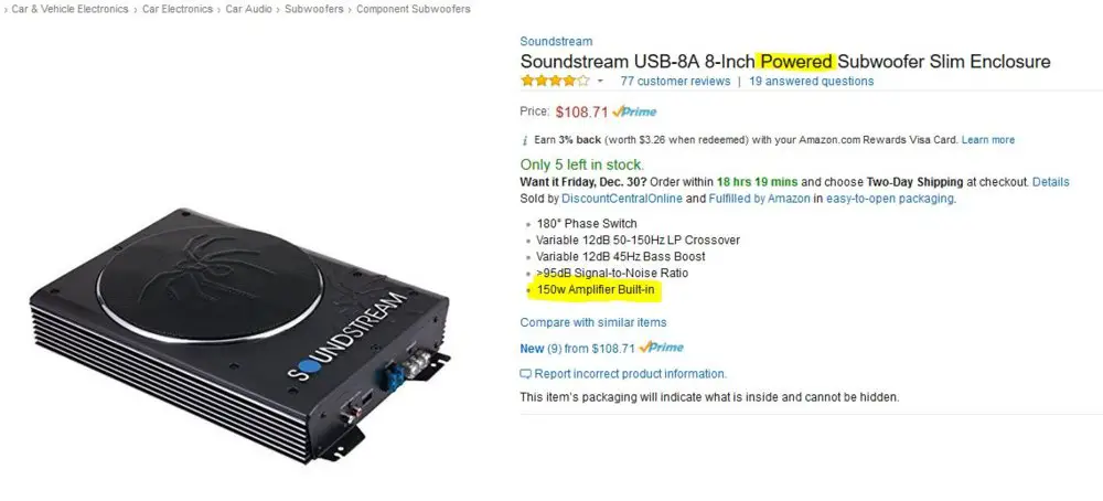

You're looking for a loaded, powered subwoofer. Loaded, meaning the speaker has been installed in the box already. Powered meaning it has its own onboard amplifier. The main criteria you're looking at is size. You need to have an idea where you're going to put it.
Ok, when I look at these things on line, they all appear to be around 2-3" thick by a foot square give or take depending on model. Where I put it would depend on whether sound is coming from it directly or whether it's just enhancing the sound coming from my sound bar??
Both, sound does come out of it but not like a full range speaker. Only the lows and it will enhance the sound.
Oh ok, then under the hood wouldn't be a good spot???

Better than nothing but you really don't want it to get wet either.
I think I could overcome that. Back to wattage, does it have to be paired with that of the sound bar?
No, most have a wired or wireless remote to control bass. Or you just set it at the desired position and it's done. Mine is nearly maxed. The smaller the cabinet, the smaller the bass.
That sounds easy, so do I want to stay in the 2-300 watt range or get a 2000 watt? What I'm getting at is I want the best bang but don't want to damage my sound bar obviously.
Has no effect whatsoever, your soundbar will only be sending a signal. You want as much bass as you can get for the small amount of room you have to work with, assuming you are wanting a somewhat permanent mount? It will increase and decrease volume with your stereo like normal. You just add how much low end you want.
Great, would you mind taking a look at this and giving me your opinion. I particularly like that it's only 5"x10"X1.5"

@Montecresto if you get a "powered" sub, you don't need an amp. Your sound bar RCA outputs put out low level signals and the powered sub will handle the rest. If you don't get a powered sub, you will need an amp. @rocmar 's sub has everything it needs built in.
Tell me about powered subs? Thanks

Is there something like that of smaller dimensions?
I don't know, I haven't shopped for subs in a long time. @trigger would probably know since he commented on the size of that sub in particular.
EDIT: This one is pretty small and the reviews seem okay, but I don't know anything else about it. Amazon.com: Kenwood KSC-SW11 Compact Powered Enclosed Subwoofer: Cell Phones & Accessories
or Amazon.com: Pioneer TS-WX120A 150 W Powerful Amplified Subwoofer System: Cell Phones & Accessories
