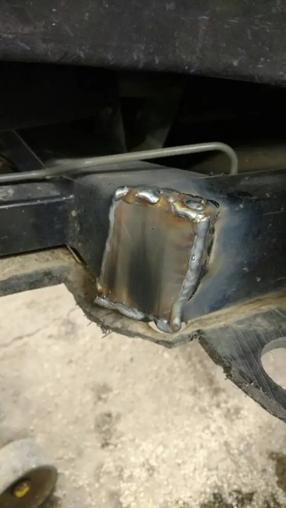

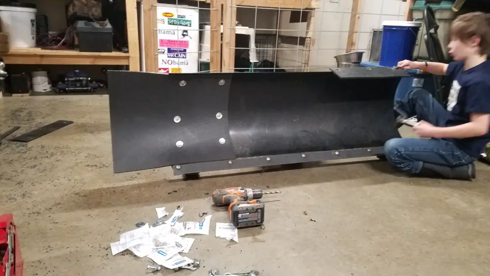

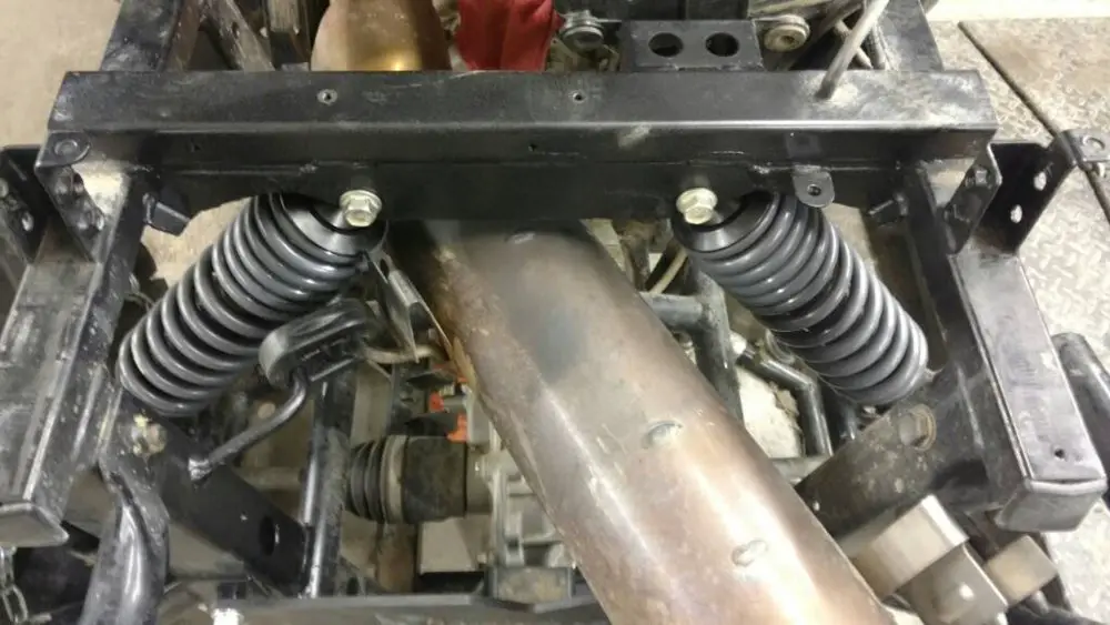

Better then feeling of food in my stomach , I like better feeling of one hour getting closer to wrap up my mods. Went for a lunch break and welded front frame caps. Now I like welding :). Was Scarry of getting shocked first time.

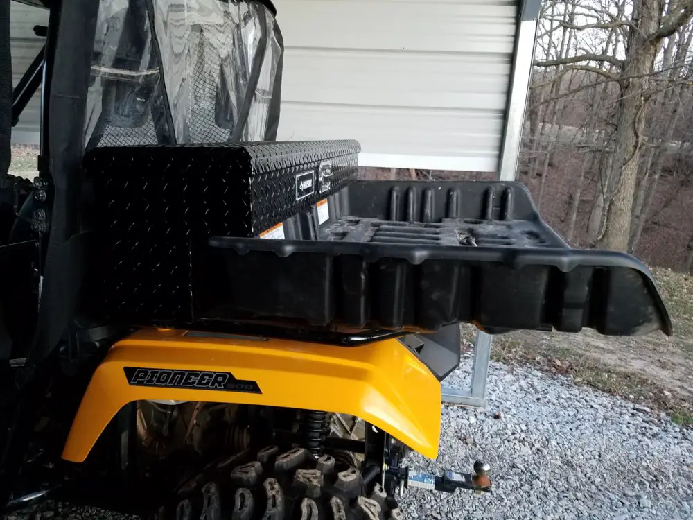

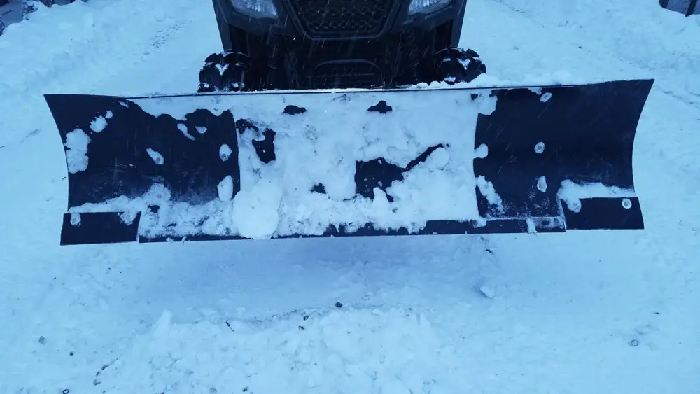

Cool, what metal did u use for lower plate?
Sent from my XT1585 using Tapatalk
I used 3/8' UHMW heated in the oven to extend the blade 10" out on each side them mounted a strip of 3/8" heavy rubber from a truck mud flap to the bottom so if I hit something solid it won't damage the blade

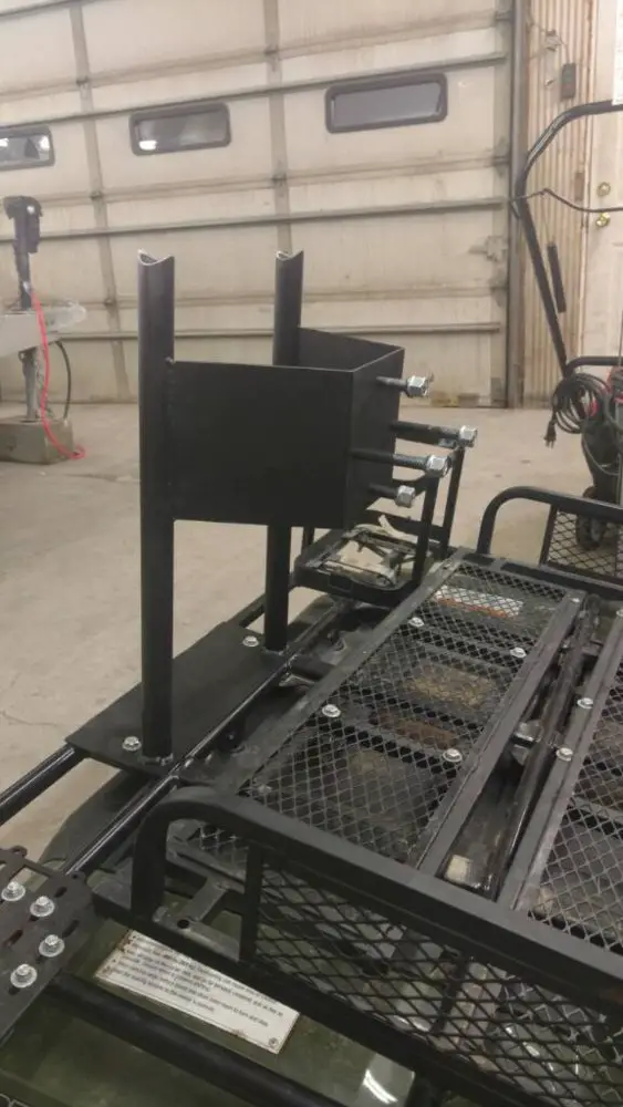

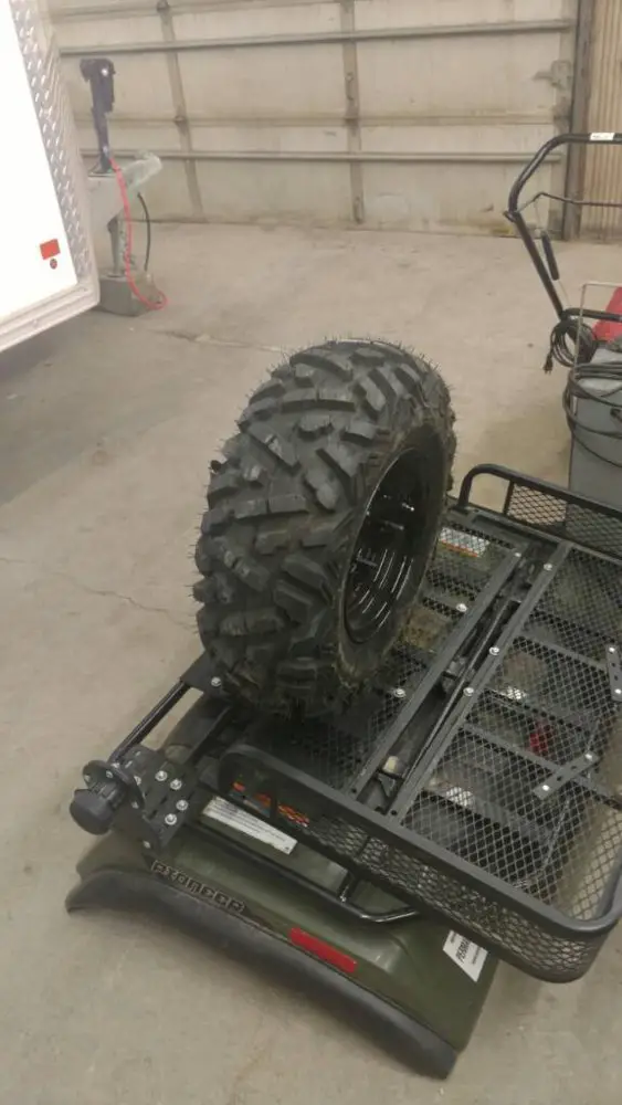

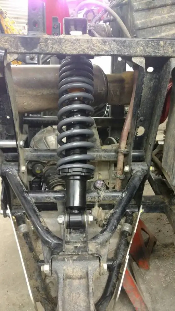

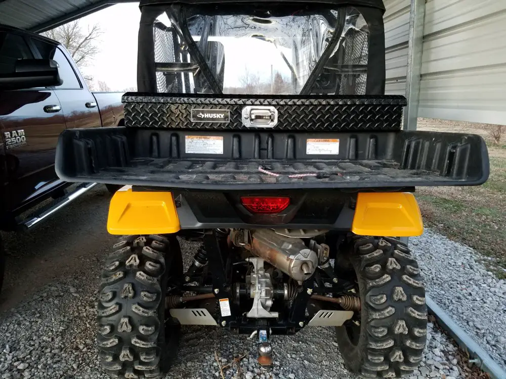

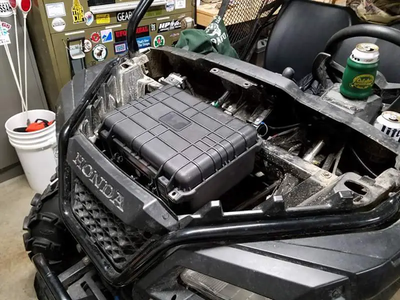

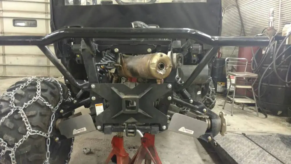

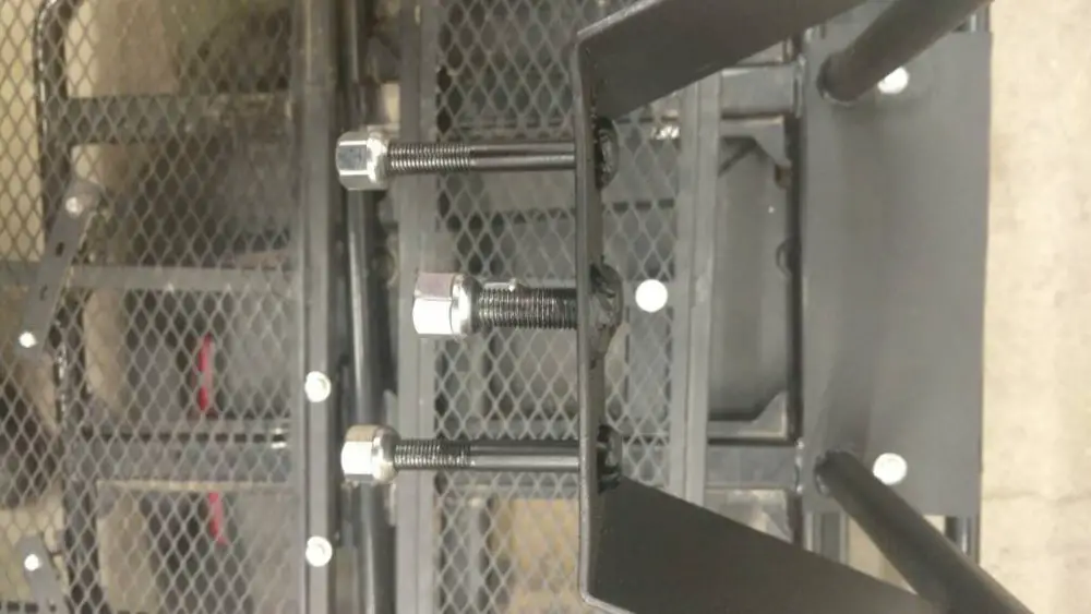

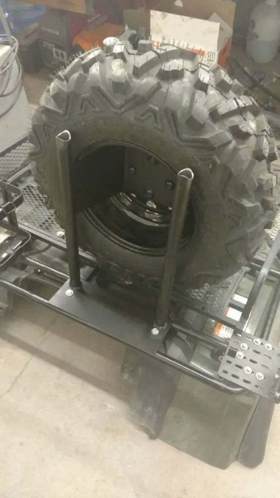

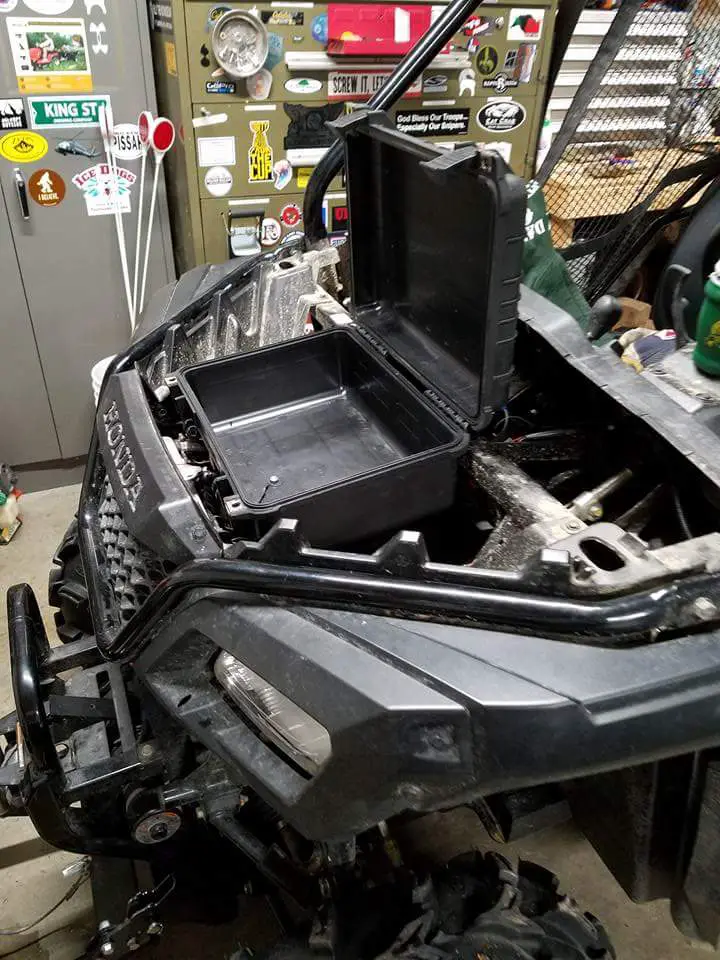

Ok finally put wheels on, shocks, frame cutting , done, no more for a while, tired, tired :)
Used existing air intake to make my own, on vacation from this weekend, will write up build, and also need to find 1.5" frame steel clamp for spare tire rack.
Few guys who came to the shop, suggested to make a tricycle :) next mod
