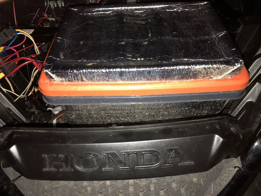

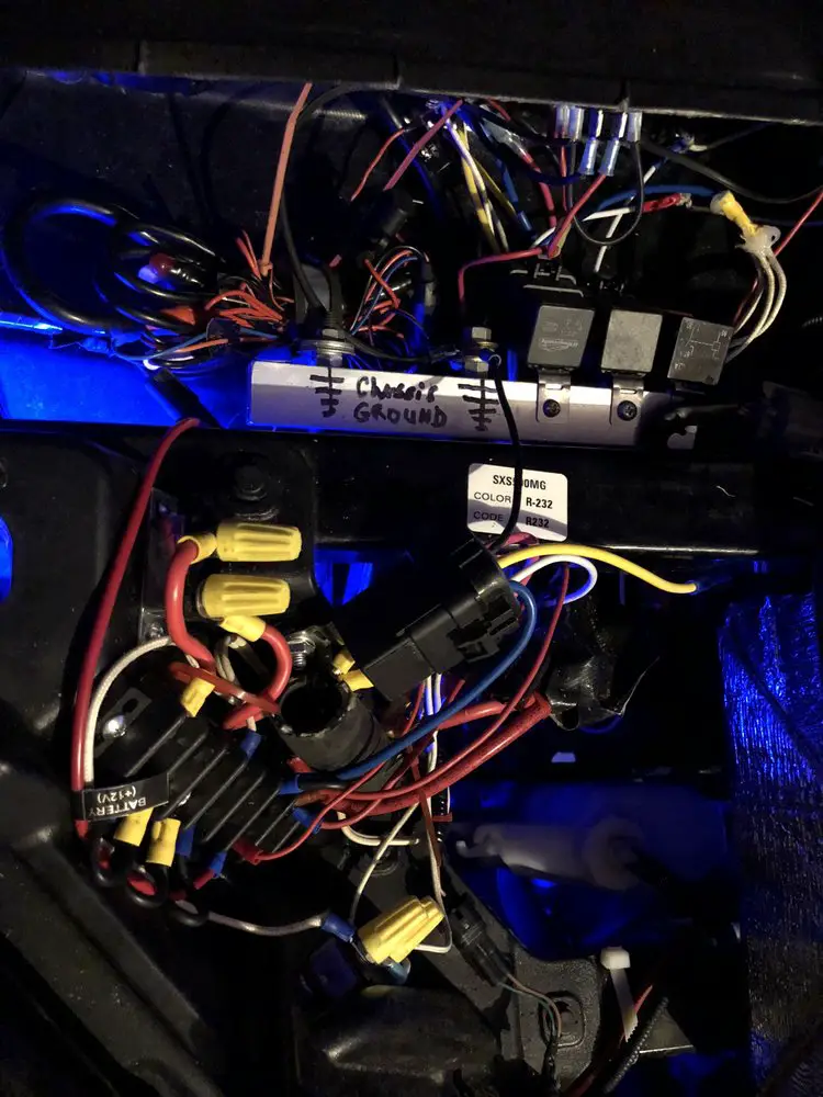

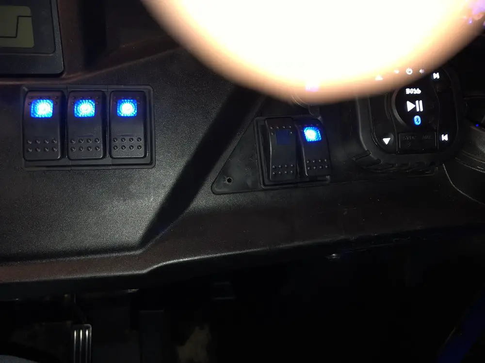

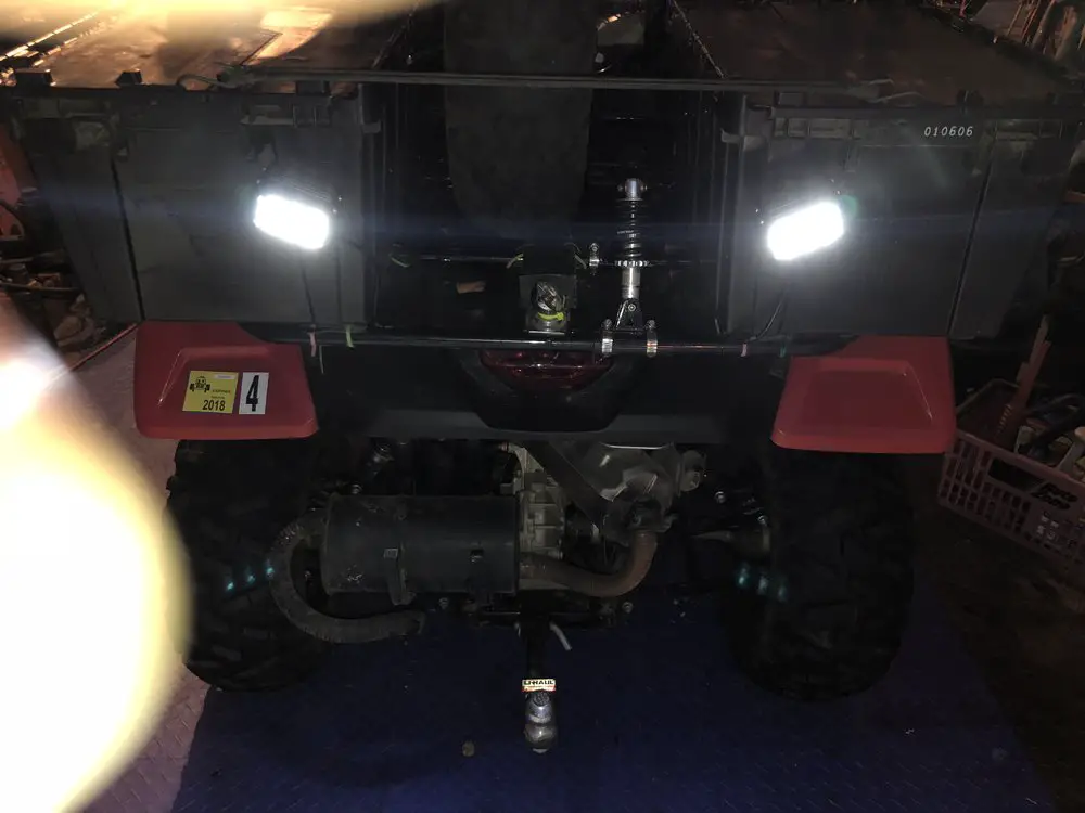

I also finished install of the accessory electrical switches, relays, and circuit breakers and fuses. Everything NOT Honda is now on a stand alone wiring setup. Soon I will add an extra battery and that will be the source for all accessory power. So here are pictures (so you all know it really happened - LOL) of the dash, relay and wiring under the hood and the previously un-shown rock lights and backup lights. The light bar on the front has been seen in a lot on my pictures before. A hidden switch under the dash and a relay kills ALL non-Honda accessory power. Individual items are fused and switched. Also included is a picture of my WallyWorld underhood storage box - I used an old windshield sun reflector to heatproof it and it is held in place with zip ties - this install and box has withstood the goat trail tipover test - CP approved. Sorry about the finger over the edge of the dash switch picture:oops:.
