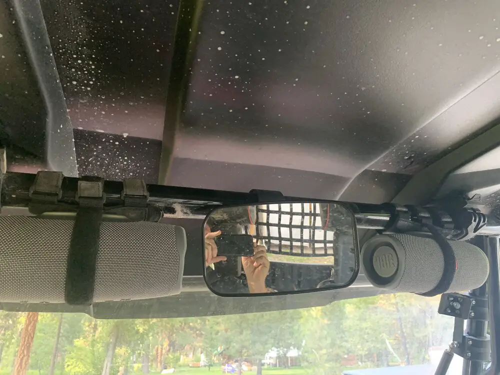

View attachment 217188Works great up to about 35mph. After that, wind noise gets a little too high. But good sound quality.
I was thinking about getting that mount for my little Boss audio portable tube radio. Do the speakers move around a lot in that thing? We ziptied her up at first but the one broke off and the speaker smacked my hubby in the head lol. good thing he had a helmet on! It was amusing to watch, I was behind him on the trail in someone else's machine

If you cinch them in tight, they stay very well. I haven't noticed any movement in them when I placed them centered and tight. And that is through some pretty rough rides.
