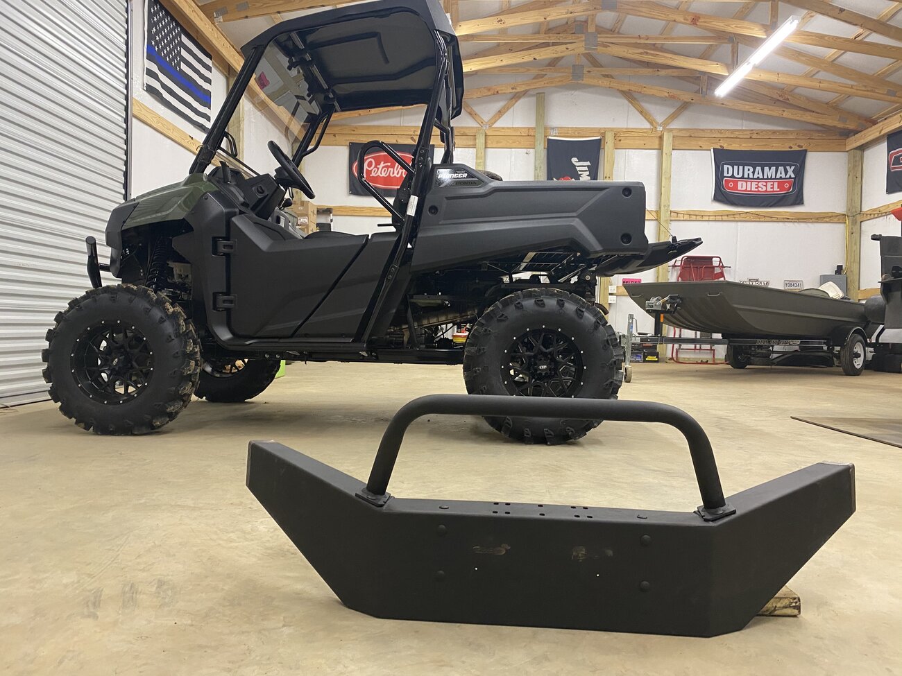

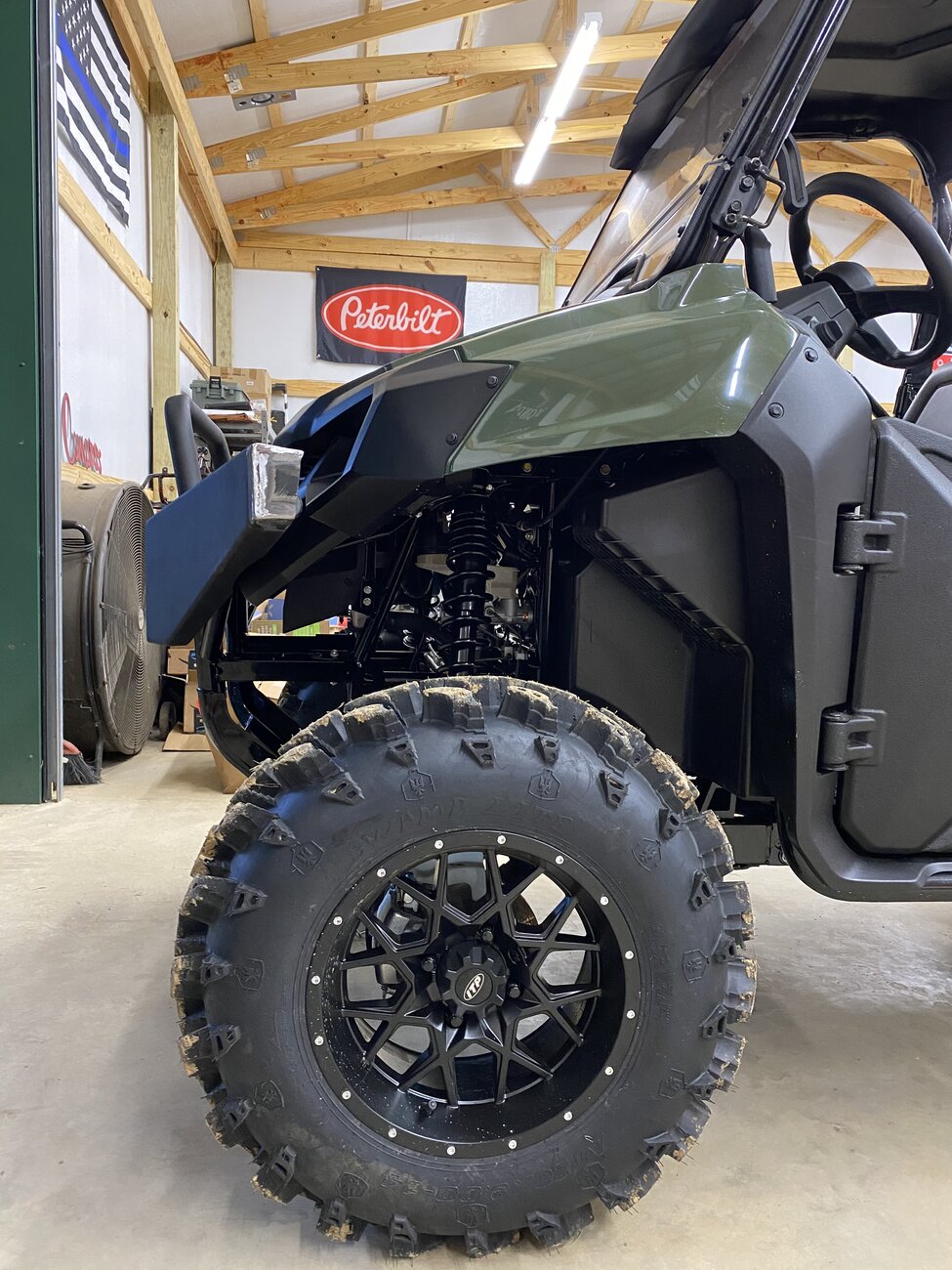

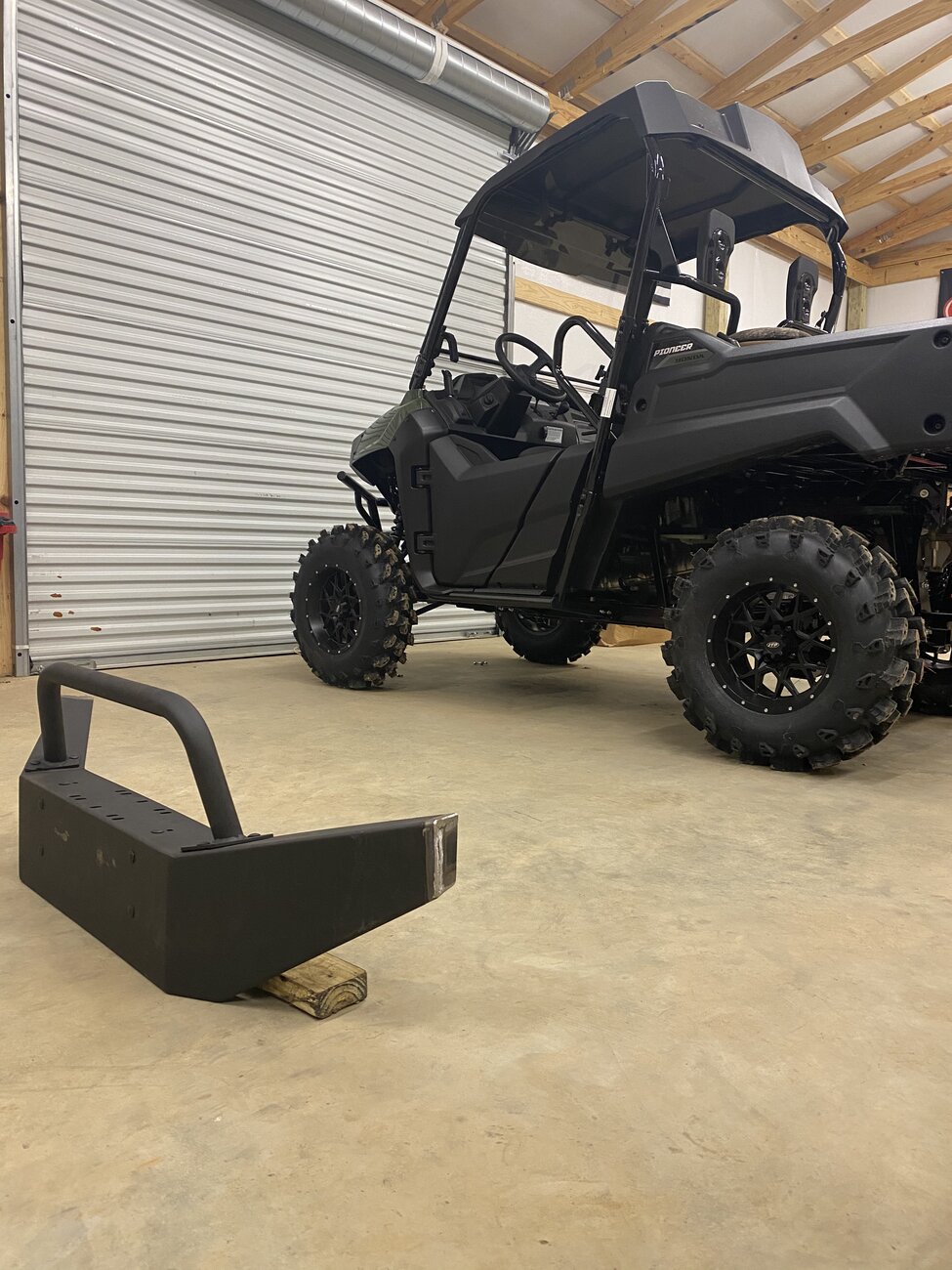

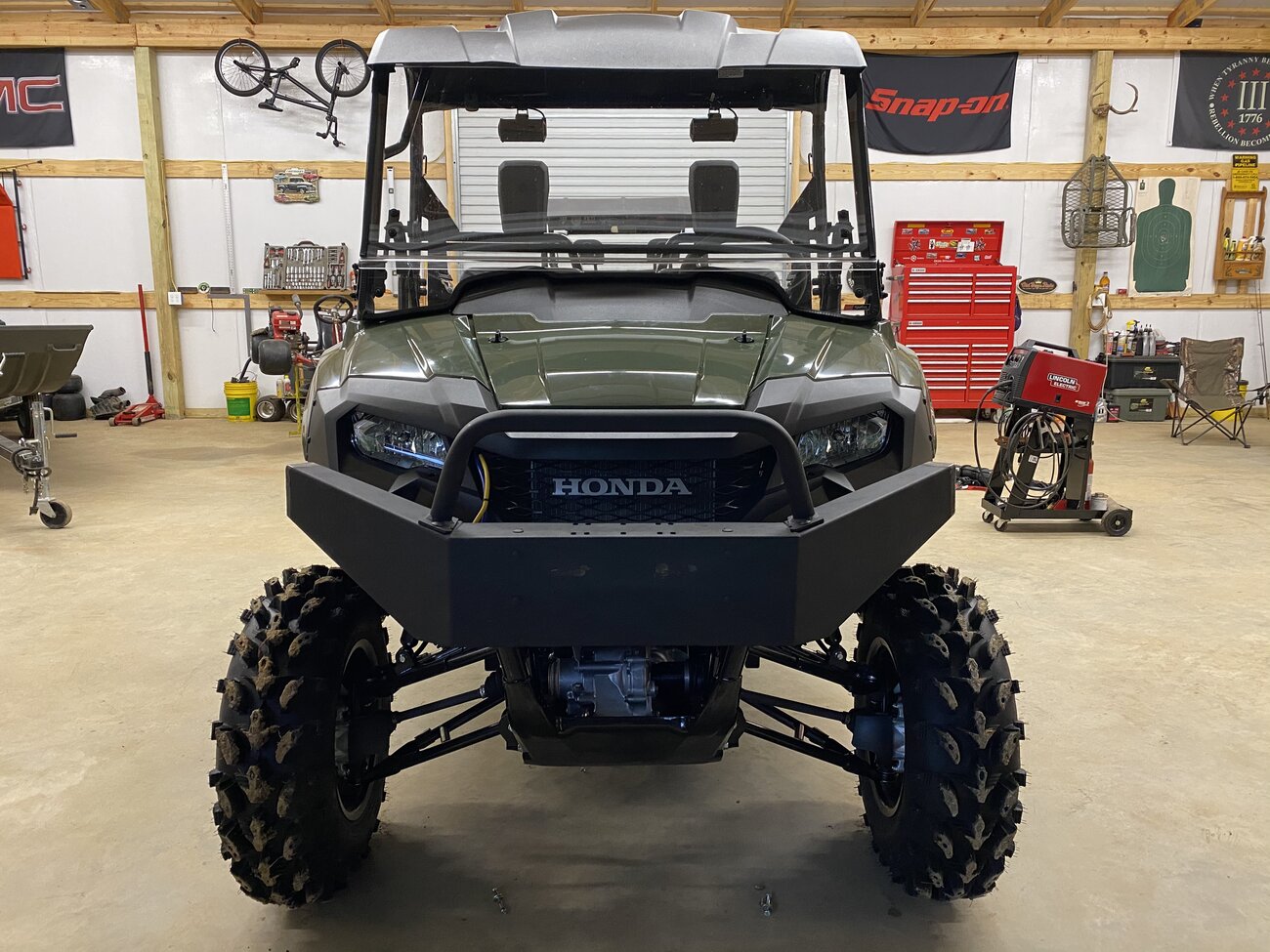

I started fabing my StrongMade front bumper. Cutting and welding their brackets to where it mounts up 1” - 2” lower than how they originally designed it to fit...which blocks lighting from the lower part of the headlights.

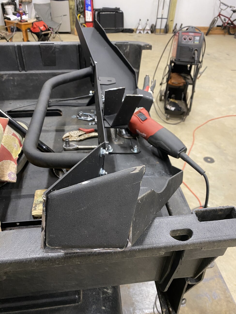

Today I got the bumper mounted enough to make more measurements on the final support brackets. Plan on getting it finished up and painted tomorrow. Starting to cut into my deer hunting time! Lol
View attachment 302913 View attachment 302914

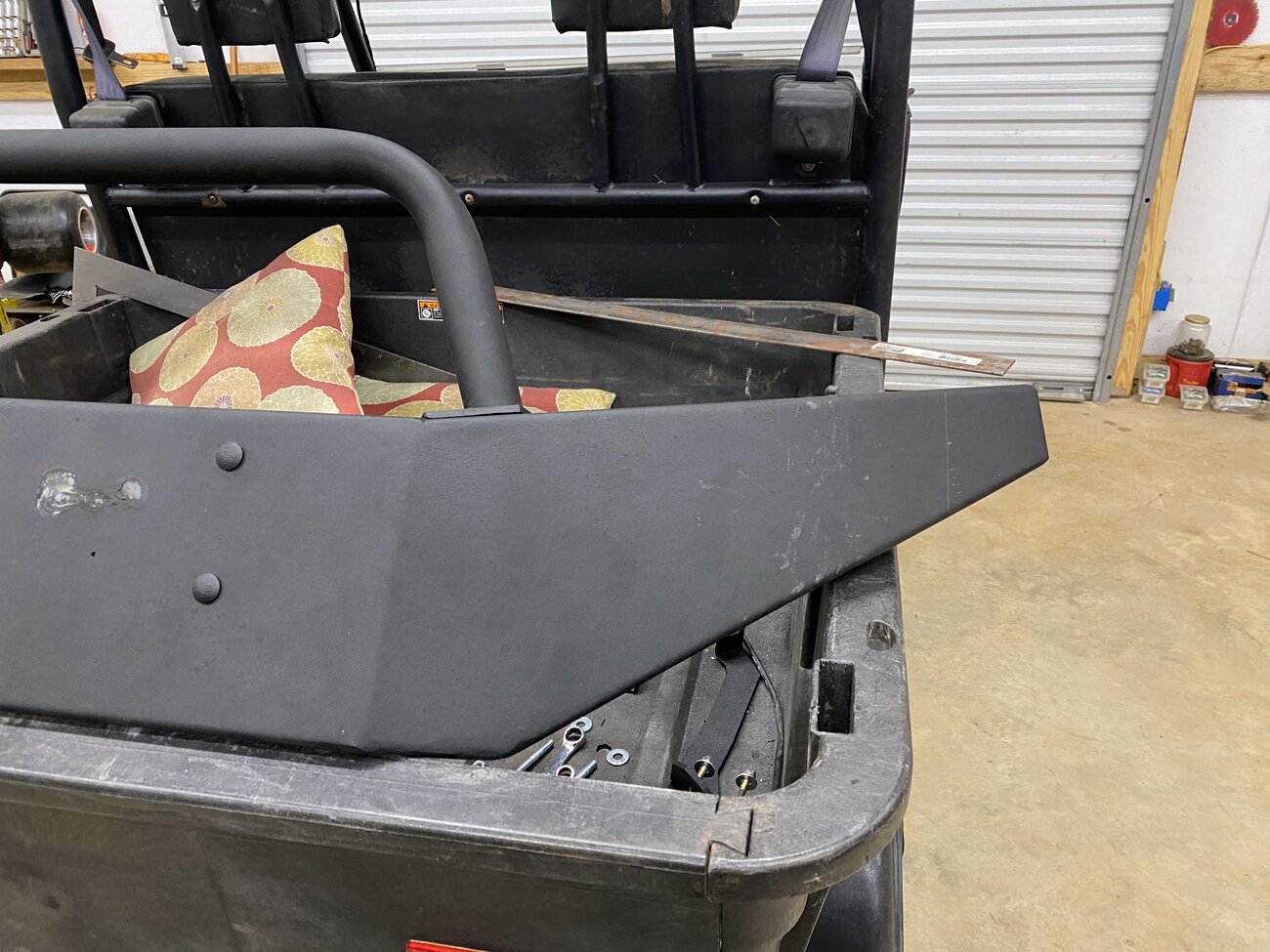

Finished the support brackets and got everything painted. Will let dry over night and a possibly get mounted up tomorrow, but may need to put another couple of coats of the 3M undercoating on the bumper.

Strong made should hire you! The only thing I would change on your version is the thickness.....it's a bit too tall/thick. But thats just me. It still looks 100 times better!
RedHammers700
RedHammers700
Oct 29, 2021
15
40
Minden, Louisiana
Thanks. I myself, didn’t like the bulkiness of it at first but now that it’s chopped down, it’s growing on me. Plus I think when I add a couple of LED flush mounts in them, it’ll fill in more.

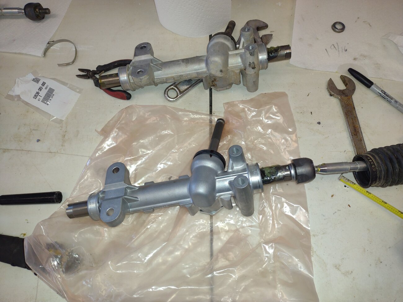

I didn't really "go out", but it had developed slop, specifically vertical movement on the driver's side...
...and you could feel it in rocky terrain and it felt clapped out. I suspect there will always be a bit of horizontal play, and even my new rack has that, but the feel of slop is gone.
