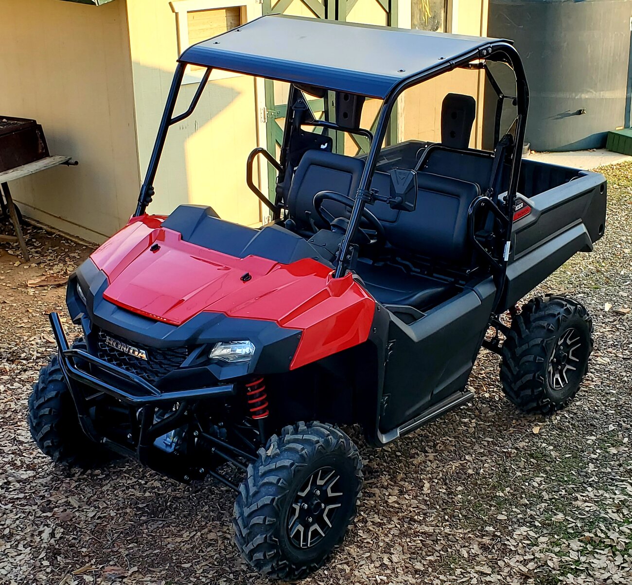

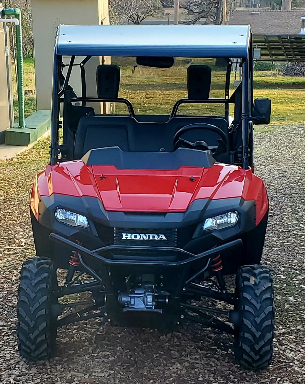

It has 7 rubber coated strap clamps with nuts and bolts. It took about 25 minutes to put it on by myself. I could probably do it in 15 minutes now. I don't plan on removing it so the clamps are fine. I really like the low profile but it does limit the type of accessory bar mount/clamps that can go under it.
That doesnt sound too bad to pull on and off twice a year. Riding in the heat of the summer with a canvas roof is much much quieter and cooler but as soon as deer season rolls in I put the hard top back on. Def like the low profile looks of the metal better

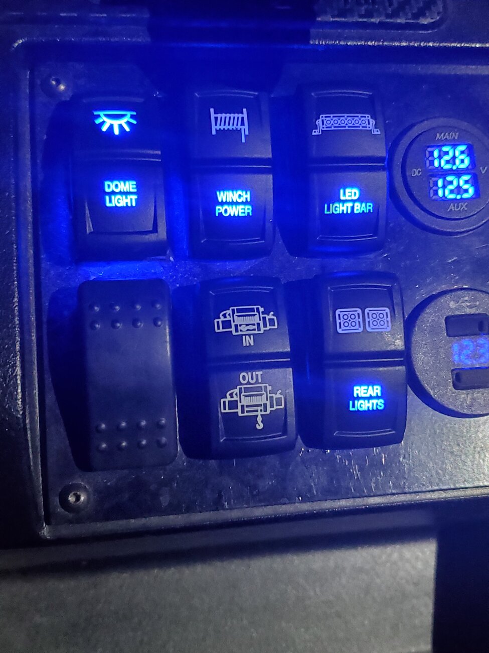

I finally got around to adding a couple of work lights facing the rear, a small light bar to the front, and changing out the headlight bulbs with Starks. This included fabing a fuse/relay panel and installing a switch panel. I'm happy with the results.

Biker,
I don't know if your roof questions was directed at me, but, EMP has a glass (DOT) one piece windshield that works with their roof. I don't know if any other windshields can be made to work or not. I would like to have a two piece flip up windshield but decided I wanted the lower profile roof more. I will probably get a windshield eventually.
