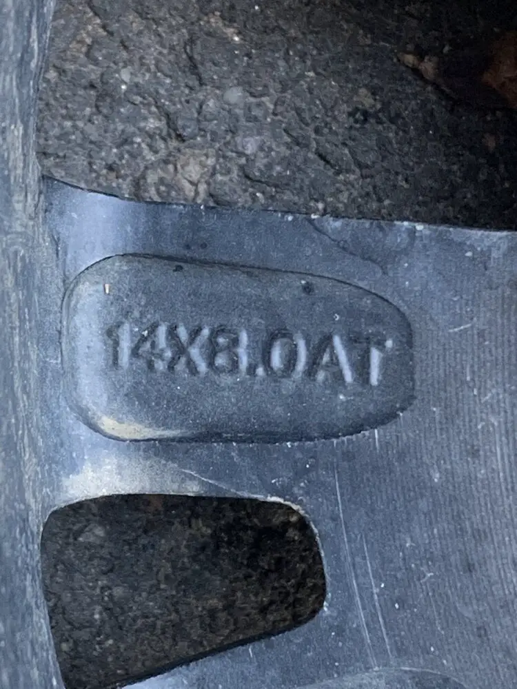

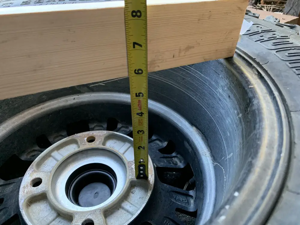

2017 Pioneer 1000 LE. What is the stock wheel offset supposed to be for front and back?
These pics are the rear stock rims. I thought they were supposed to be 14x7. Why does the rim say 14x8? The front rims say 14x6.5.
What offset are they?

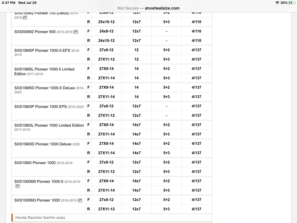

Yes it definitely matters for the machines that have the Fox shocks. The LE has Fox shocks and 14” rims. The Fox shocks have an external cylinder that interferes with the tire if you don’t have the right offset.
Not sure your offset figures are correct for stock rims. I just found this chart.
51DE6781 CDE9 455A B610 0AD0B2EA2B7F
Not sure your offset figures are correct for stock rims. I just found this chart.View attachment 215371
I'm not sure what the offset is on a stock front wheel but a 6.5 inch wide wheel cant be a 5+2.

You see my confusion! I’m not even sure those numbers stamped in the oem rims are the sizes. Nobody seems to know what the oem offset is. How is everyone buying aftermarket rims if they don’t know what they have on it now?
I do know its the size. 14 inch diameter and the 2nd number is the the width. Fronts are 6.5 inches and the rear is 8 inches.
