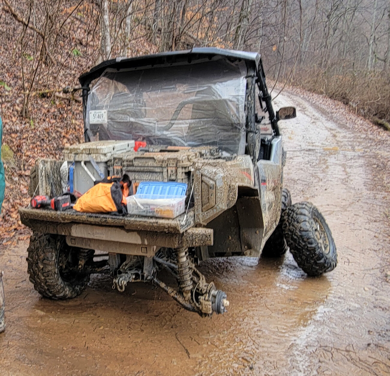

Pfffft. All this talk about checking lugnuts, using loctite, and quality spacers is overrated 🤣
20240127 143443
Actually I did check lugnuts and used loctite. I think the problem was crappy spacers. 🤦‍♂️ I've now upgraded to @RB3offroad spacers 👍
