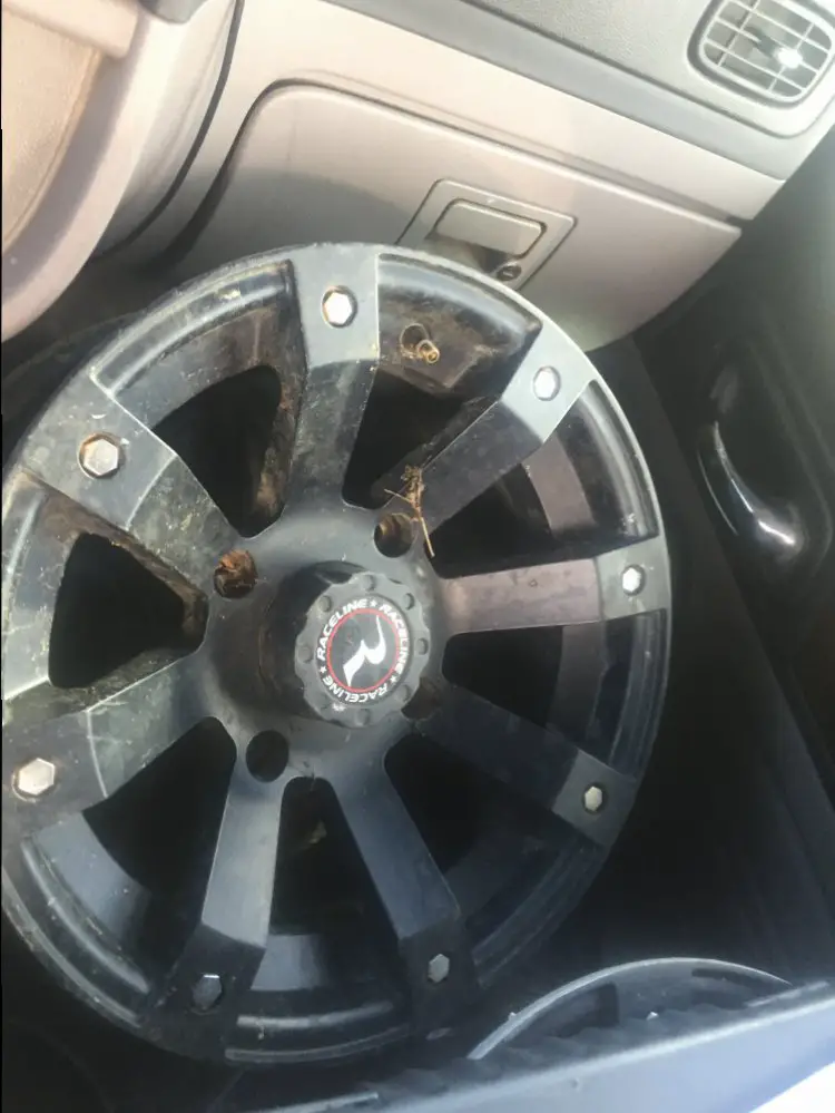

I stumbled across some free99 rims this afternoon ! Ultimate score

Nobody's - my buddy bought a set of 34.5 outlaws cheap last spring from a guy who was in a bind. He used the laws on his ranger and tossed the rims out beside his shop as they did not fit anything he had. Lucky me they just so happen to be 4x137 can am rims that are the same as our new P1K
Cool let us know what will fit ... Are you in yours yet? Tires to machine I mean
