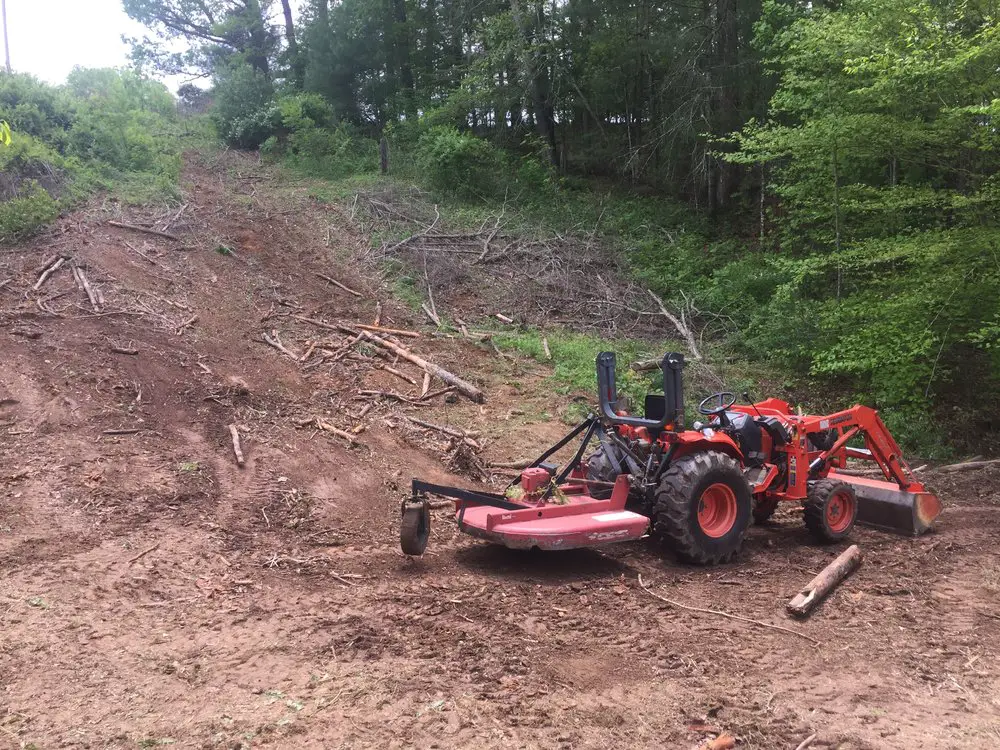

Totally understand. I actually have a Warn VL 10,000 on my truck. Only used it a small number of times but when I did, it was great to have it. No better way to pull a dead tractor from a ditch. I just don't know squat about UTV applications or products. This forum is a blessing and a curse. Blessing for the help, ideas and inspiration and a curse because I just keep seeing more things I want to do. Lol.
My daily driver...

There's enough guys here...
that will share there knowledge. .
ideas...
