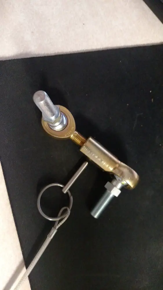

Are you going to do just one disconnect? If you used two disconnects, what do you do with the sway bar?
Going to try 1 side first. Don't know if the free end will hit the a arms. Do have joints for both sides. Not in a big hurry to do it. Mine does pretty good without the swaybar. Would be nice to have it in certain situations.

Looks like the sway bar disconnects will not work without modification. Either shorten the swaybar 2.5" and use stock mounts or pivot it up and mount to the top a arm. Both sides will have to be disconnected. Not enough clearance between the a arms for full travel without hitting. It will have to be rotated up to the frame to tie it off, which there is plenty of clearance for it. I also have the SATV arms so I might have a little more clearance. Don't think I would mount to the top of a stock arm, might fold it.
