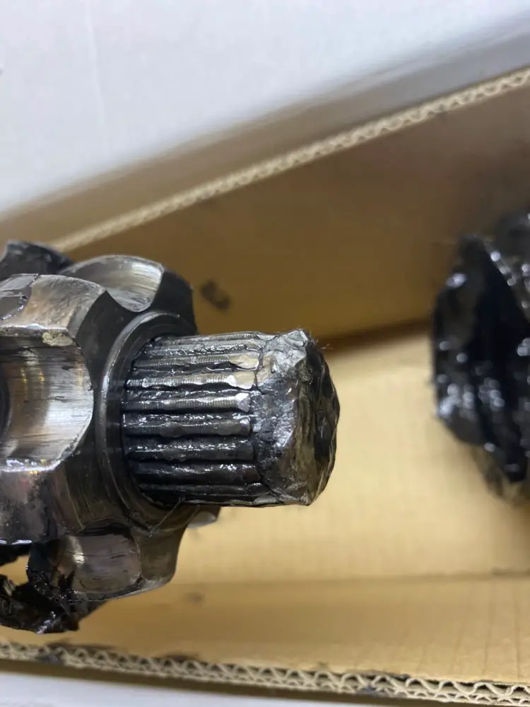

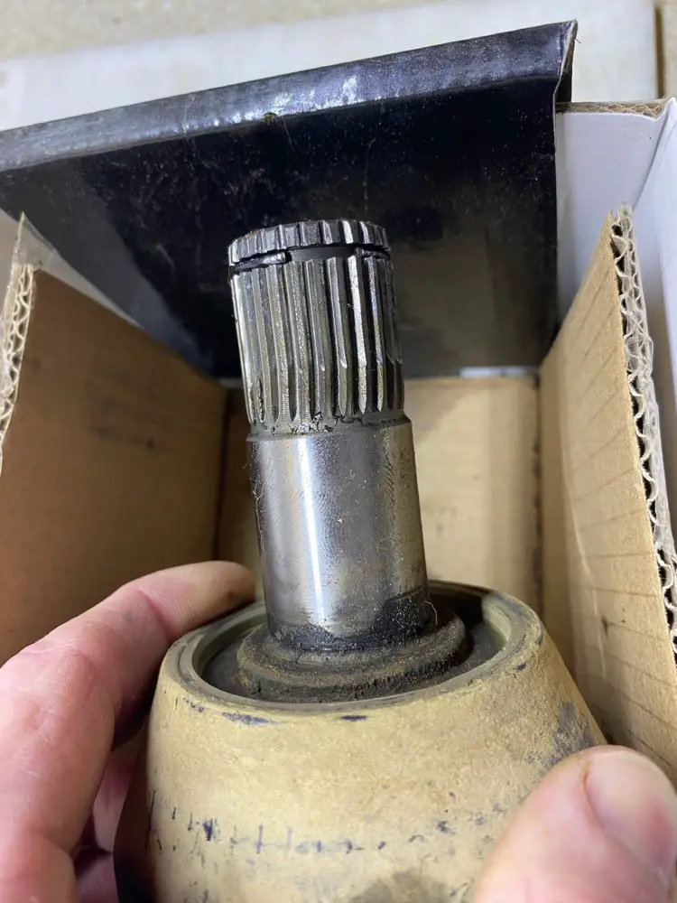

Passenger front SATV 2.0 axle from our AR ride. Blew the outer CV and twisted the splines in the diff.
Looks like you lost your balls.

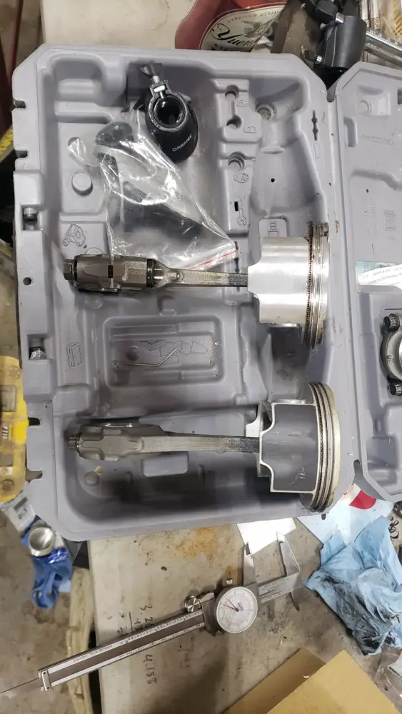

Weight the same just in different spot?A big difference in the pioneer vs talon rod and piston. Cap screw vs bolt, the rod is thicker but a touch less wide, talon piston has an anti friction coating on the skirts. The talon wrist pin is tapered, a lot bigger id/od at the end and smaller in the id. The oil ring is thinner. All else looks similar. The cap screw design is the biggest benefit for more reliable power.
I havent weighed them yet.Weight the same just in different spot?

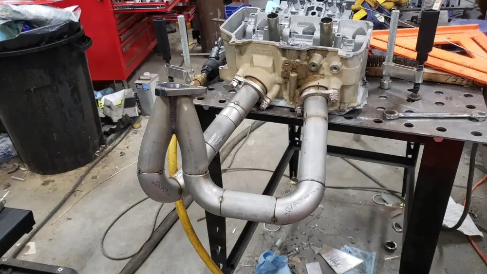

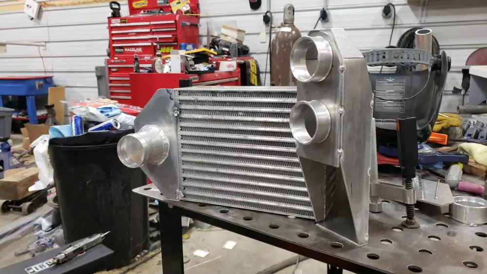

Can I come play for awhile?Couple of photos of my current project...
Nice ,Looks good !! Think the butt fan will help that turbo turn any faster bahhahahahCouple of photos of my current project...
What size tubing are you using?Couple of photos of my current project...
The engine is fairly clean. I think it's permanently mud colored now haha.Couple things really stand out. Those pipes are bent, and WASH THAT ENGINE!![]()
Thanks but I already have all the tubing needed to wrap it up.What size tubing are you using?
Header and/or planned intercooler sizes?
I'll check my stainless scrap bin. Might be able to send you a box of stuff.
Let me know when you do the 2nd one. I have a 30yard bin full of 1d bends. All 304 .065w stuff.Thanks but I already have all the tubing needed to wrap it up.
I used 321ss - 0.109" wall on the header. Should be good with it glowing bright red haha.Let me know when you do the 2nd one. I have a 30yard bin full of 1d bends. All 304 .065w stuff.
I will consider that.You putting a blast shield between your ass and the engine?
