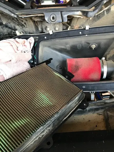

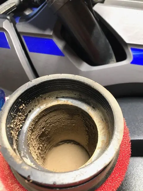

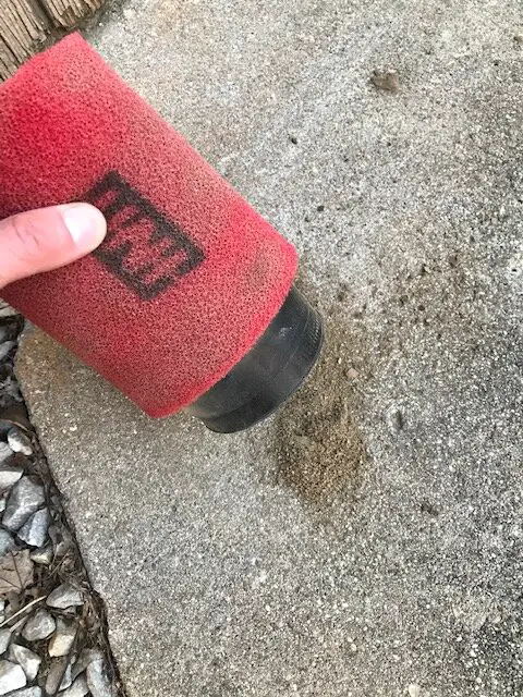

Back towards the end of summer I replaced the stock air filter and put the UNI on the inside of the Airbox and rode about 400 miles or so on 3 trips. Last week as you can see from my post, I did the mod to put the air intake up high like others have done. So this weekend I decided to take the Uni out from the inside thinking my air filter would be nice and clean. Wrong, dead wrong.
Now a few things.
1. I didn't oil the UNI enough. That is obvious.
2. Of the 3 trips I took, two were dust bowl trips.
But as you can see from the pictures, you could dip the filter in oil and it wouldn't help keep all that dirt from coming inside. So if you ride in dusty conditions think hard about doing the mod to put your air intake up behind the passenger seat. Or, take the air filter out and clean the UNI after every dusty ride. I'll say it again, the stock air intake location sucks. Sucks dirt to be exact!

Damn, what a mess!!! :oops: I can't believe your stock filter got that dirty. How did all that dirt get through the Uni? (however lightly oiled) I didn't realize the internal Uni contacted the stock filter.
For the curious, Phil copied HondaBob's snorkel idea for the most part but stopped behind the passenger seat (Bob runs his up to the roof). Those details are linked in my sig, posts 18 & 19.
Very much like this but he used a K&N with a plastic bucket over it for waterproofing. I believe the K&N wasn't in place yet for the mess above.

That Uni collected a lot of dirt, oiled or not. It's that much that didn't get to the Honda filter. I'm surprised it didn't get sucked off of the very flexible inlet tube. I think the biggest advantage to the external snorkel is the ease of inspection and cleaning. Hidden in the air box, it's a lot of work just to see if it needs cleaning.

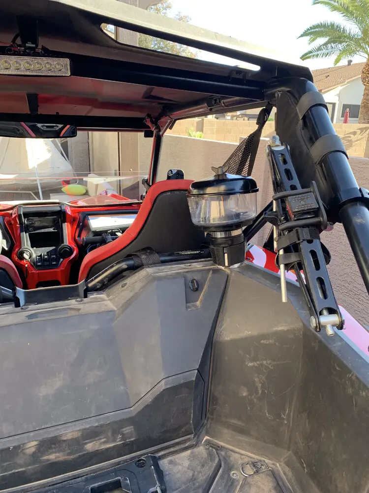

Went with set up and cost about $40. I call it a poor mans particle seperator
Nice set up! Please post the part number for the particle separator you have on top. Also, does it filter out dirt and dust with a filter you can clean? I've seen a few of those on line, but I'm not familiar with how they work.

I have a RC2 filter as you can vacuum/ air blow the filter but i definitely recommend it as last trip i was amazed on how much dirt it collected
