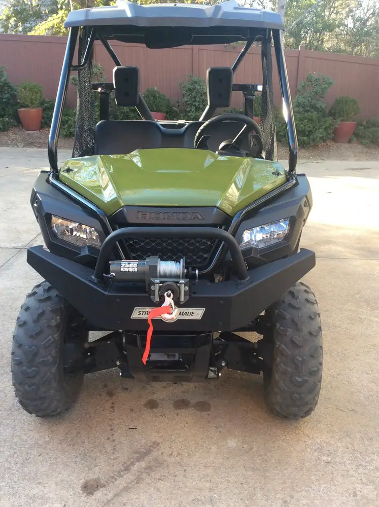

Pleased with the Strongmade bumper, not worried about bumping trees, the upper bar is a good handhold if you're in the mud winching out, and looks good from behind the wheel.
