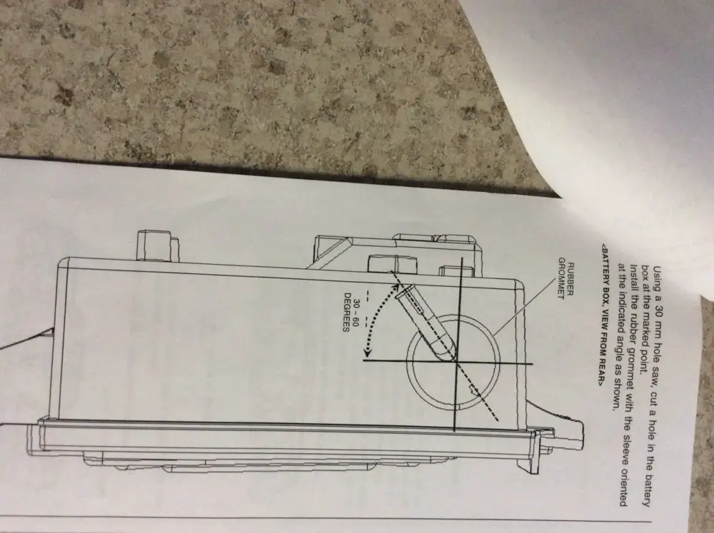

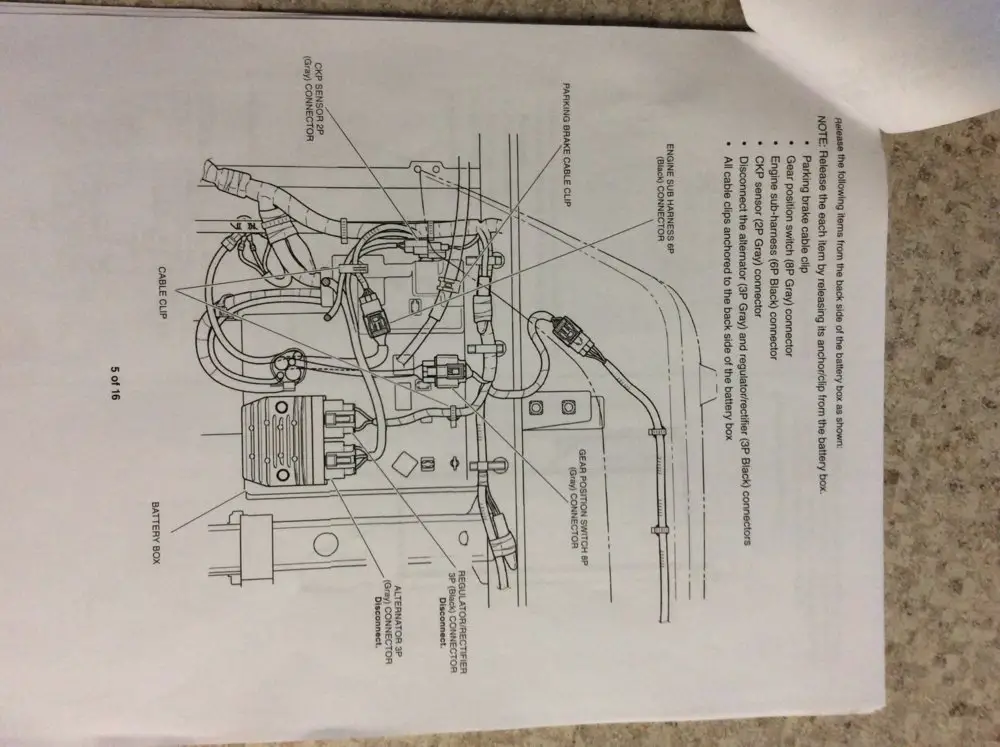

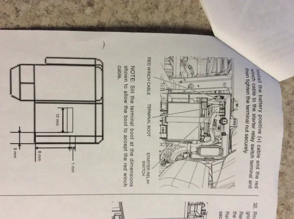

I am getting ready to install the Warn Winch on my 500 that was thrown in as a inducement to buy.
My concern is that according to the instructions I have to literally "gut" the battery box in order to run the hot cable to the starter relay switch. Is there a easier way ? I have installed winches on Foremans before and it never was this complicated. Thanks in advance.

Without "gutting" the battery box I installed a winch and a dual battery setup which required running four 6 gauge + and - cables into the OEM box as well as a sizeable 100 amp circuit breaker, no worries.

Just run the hot and ground leads to the battery. Have to get a little creative with the routing in the box to get the cover back on.

You can do it without taking the battery box off the machine. Just remove the battery, slip the starter relay off the mounting tabs, unbolt the battery box, unclip the cable guide on the backside (allows the box to be tipped out ) , and then you can safely drill the hole on the side of the battery box. When drilling with the hole saw, just be careful to not push it thru too hard and watch from the inside of the battery box as the hole saw is slowly coming thru. That way you won't get into the starter relay mounting tab and break it.
But to route the positive lead as per instructions, it's best to remove the rear fenders/rack assy. and slip the air box off the throttle body.

It's not even necessary, zip tied very tightly together, I ran all my cables (for dual battery, winch, etc.) right up through the channel on the box that the OEM cables exit at. Looks clean and tight, and all I had to do was remove the cover and replace it.
Installed my 6 ga to front, able to fit in battery box, noticed the box has openings in back,so it is not totally sealed. removed skid pans which made it much easier. Used split wire protection, tied to existing harness for routing to keep clearance from rubs, Bussman waterproof switchable breaker. Badland winch on Strongmade bumper on P500. Bought 10 ft of wire.
