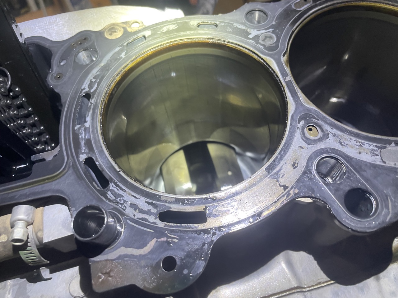

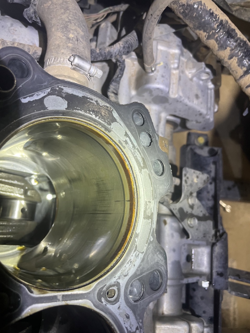

Every Talon engine I've seen (boosted or N/A) looks like that. Always scuffed on the thrust surface of the cylinders.
Do yourself a favor and don't use a ball hone. They don't do a very good job of keeping the cylinder walls straight and leave lots of trash in the engine. Grab a 3 stone cylinder hone from your local parts store and use thst instead.
Can you explain why the bar stone vs ball? I’ve been told to use a ball hone because it’s Nikasil.

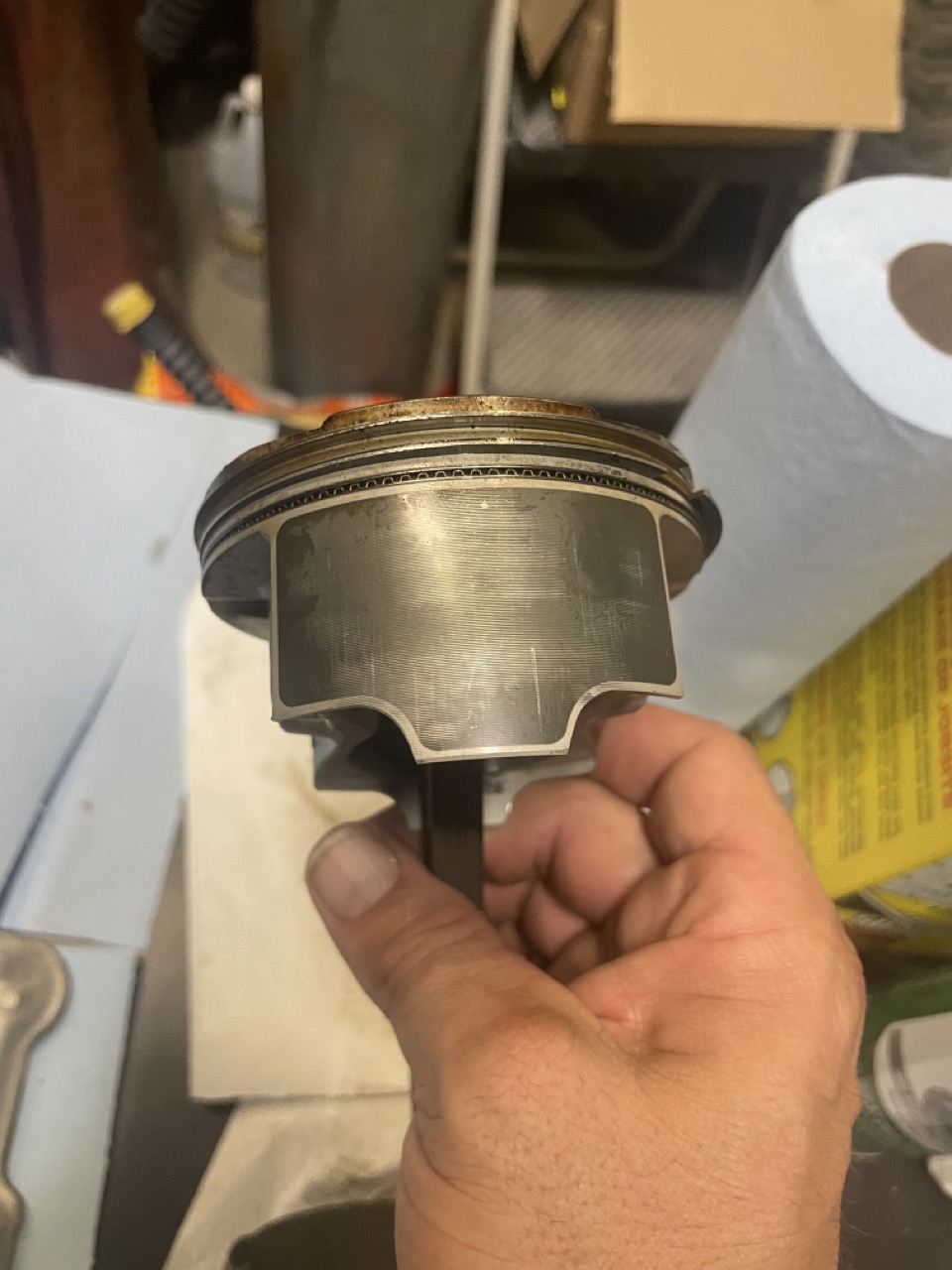

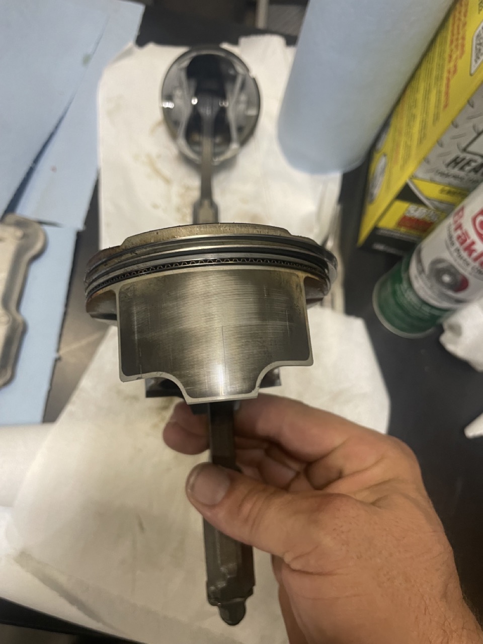

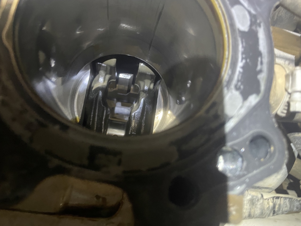

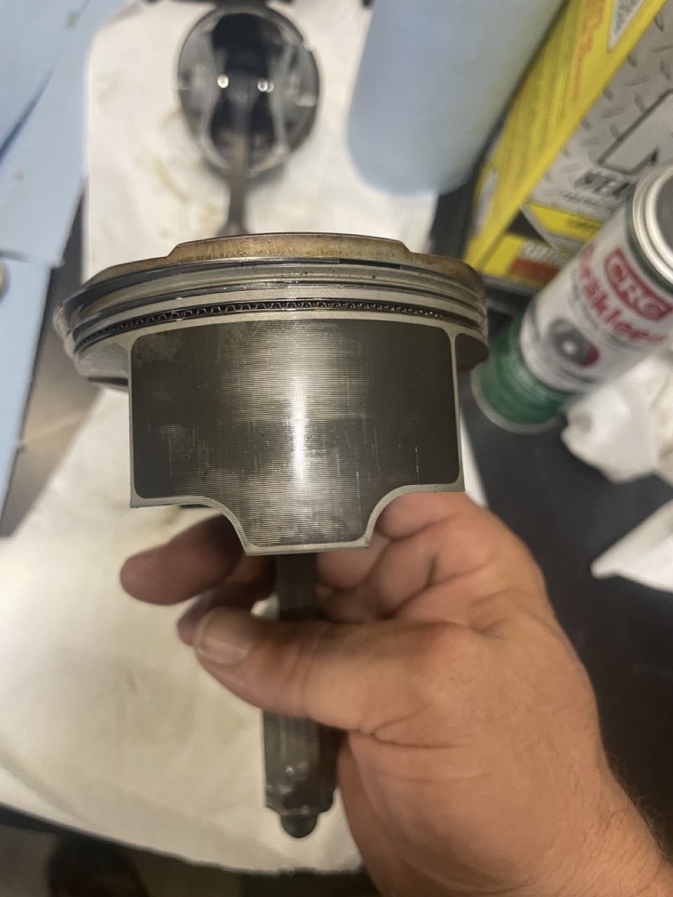

No cracked piston skirts, everyone told me they would be cracked. i have over 4K miles boosted. 7800 miles total on machine. kinda frustrating spending the money on pistons and teardown when it wasnt really needed. oh well.
the scratches in the cylinders i'm sure is from when the stock JR air filter let some dust by,
it looks like some minor dust is still getting by but the whole intake track is clean no dust to be found. so i'm not sure what to make of that. i'll get a ball hone and hone the cylinder best i can, and put things together with new pistons.
View attachment 362597View attachment 362599View attachment 362600View attachment 362601^^^ this is the only one with a groove enough to feel with a finger nail. dispite some others looking much worse. View attachment 362602View attachment 362603View attachment 362604

Pretty good for the miles
We cracked ours after just a few races on the JR kit. But one of them was a 10 hour endurance race and my GM isn't light on the skinny pedal.
I was told that by sombody who knows alot more about these Honda engines than I do and has been inside a bunch of them.
Sombody also told me that the cylinders are not plated and that there is a thin sleeve pressed in. I honestly have no idea if this is true or false but it's what I was told.
Can you stick a small magnet on the cylinder wall to see if it sticks? I'm assuming Nikasil wouldn't be magnetic?
magnet sticks. but that doesn't mean it' not nikasil coated does it?

Nikasil is slightly magnetic. I know the pioneer had a cast iron sleeve and sell oem over size pistons.

I dont believe the cylinders are plated. Our last set of cases had sleeves installed and bored to match the pistons.
That's the route I'm going.
When my cylinders were measured after a single season of racing they were hourglass shaped and honing wasn't fixing it.

Ball hone is fine as long as ur just trying to get a cross hatch vs trying to true up a cylinder.
Most likely the cylinder is not true and would benefit from a stone hone. Ball hones just add to the problem.
