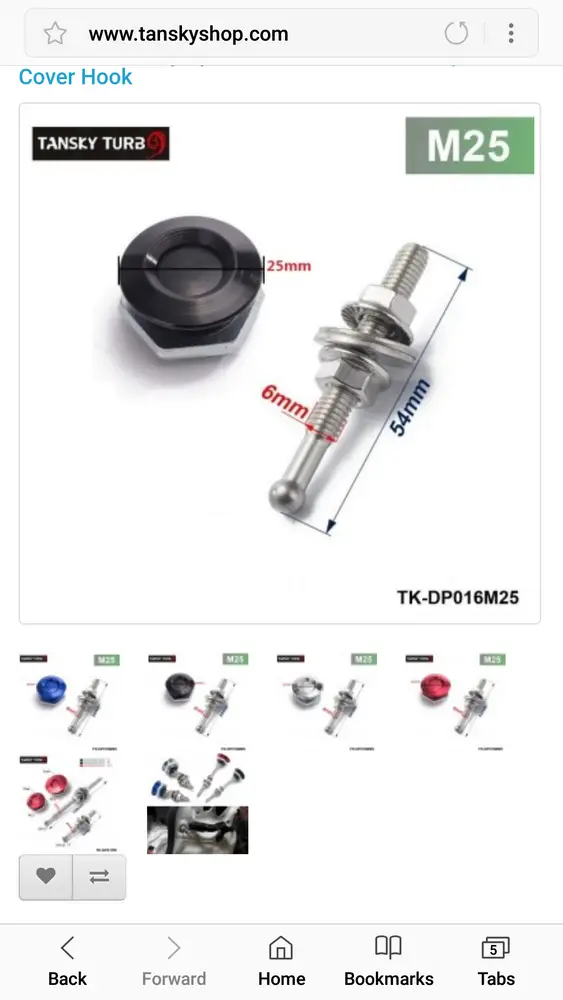

Didn't see it on website what's threadOnly on the passenger side. The holes were off from the factory. Took a little bit to get it where i was happy. Driver side took about 5 min.
TANSKY -1" Universal Aluminum Quick Latch Push Button Billet Hood Pins Lock Clip For VW Golf TK-DP016M-25Didn't see it on website what's thread
I've looked twice .Maybe I'm blind but are m6 ,1/4-20, 3/8-16 What ?http://www.tanskyshop.com/25mm Universal Aluminum Quick Latch Push Button Billet Hood Pins Lock Clip For VW Golf TK-DP016M-25
I never clicked on pick was looking at dis.

I dont know why it wont work right...but when you click the link and it goes to the page there is a blue continue button..click it and then scroll down they are the 1" billet latches
Yes..they are 6mm. The stud is a little to long. I ran a tap through the plastic behind the threaded insert and just ran the whole thing in there.@GlockMeister do these thread into factory holes without modification![]()
I just used my pocke knife to cut our enough for it to fit. These are 25mm were yours are 31 i believe..so thes will fit down in there a little farther.Sweet... Did you have to take off extra material from the back side of the panel hole taper? Or was drilling the 3/4 hole suffecient? I couldn’t tell if I’d have to remove a little extra to get the latch nut threaded.
Yep..2 bucks a piece..i paid extra for express shipping..i spent 28 on shipping and 20 on latches lol. But i found these exact same ones on amazon for 12.80 a piece..so still worh itDid these slowboat from China too?
