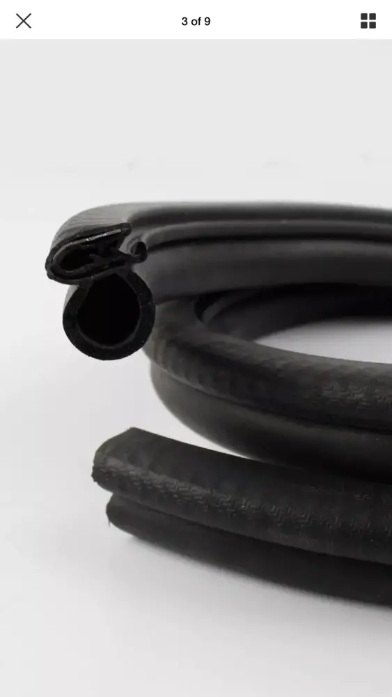

I found this it automotive door and window weather stripping. Thoughts? Of course if doors leak anyway a weather proof bag wood be best.
I like, I want to try and find something that will go around the edge of the cutout -to help with the seal and to smooth out the cut. I still plan on using a dry bag I am trying the seal mainly to try and stop as much dust as possible going in the hole
