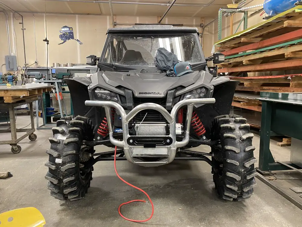

I've got a set of 28" interco snipers on system 3 beadlocks. I bought them for an area I ride that has lots of gravel/dirt seasonal roads and pavement between areas. I dont need my 32's riding this area,and dont want to wear them out on pavement. it's more high speed rally type riding with whoops and occasional muddy washouts. The snipers have been outstanding, machine goes where you point it, with lots of traction on the loose gravel. I've got about 250 miles on them. When these wear out, I'm going to stud them for winter lake racing and buy a set in 30". 1b56e617a33dd8b42aa0903836c856ba4ab3b834afa5f6b5aeb3b0d237bfda2c

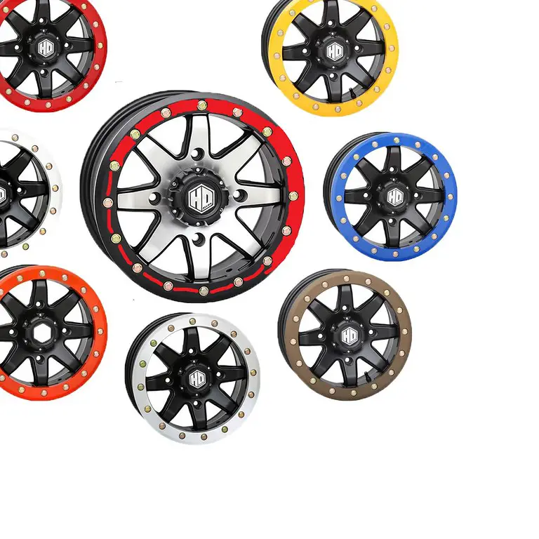

I'm about to buy the HD9 wheels for my Talon and know nothing about beadlocks other than the idea behind them. Can I mount my own tires 'easily' with beadlocks (does one bead remove)? Someone suggested RTV as a bead sealer but I'm concerned about it skimming over before I can get the bead tightened - is there a 'real' bead sealer that won't skim over before tightened? Redundant question - will the bead sealer pretty much solve the 'beadlock leak' ?
fwiw: although I'm competent mechanically, I'm north of 70 and don't enjoy constant maintenance anymore, I just wanna ride (why I bought a Honda). A perpetually leaking set of wheels will eventually 'catch me out' and I'd like for that to NOT happen. (yes, I carry a pump)

Yes they do, that is what i'm running because i don't want to run wheel spacers.
Neither do I. I stopped in the dealer yesterday and he can get me the HD9s at a good price so I ordered a set - 2 are in stock, 2 are back ordered. Hopefully this won't turn into a 'can't get 'em, no idea when they'll ship' situation. :oops: My stock tires are about done, I can't wait long. :eek:
I went with the center wheel (polished spokes) but black bead lock rings. I wanted red rings (and why they're crudely MS Painted) but those rings are only available in 14". I tried emailing STI twice about getting red on 15" rings but no reply. At some point I might get them done locally. Anyone know if aluminum can be powder coated - I thought that was a magnetic process of some sort? Or can aluminum be 'charged' to hold the powder?
Good choice, Great looking wheel.
