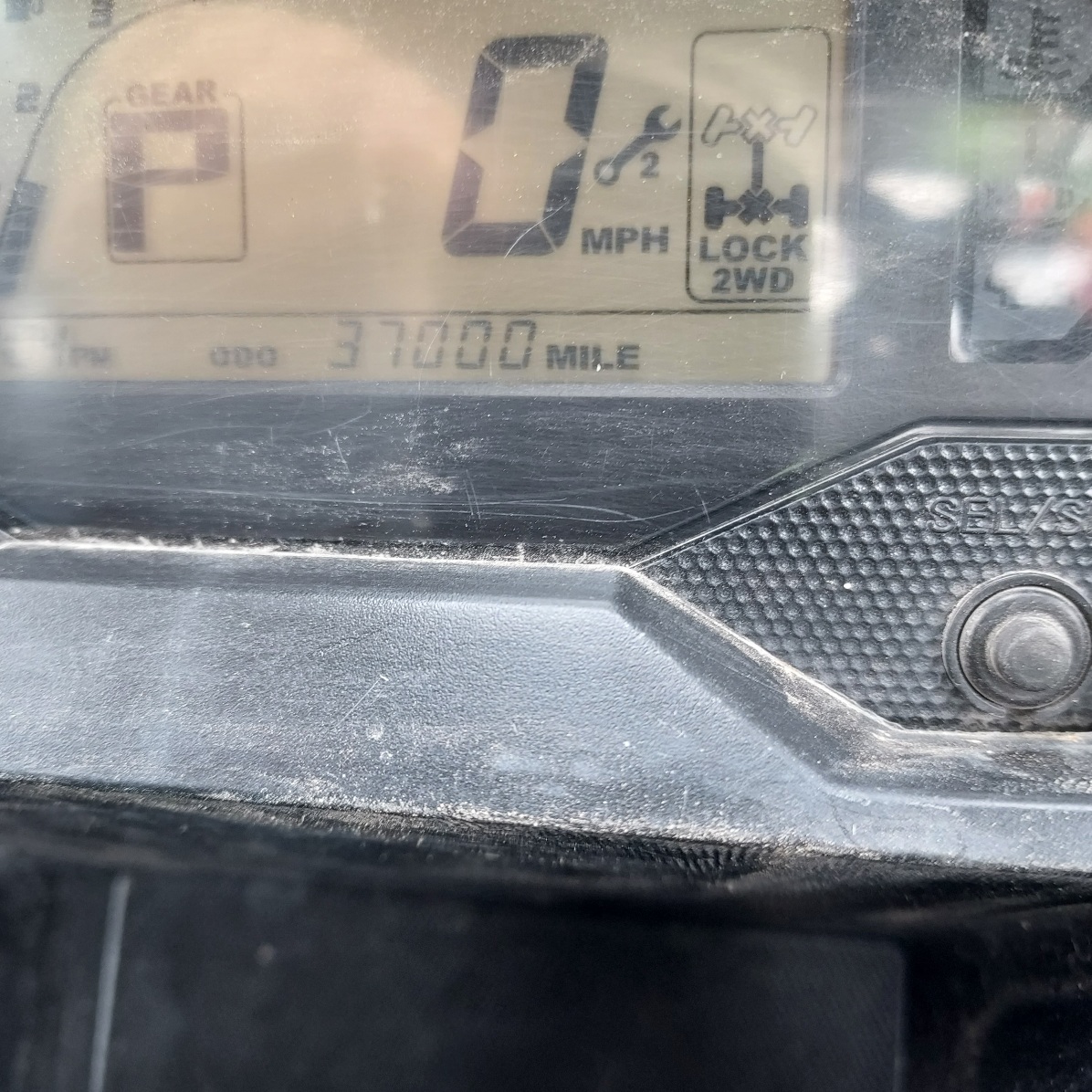

Still runs like new. The sub trans started shifting better after around 15,000 miles. My 2020 Talon doesn't shift as good when cold but it only has a bit over 7,000 miles. I check the coolant level at every oil change and the battery terminals every 3,000 miles. Its important to check the suspension for play at the oil changes. I remove the skid plates for cleanup and inspect the coolant hoses, wire harness, drive shaft U-joints, and brake lines every other oil change. I still get the rear axle click on turns when cold but ok after a warmup period when the grease liquifies.
37000miles
