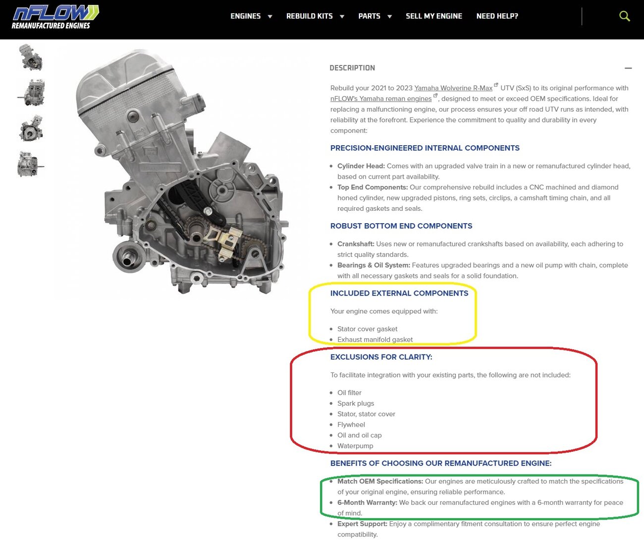

Well after 2 years and 4 months with 4600 miles on the RMAX, the engine started making BAAAAD noises. Did a compression check and left cyl was at 80 psi and right cyl at 40 psi. they are supposed to be at 115 psi. Decided to let dealer look into it since I haven't rebuilt a Honda engine since 1989 when I stopped racing ATV's (much simpler times). Anyhoo got call from the shop to come see the issues. Right rod bearing was coming apart debris in oils screen, etc. cylinder scored slightly, cam showed odd wear, if I went with their recommendations repair bill would be about $9,300 🥲
I talked with mechanic who said he has rebuilt about 9 of these exact engines all from being (ab)used as rentals at Windrock Park, all were rebuilt with approx. 3K miles on them. He said other than the internal damage he noted how clean my entire CVT system was stating no sign of wear which he was surprised for the miles I had on the machine. I asked about nFlow remanufactured engines out of Evansville, IN and they have used them before with good results.
nFlow will remanufacture the RMAX engine for $3995 shipping both ways, 3 week turn around time, and included and a 6 month engine warranty. Decided to go that route and save $4K.

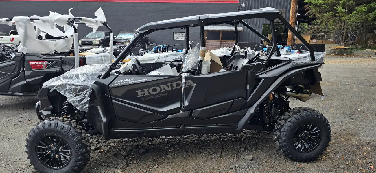

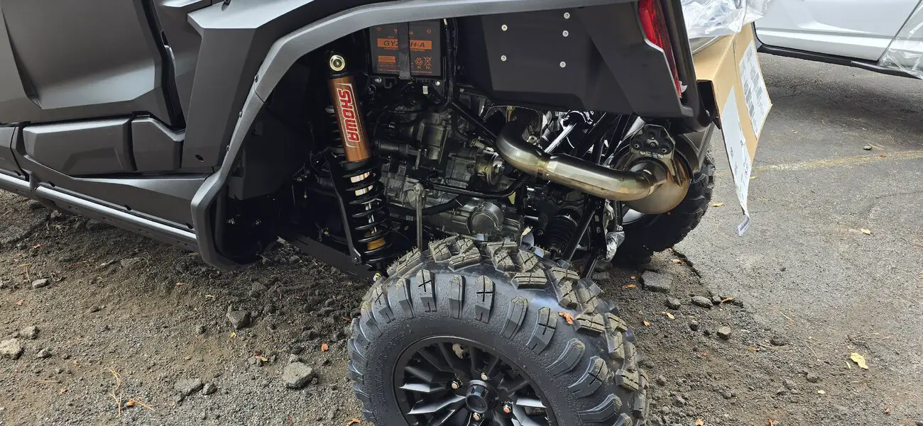

Well all good things must come to and end, after 4445 miles in 30 months, traded the RMAX4 1000 XT-R in today for the Talon 1000X-4.
20241105 084142
