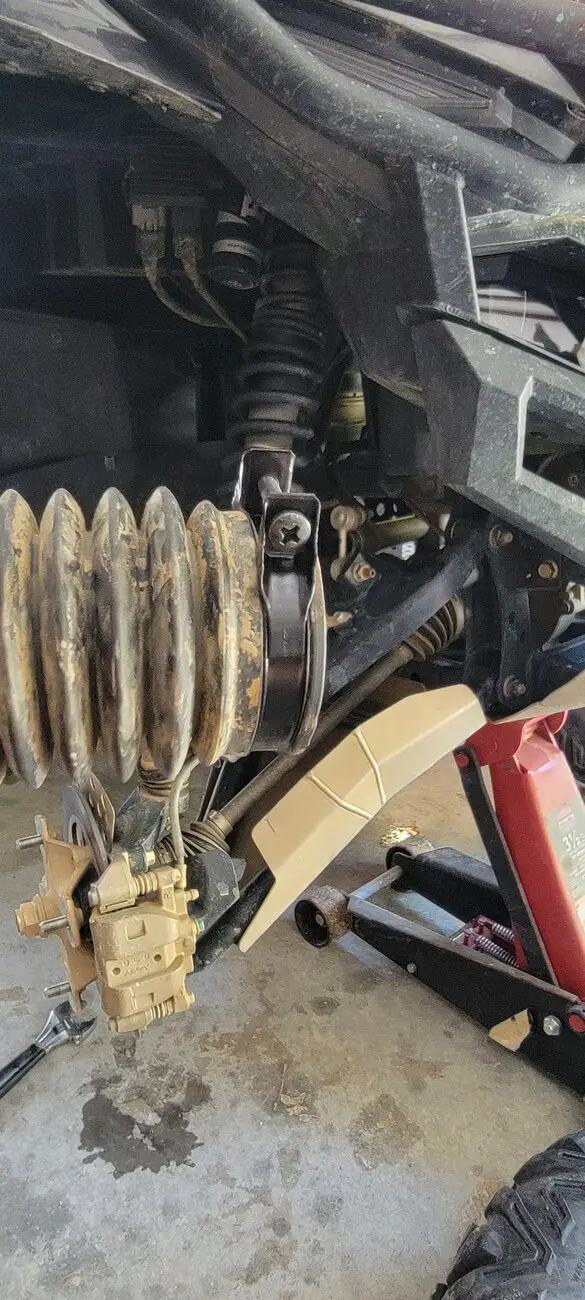

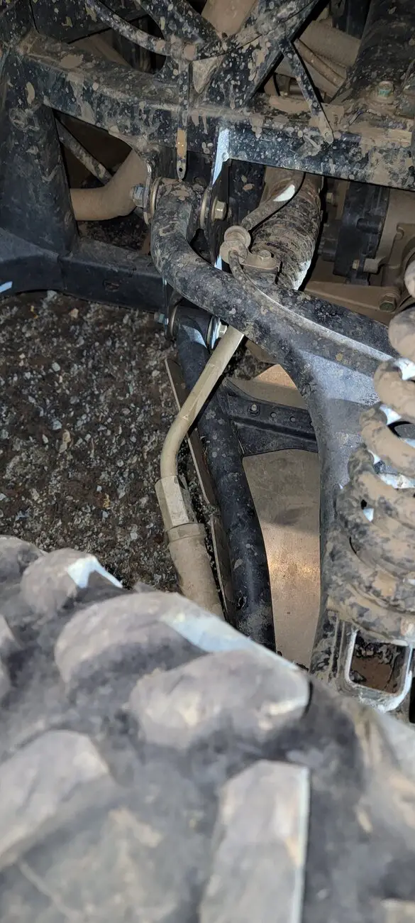

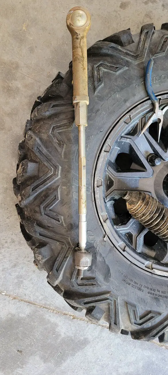

So after 4000 miles I finally bent my first tie-rod on the RMAX while guiding a group down that gravel road in Tackett Creek known as No Business Hollow.
20230922 200438
We use 2 machines and winches to pull it back enough to finish the last 45 miles of the day.
Took it apart this am and pressed it straight enough until the new ones arrive.
20230923 122328

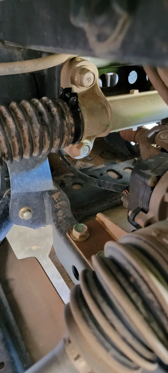

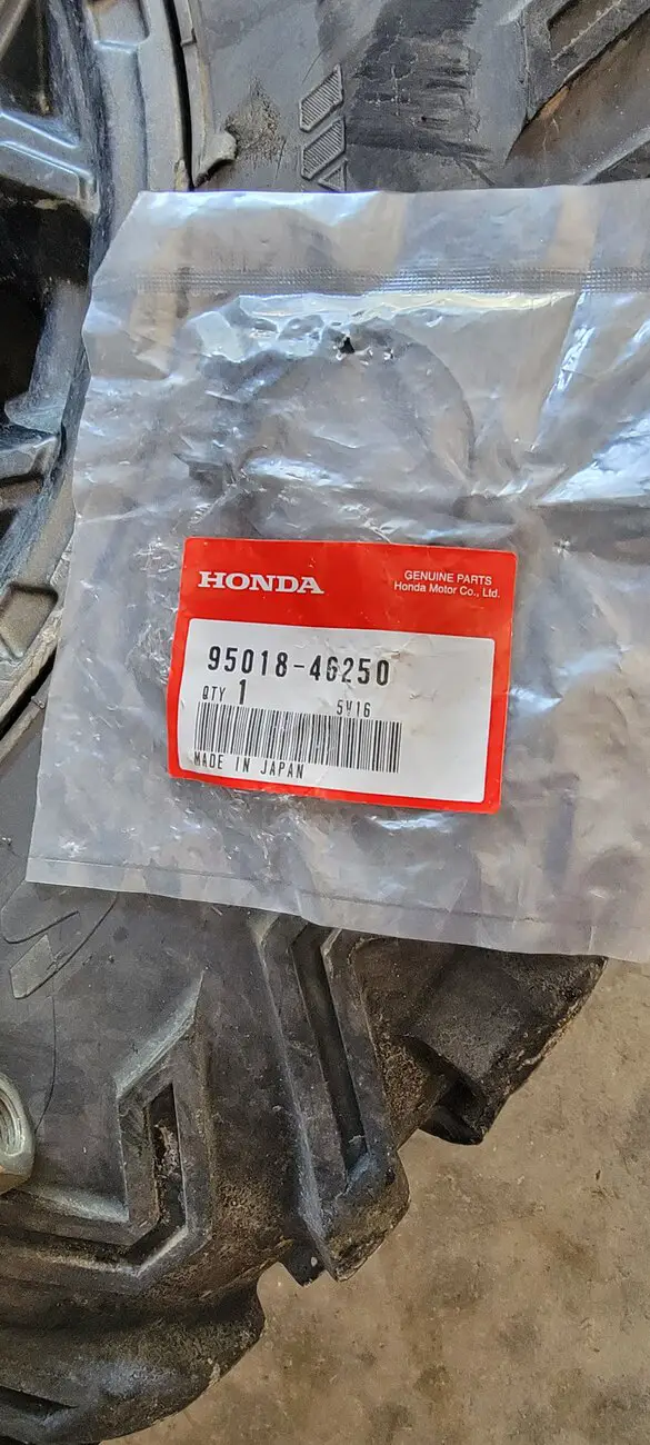

Turns out @lee advice for field replacement of the tie-rod boot clamp on the rack end off an old ATC 110 fitted the RMAX perfectly. I just increased my reliability by 1000%

If you haven't had to replace a tie-rod on your Pioneer yet this is a very helpful thread.....
34,756
202,592
So are you sayin, the Ole Coot can drive a little recklessly? Did you do the 1,500 mile service on the belt?
Ancient Honda fanboi / RMAX traitor
37,974
254,502
No I'm saying some of the "gravel" in my gravel road riding is 24" in diameter and don't move fer chit when you aren't paying attention.
Wait a minuet, you used one of our secret Honda hot tips on a Yamaflaw?
That's it, time to change the secret hand shake.
