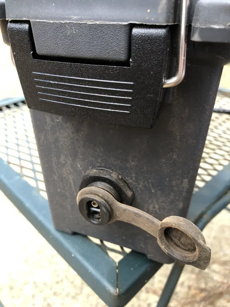

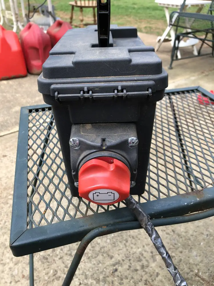

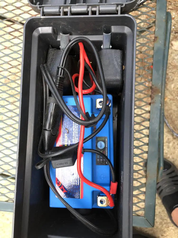

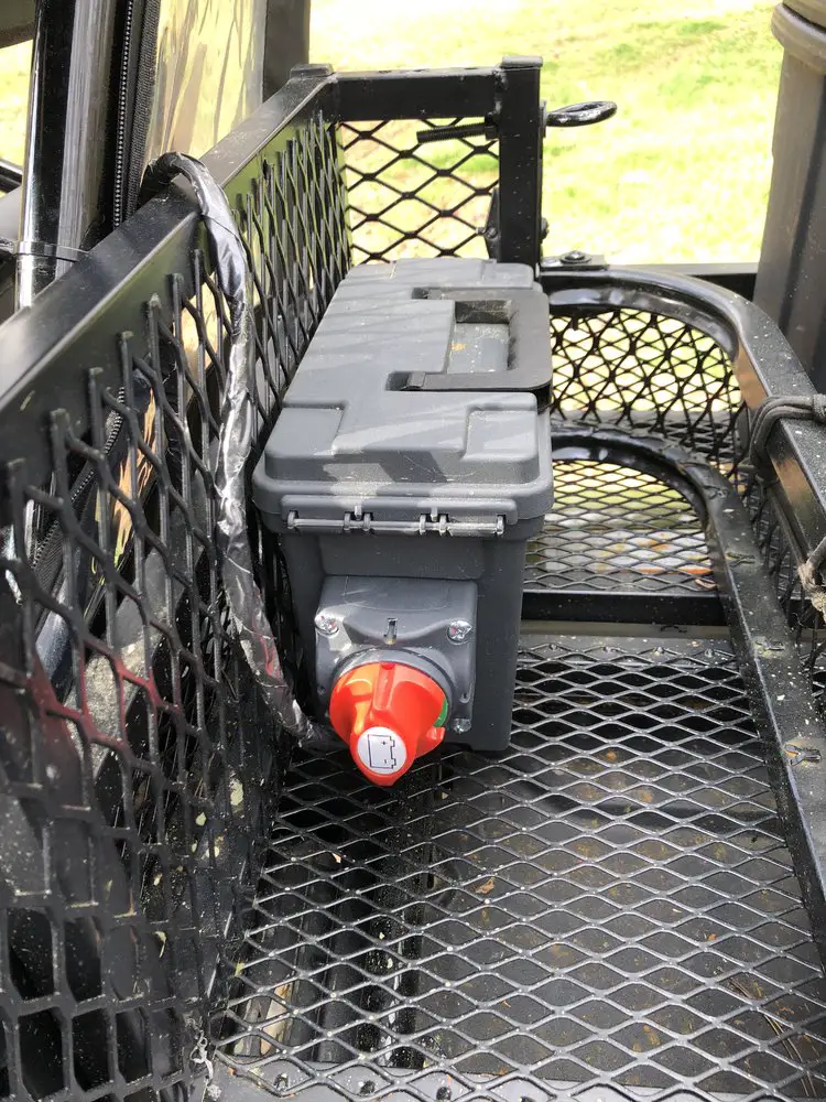

I have a second battery for my radio and light bars and winch. It’s in a ammo box and I have a dash mount charging plug on one side and a marine cut off switch on the other side. It’s not a deep cycle(wish I would have thought about that) but it works great. I leave my Honda battery for cranking. Works great

View attachment 70726 View attachment 70726I have a second battery for my radio and light bars and winch. It’s in a ammo box and I have a dash mount charging plug on one side and a marine cut off switch on the other side. It’s not a deep cycle(wish I would have thought about that) but it works great. I leave my Honda battery for cranking. Works great
Could you please take a picture of inside on the box? I would like to see how it's wired.

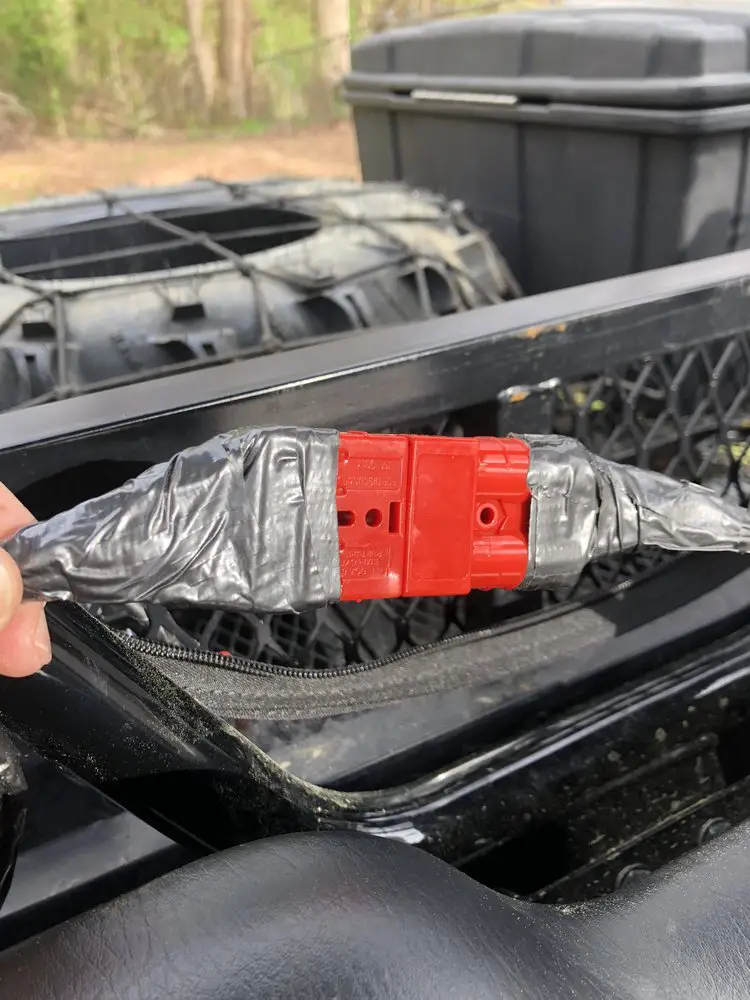

4CF3C726 2AAB 489F 95B1 9FC878F6314BF29F31B2 6E72 421D A6FB F58C9BF2371D 1CDF2049 4AD0 4392 83DF F5D1A9E6C13C 13B9DF29 4C0B 4F46 8D08 5AACA6F007BE QUOTE="solrus, post: 274913, member: 2687"]Could you please take a picture of inside on the box? I would like to see how it's wired.[/QUOTE]I run the power to a fuse box and bus bar under my roof.

my rocker switches light up so i put the marine cut off switch on to be able to cut the power off to everything when not in use.... if i would have hard wired it the rocker switches would light up all the time
