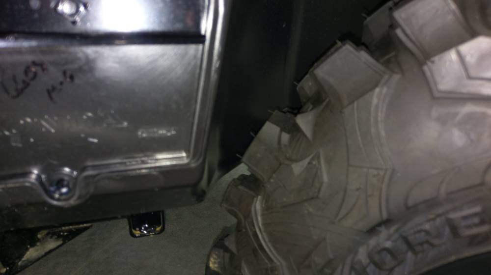

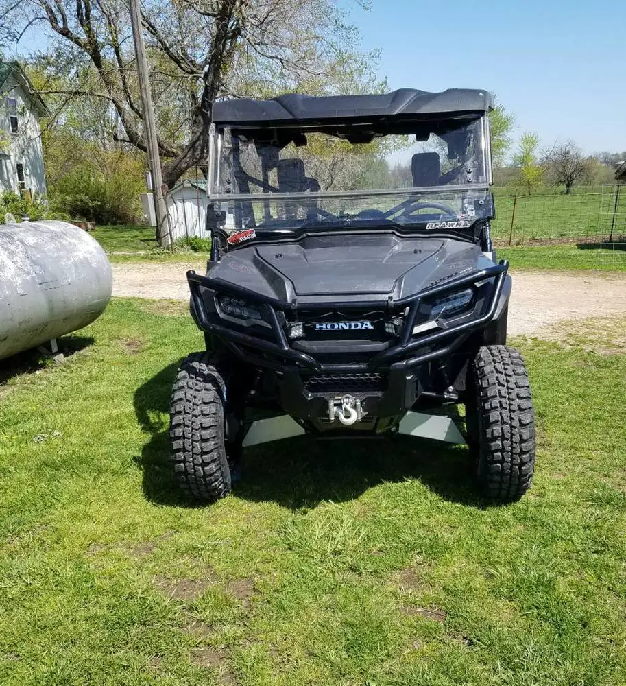

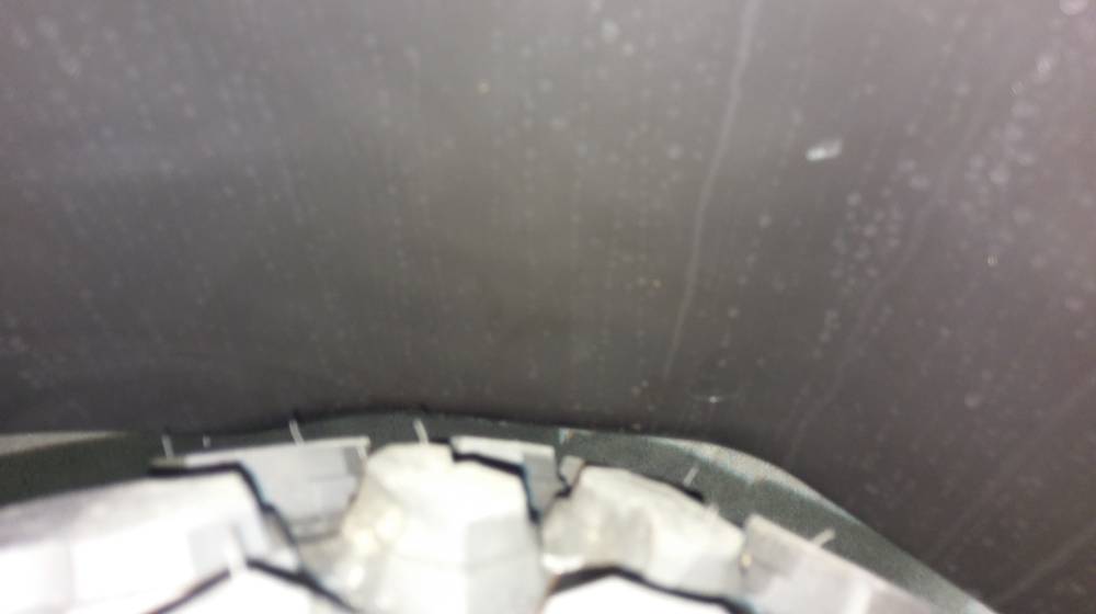

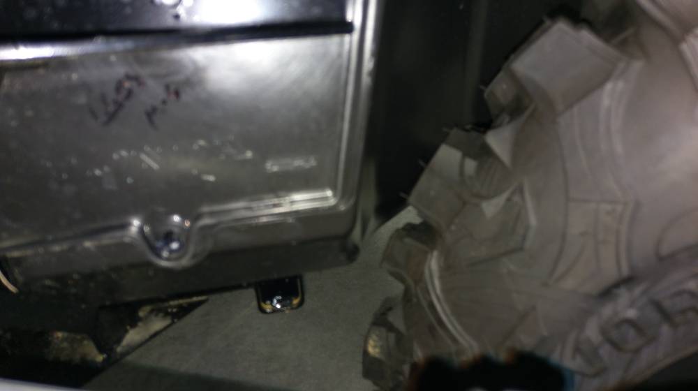

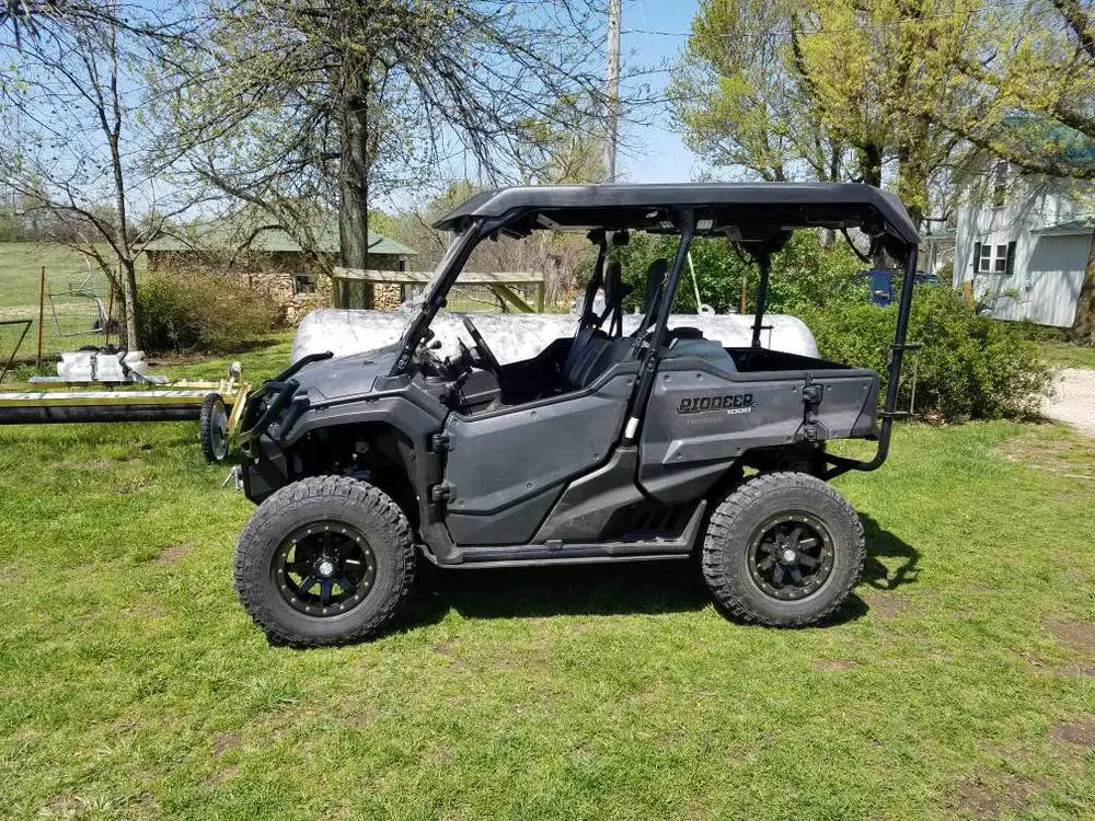

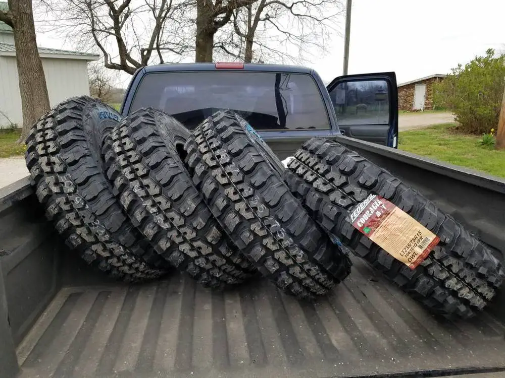

Im running 235-75r -15 lt on 5x2 sti no lift 1" rear spacer some say they will rub but so far no problems .It's close some I'll put arms on View attachment 78104View attachment 78105View attachment 78106View attachment 78107
Nice.. translates to a 30x9.5
But how you not rubbing with that skid plate?
You trim it up?
I have 28 roctanes and i cant fit my hand between the tire and wheel well at full compression.
So no modifications at all on the front?

Mine are 28.5 x 9 and it's close had to trim trail armor skid plate and put one screw in finder flare to pull it back .math says 28.8 x 9.25 but there not

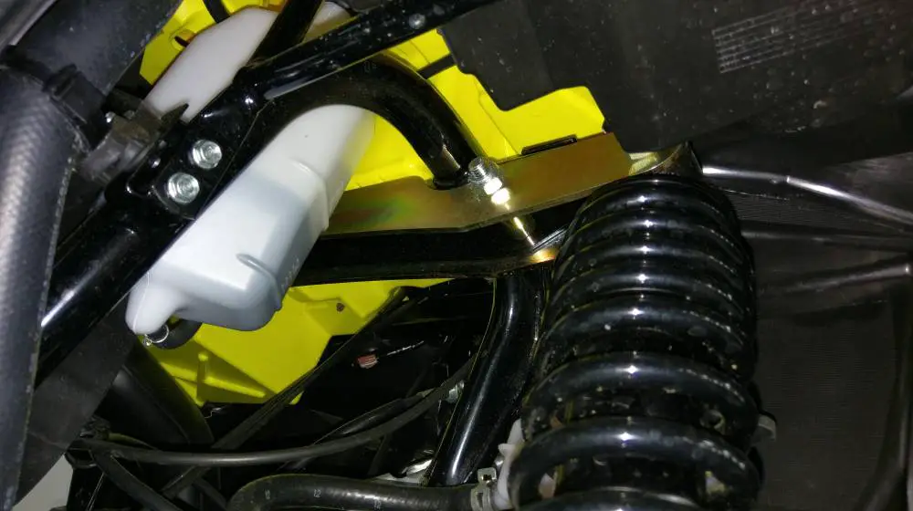

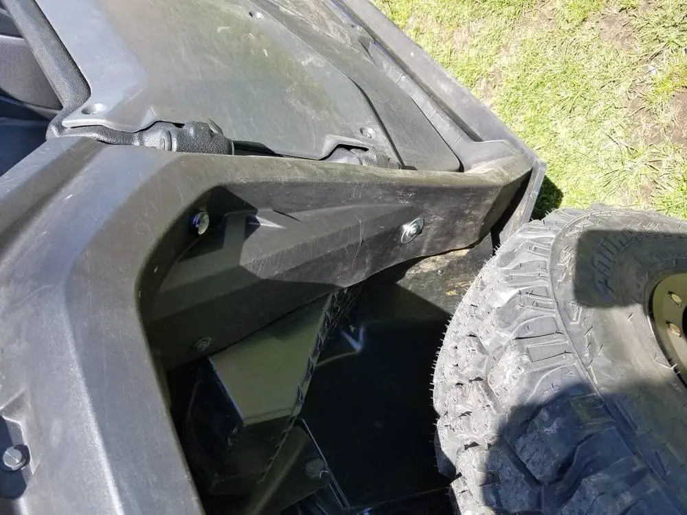

One screw in finder flare to hold back 058e0d71d9ed241ee04f8a61b69357b9

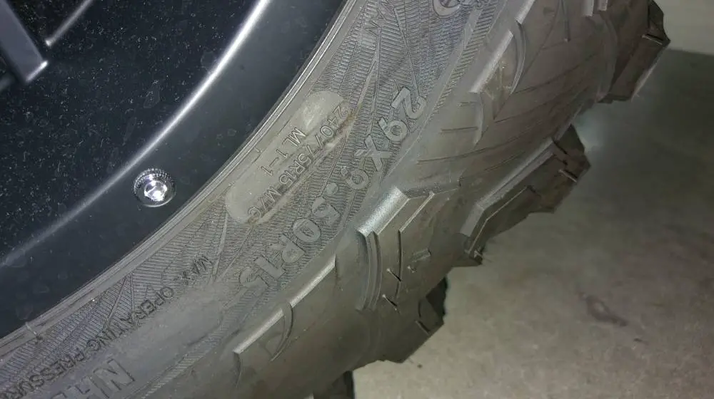

Here is about as close to a exact example as your going to get. Still think its a NO on 30's.
29x9.5x15. Lift kit. Itp Hurcansl wheels. Not sure of offset. No spacers.
I think this will rub at full compression and hard turns. I cant fit hand between the tire and wheel well.
View attachment 78141View attachment 78142View attachment 78143View attachment 78144View attachment 78145View attachment 78146View attachment 78147

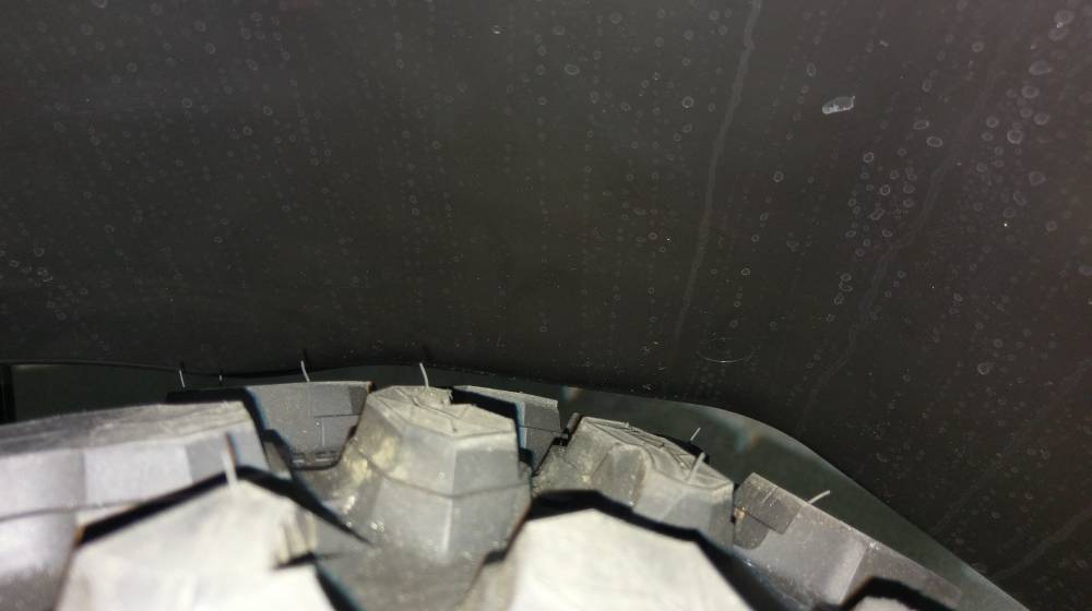

Is there much behind the plastic in the wheel wells on our machines? Cutting or modifying help at all?
