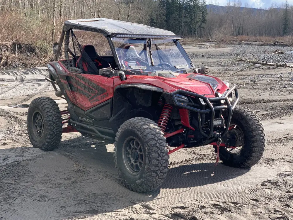

I went with Method wheels and 32” Kanari Terramasters. 31” tall at 12 psi. We went for a 50 mile ride Sunday . Everything from hard pack and rocks to sandy loamy areas and some light mud. They seemed to do great. You can feel the difference in the larger tire. Rolls over ruts that would suck the 28”s in. The extra clearance is nice too. I didn’t really notice any power difference on the trails. There was some loss on the top end on our pavement portion to and from the trails.

I went with Method wheels and 32” Kanari Terramasters. 31” tall at 12 psi. We went for a 50 mile ride Sunday . Everything from hard pack and rocks to sandy loamy areas and some light mud. They seemed to do great. You can feel the difference in the larger tire. Rolls over ruts that would suck the 28”s in. The extra clearance is nice too. I didn’t really notice any power difference on the trails. There was some loss on the top end on our pavement portion to and from the trails. View attachment 185139
I really like those wheels. I almost bought a set of them. Light weight, inexpensive and very stylish. I ended up going with Alba bead locks instead, but still love those Method 409s.
Thanks, I looked at the ITP as well. The ultracross I think it was that a friend has on his machine. A lightweight package was my goal. I looked hard at the Carnivores for the weight and aggressive tread and decided to go with the Kanati 10 ply tire for the additional sidewall strength and contact patch to ground profile. We ride in sharp rocky glacial till material in the PNW the Carnivores would do well in but the sidewall is their weak point.

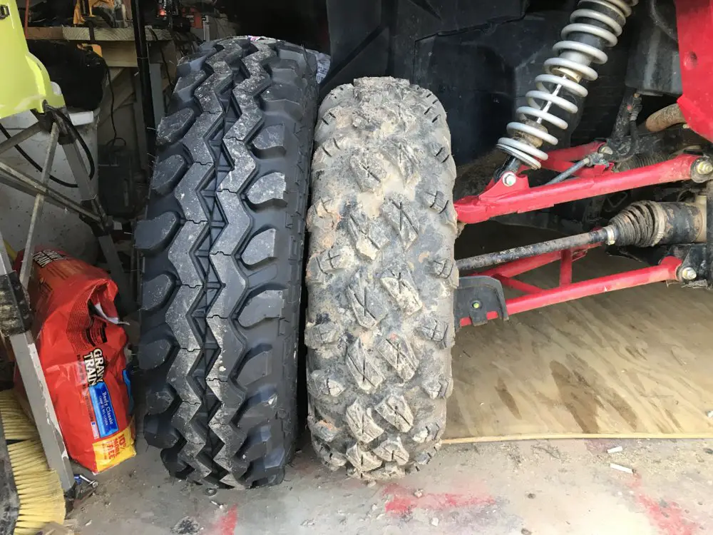

So I have three rides on my new BFG KM3 (ATV not DOT) 32x10x15. I had been running Terrabites (Kevlar Aramid) 30x10x15. I had problems with my terrabites holding air on bead locks, moved them to my stock rims, then had a tire problem on the trails that I couldn't plug. My thoughts on 32", the look great, they handle well and ride well(at 10 psi, less and the rear seems to bulge too much.. They have more road noise than the tusks.
I think they at 32" are too big though, here's why: the machine used to shift right where I would shift. Now, I end up using the paddle shift because it isn't shifting early enough. Speedo is off by 5 mph, and I have to multiply 1.124 x the odometer to get the actual mileage for the trip. When slowing, it doesn't seem like the brakes are as effective. The RPM doesn't drop where it used to and now I end up braking more, where before the rpm would drop as I got to that say last 5-10 mph to slowly crawl. Has to get to less than 3 mph for idle to drop, so I'm on the brakes until it does. I might be getting better MPG. Where I was getting 15-16, I have gotten 17.6 mpg on the last ride. Your experience may differ.
I wonder if anyone else has experienced these things?

I did get a short ride yesterday after mounting the 31 TSL’s on mine. Because of my “youthful” haste I forgot to set the tire pressure, and just took off. The actual ride was pretty good. The biggest issue I had was brakes!!!! Stopping distance doubled at least. On another note, when I got back home I washed it and finally remembered to check tire pressure. It was 38lbs in all 4! LOL I lowered to 20 but hadn’t rode again. Shifting was pretty normal, top end speed lowered a bit.
