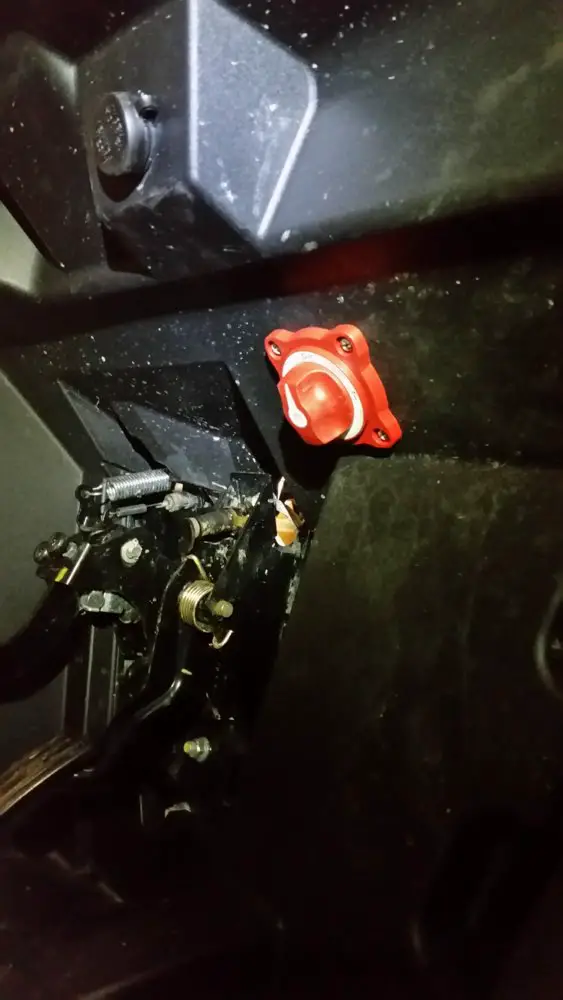

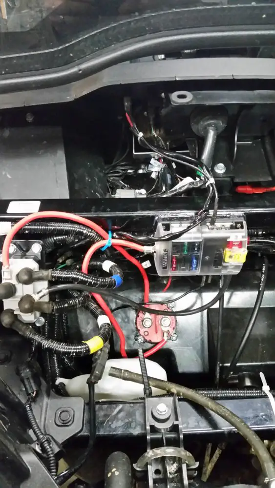

I have everything mounted and hooked up , now all I need to do is add a breaker !!!
This is going to make it so much easier to add accessories.............no more running wires back to the battery !!!
View attachment 12220 View attachment 12221
