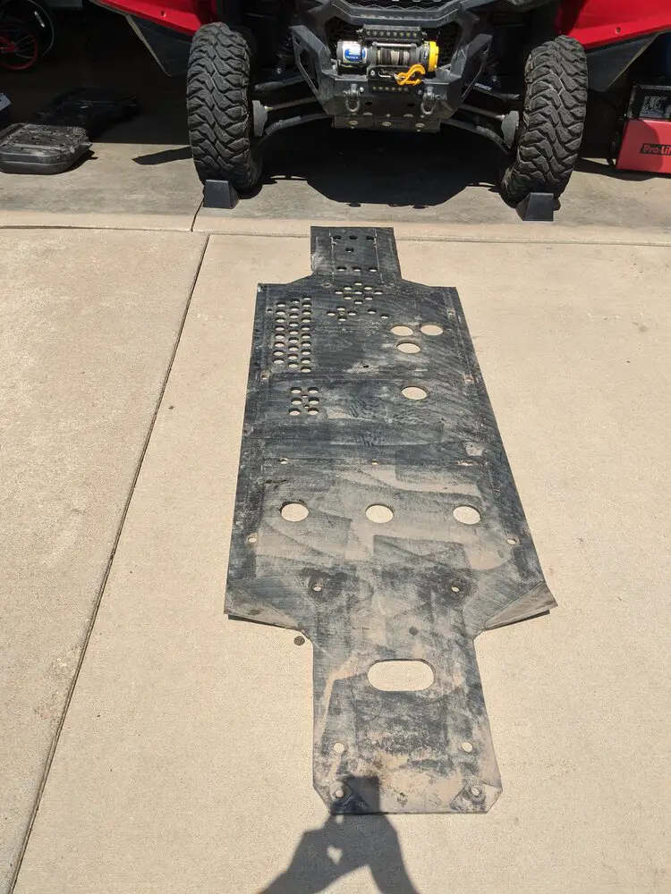

I've got a bunch drilled in mine along the frame rails. Thick mud just stays though.
I use the grain bin virbrators going up the next step hill!

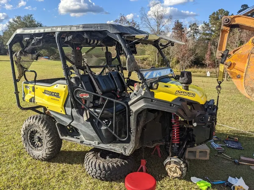

Finally got around to swapping out the worn SATV bushings in my front arms. Every one of them was trash, probably close to 1k miles with the arms on and I probably should have replaced them at 250 miles with how poorly those bushings held up. Feels like a new machine now that I put the RB3 bushings in and everything took grease like it was supposed to.
Why did you buy RB3 bushings vs garage products?
Reactions: JenElio
8,327
63,029
Didn't know about the garage products. I have had the RB3 sitting in the box since before my last Tackett trip, just never got around to installing. I'm planning on picking up a set of the garage products for the rears.
ToddACimer
ToddACimer
Pioneer 1005-2
Oct 7, 2016
3,812
16,232
Oshkosh, Wi
I was trying to decide between the 2. I need to replace my fronts pretty soon and I have a lead on a set of rears. Garage products is currently sold out.
Reactions: JenElio and Isaiah
8,327
63,029
The RB3 bushings are nice. I've never seen or handled the garage products sets to compare, but I've heard nothing but good things. The SATV bushings are junk so you'll be hard pressed to find something worse!
JenElio
JenElio
Oct 31, 2019
82,862
718,210
Loxahatchee, florida
I'm getting ready for these A-arm bushings as well, got quoted $300 for (front and rear) set from garage products vs. $190 from RB3
Don't know how much better GP is but that's a big difference in $
8,327
63,029
As long as you don't use the SATV bushings I don't think you can go wrong.
Ragnar406
Ragnar406
The Great Bald One
Oct 5, 2016
4,460
17,085
Bella Vista, AR
I can not speak to the RB3 bushings but the Garage products are top notch. I replaced both front and back and it literally stopped all the squeaking in my machine. I have the SATV arms and I am one that actually was able to get grease to go into the arms but a set of their bushings never lasted long. Garage Products are lifetime guarantee. if they fail you send it back so the guy can inspect them (cause he wants to find out what he should improve) and he will send you new ones. @GlockMeister is using them too
