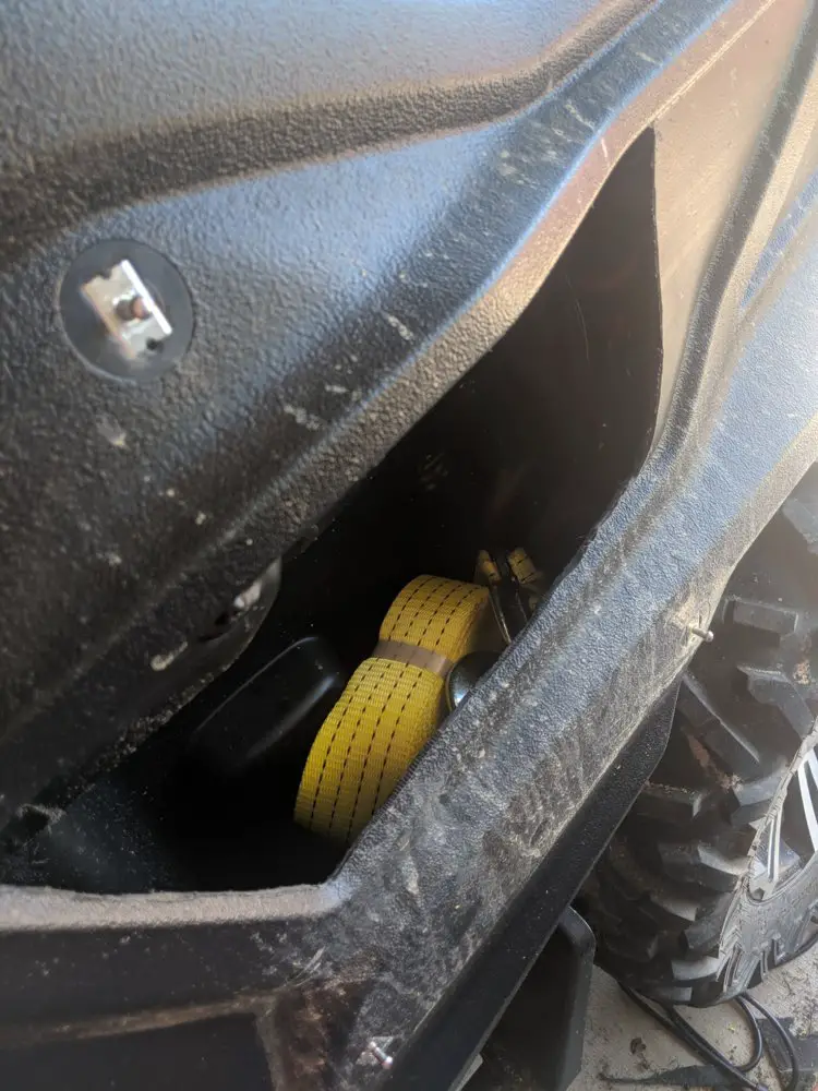

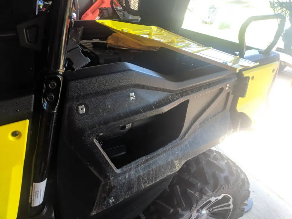

Next up was the rear in-door storage mod. Honda should definitely have utilized this space from the factory. There's a ton of space in these doors! I unscrewed the rear panel and used my Dremel to cut out a hole.
I initially kept all of my recovery gear in the door, but soon realized that if you tip over onto that side you no longer have access to anything in the door. I toss a tow strap in the bed now before I head out just in case.

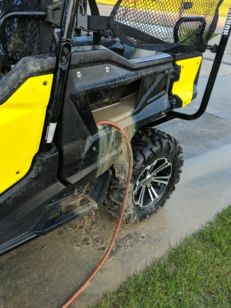

I drilled some more holes in the bottom of the door to aid in getting rid of water/mud after I tipped it over in the mudhole and it damn near filled it to the top with soupy mud. I also learned that I should put my stuff in dry bags.
I used these push-to-release hood pins to secure the panel. The threaded rod screws into the existing inserts in the door. You have to either cut the rods to length or drill out the plastic on the back of the insert in order to screw the rods in far enough.

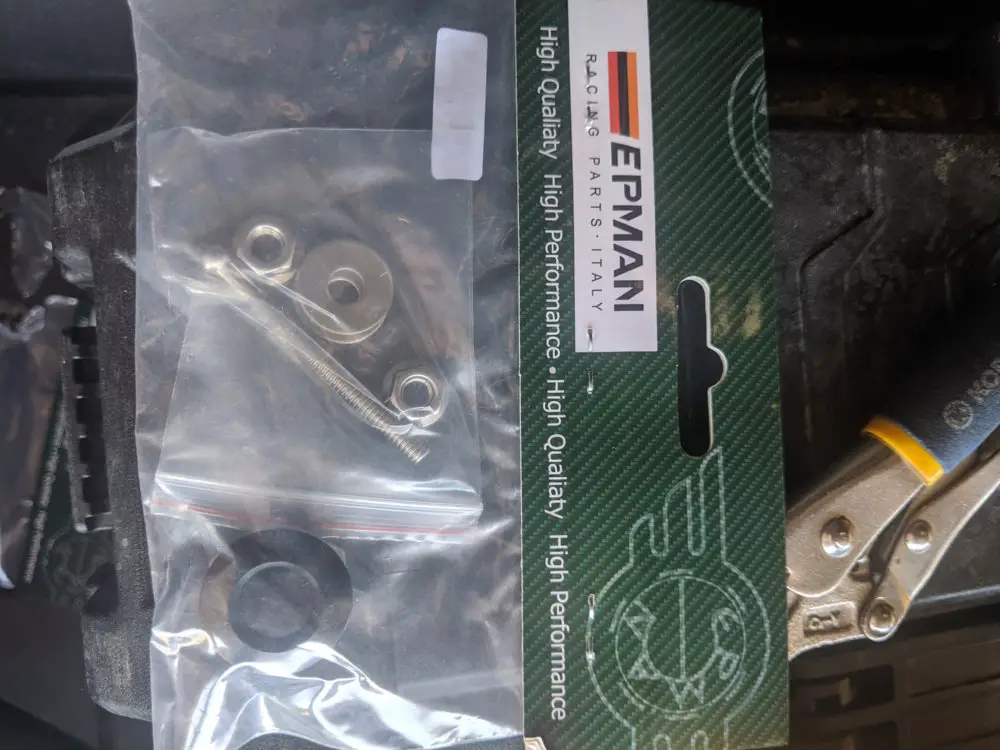

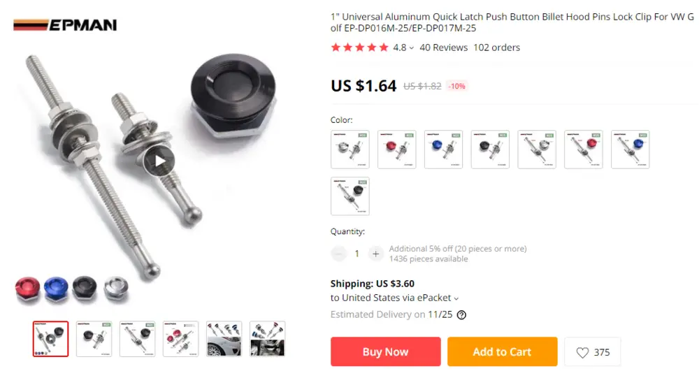

I found the order info in my email:
AliExpress 1" Quick Latch Hood Pins
Upload 2019 10 24 15 5 22

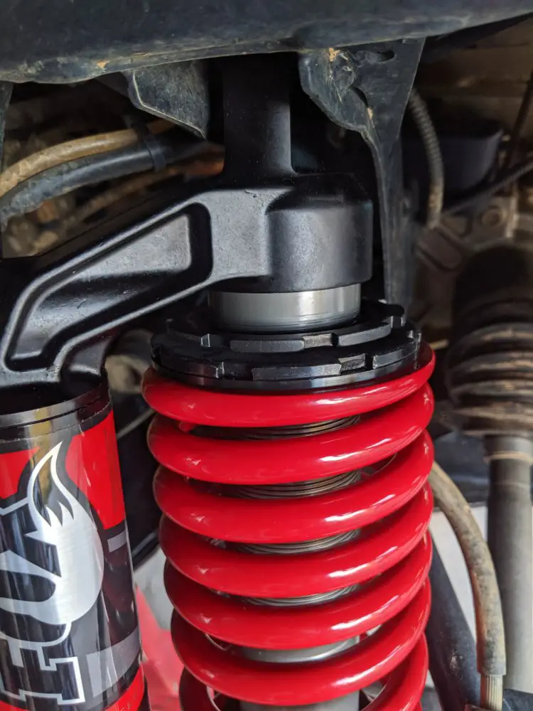

Got them on there. Definitely need to get a spanner to adjust the preload now!
Did You ever find or know of a part # for a spanner wrench to adjust Fox Shock or do You just use channel locks, By the way I have the Super ATV flip out windshield and I Love it works Great, We leave it flipped out mostly with no issues just need to watch for three limbs a little don't want them to hang Your windshield,,,,,,,
I bought a cheap one from the local atv store but never even tried it. It didn't fit well and would have scratched the hell out of it. Going to take them off the machine this weekend and have @joeymt33 give me a hand adding some preload using a hitch vise.
