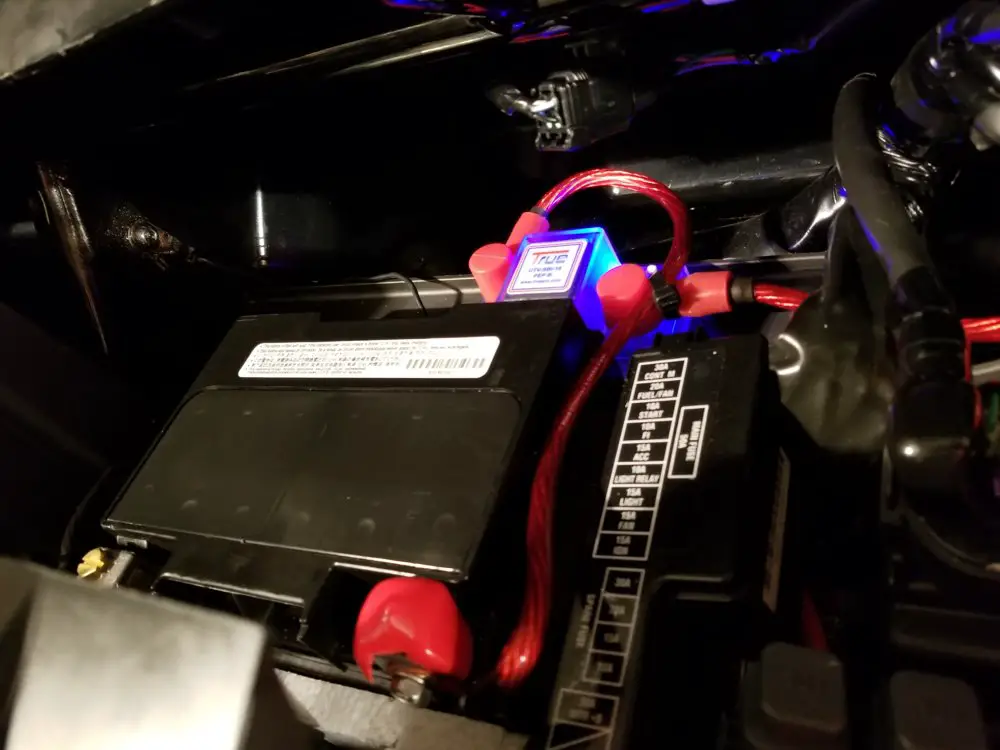

What gauge wire are y’all using between you two batteries and your Stinger and True isolator? Thanks! David
bumperm
bumperm
May 7, 2021
1,931
6,829
Gardnerville, NV
Tru includes 4 AWG (conductor diameter .228") with their kit. I used 2 AWG (.3" diameter) when I was making up my between battery ground cable or when the Tru provided cable wasn't long enough. I also shortened their cables when there was excess, as I mounted the Tru between the batteries the cables were short.
