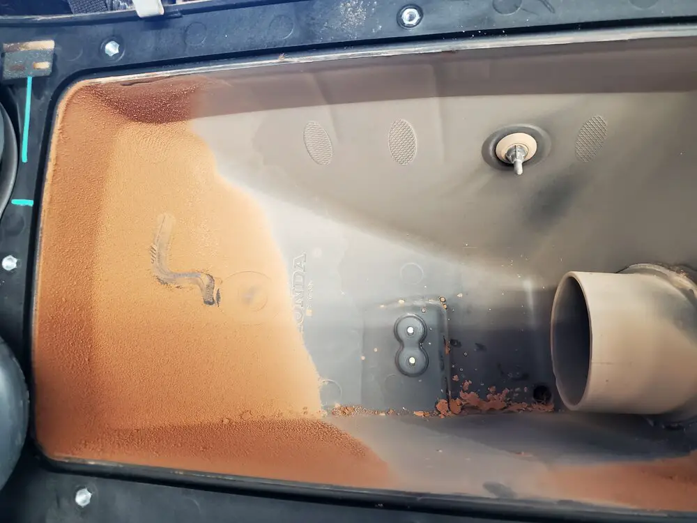

My thoughts are that a pre=filter installed Inside the airbox adds some potential issues.
How do you know that the pre-filter is dirty without opening up fairly often.? Doing so adds the risk of inadvertently leaving a leak in the gasket if not seated perfectly. Why does Honda OEM Filter come with both gasket "o-rings" with each new filter? Is it because of the potential for a less than perfect seal by re-using one that has only 30 to 500 miles on it ? I see it like replacing the crush washer on the drain plugs each time we do an oil change
Below is a photo of my filter with 750 miles of Utah Canyonlands riding before S&B added. I am usually by my self or the leader so I assume this is all self inflicted /generated dust. I will give the S&B 1000 miles and check the filter and inspect for dust on the "clean" side. We have all read the experience of others with engine damage due to only a small amount of dust getting through.
I see it as one of several design flaws on an otherwise great machine. As I am new to the SxS world, still preferring my Quads and Mountain Bike, I'm finding this is a very expensive sport. But I still love my Talon.
View attachment 206823 View attachment 206824 View attachment 206825
Ok, you should have a 1000 miles by now, what's the verdict? 🤔 Pics?
